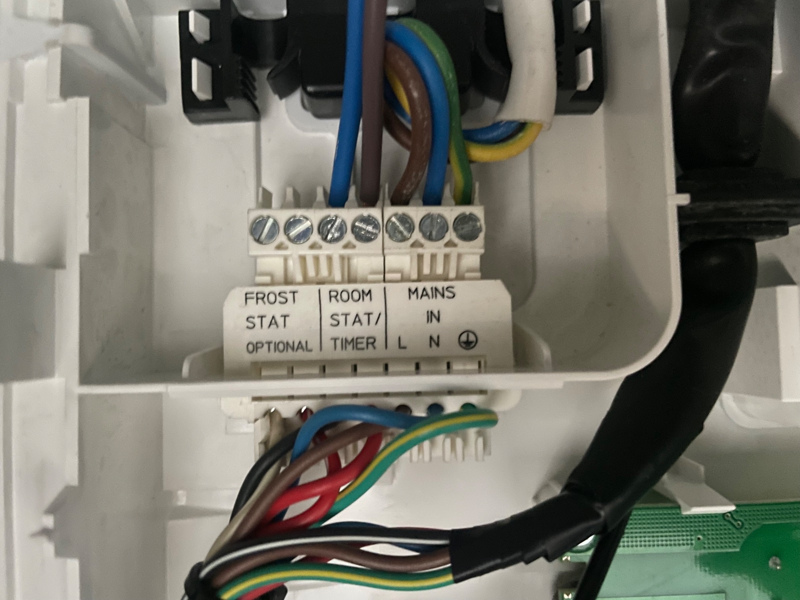

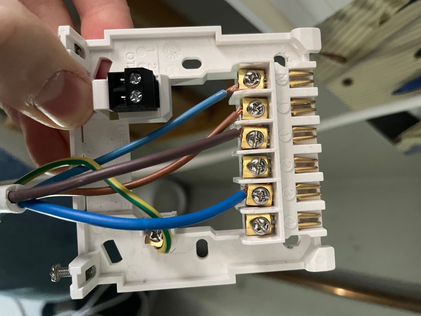

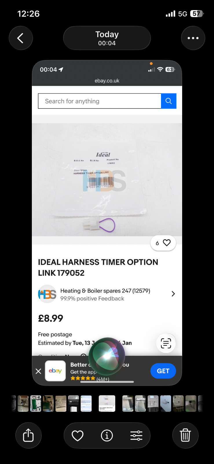

I am really struggling to pair my hive reciever to my boiler (ideal imini c30)
I have power to the reciever from my boilers switched spur. I have then ran a 2 core from reciever terminals 1 and 3 to boiler terminals roomstat/timer. I have tried linking together red and purple from original rf ideal reciever but this just keeps heating on constant.
Any ideas? I’m losing the will to live

Unless you can figure out the wires and link them together and then ideally fit a blanking plate

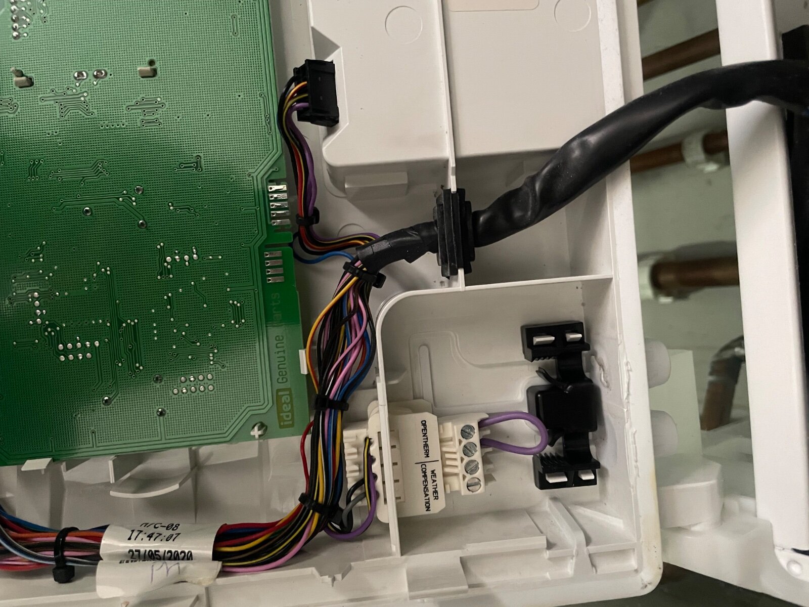

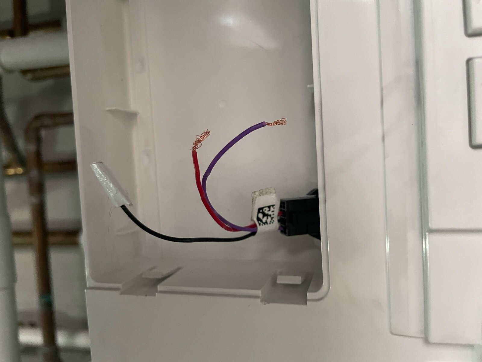

Thanks. I had looked at using them but some forums said you needed an opentherm wiring harness.
Also instead of wiring my receiver back could I use one of these to link it

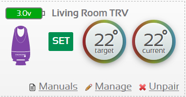

This is only a rough setting, the next is to use what the TRV head tells you, TRV_report.jpg in my case using Energenie heads, but most electronic TRV heads show current and target, not all, the eQ-3 heads only show target, but my Kasa and Wiser heads also show current and target, and if the current exceeds the target while the room is heating up, the lock-shield valve needs closing a bit.

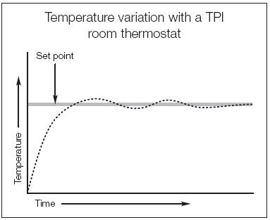

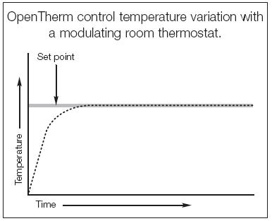

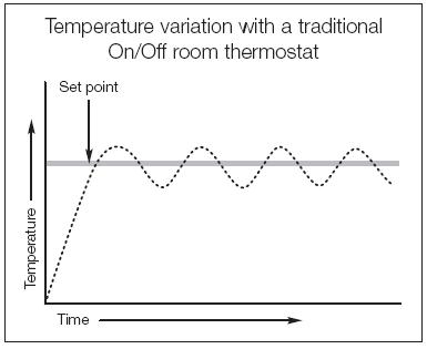

The other change is the TRV can actually call for heat, I think it's called a demand for heat with Hive, and cause the boiler to fire up, the question is if electronic TRV heads are fitted and the lock shield valves set spot on, does it still need OpenTherm? It is very easy to compare a poorly set up home with an old on/off boiler with a home set up A1 with a condensing boiler, but not seen a study where a system which was spot on to start with, is compared with same system plus OpenTherm. We are shown the graphs. Temp_variation_on_off.jpgTemp_variation_TPI.jpgTemp_variation_OpenTherm.jpg which claim to show how OpenTherm removes the hysteresis, but I set up mother's house using just electronic TRV heads, and except when the sun in the bay window caused the temperature to rise, setting the TRV to 22°C and the room stayed at 22°C, +/- 0.5°C I think that's close enough?

I’m going to now try the open therm terminals
Don't bother, even if it can be made to work it will acheive nothing.
Theoretically it could adjust the flame modulation based on heating demand and might perhaps save 2% on your fuel bill if it was all set up 100% properly and correct and the devices are 100% compatible with each other and all other possible energy savings choices have already been made.
