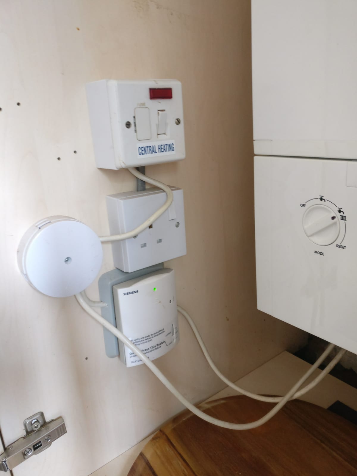

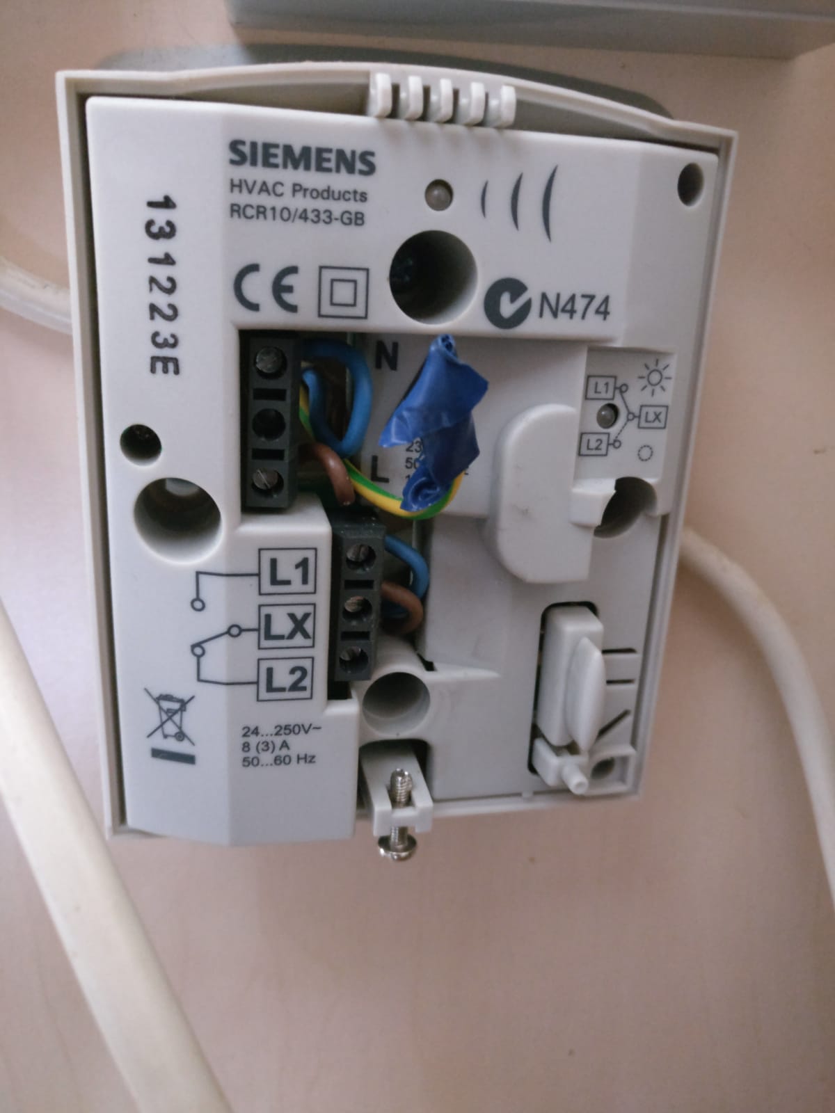

Hi all,
spent a week or so reading other posts to see if anyone has a similar set up but not had much luck. I've attached a picture of my current receiver wiring config (Siemens) along with the supply of power but not seeing anyone with a similar wiring setup. Hoping someone can advise what needs to go where.
Have a Hive single channel receiver ready to be installed, so any advise would be greatly appreciated.

Hi, thanks for the response. Will not having anything in 2 (Heating Off) cause any issues?
No it won't, see links added to my original reply for examples of the same setup as yours
Thanks, seems I need to work on my google-ing skills too!
Will give this a go later on and report back, thanks, muggles.
Hi, installed as you suggested and working great.
Just need to figure out how to remove my old hiv thermostat and reciver from the app !
Cheers, muggles
