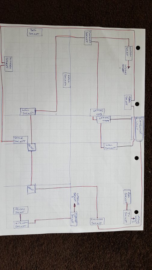

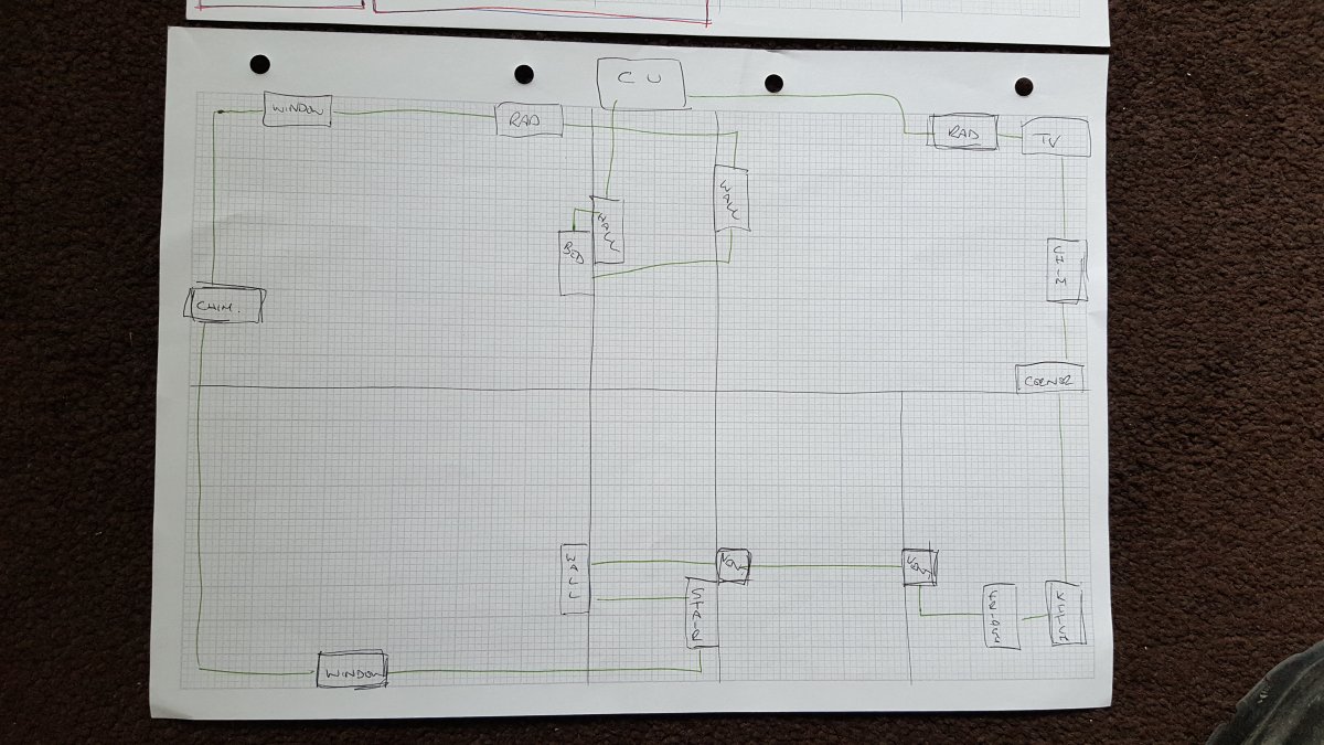

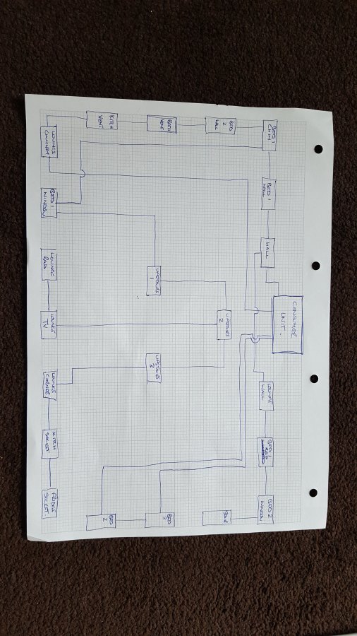

We are renovating our house and the wiring seems to be a total mess, probably done in part by the previous owner.
In order to help the electrician/keep costs down, I have traced out the excuse for a ring main (loads of spurs) and am going to run new 2.5mm T&E to the sockets so it is all ready to be connected by the spark.
Can you have a look at my rough circuit plans, current and proposed, and let me know if it is ok, as I'm a bit worried that I'll be over the max cable length.
The floor plan is less than 100m2, but with 2.6m ceiling height and cables running both through the attic down to sockets as well as under floor, will it be better to split the ring into 2?
Note: sockets are named by their position.
Blue and red sketches are current layout, green is proposed.
Cheers, Chris.

At a first glance your drawing shows some glaring errors:
Spurs from spurs
At least one figure of 8 layout.

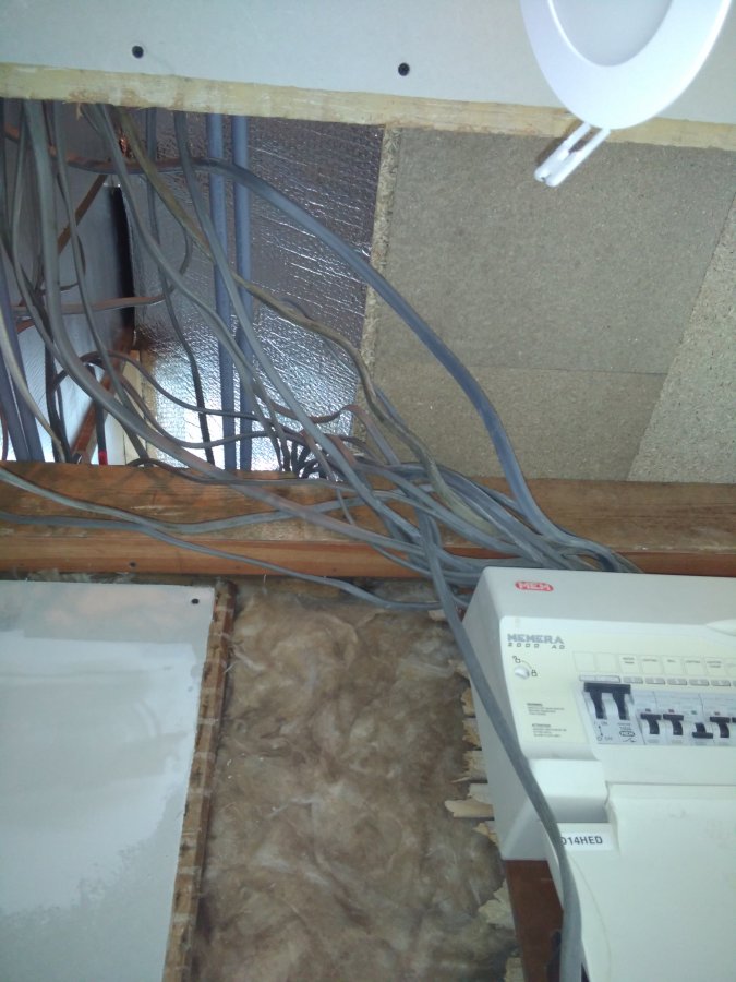

Exactly, the previous owner has added bits and removed bits, so it's all a mess. I want to get as much done before the electrician starts so I'm not paying for him to spend a whole day crawling about tracing circuits and installing cable on top of the day or two installing a new CU.
As you can see the state of the wiring leaves a lot ti be desired.

ban-all-sheds, new CU as the RCD in the current one doesn't work, and as it's an obsolete MEM board, the replacement RCD and adaptor to fit cost more than a new board.

My main concern is making the circuit safer than it is now, but I wanted to make sure that if I made the sockets in my diagram into one ring, would the cable length be too long?
I will probably get the spark to create a separate ring for the kitchen, as there's all sorts of random circuits feeding different parts of the house. The previous owner appears to have had issues, as I have found disconnected cables terminated in connector blocks and just left in the back of live sockets!
Probably not (103m). But if you're having a CU then why even consider having all the sockets on one circuit?
A ring may not be the most appropriate design.
They are not compulsory, other circuit arrangements are available.
