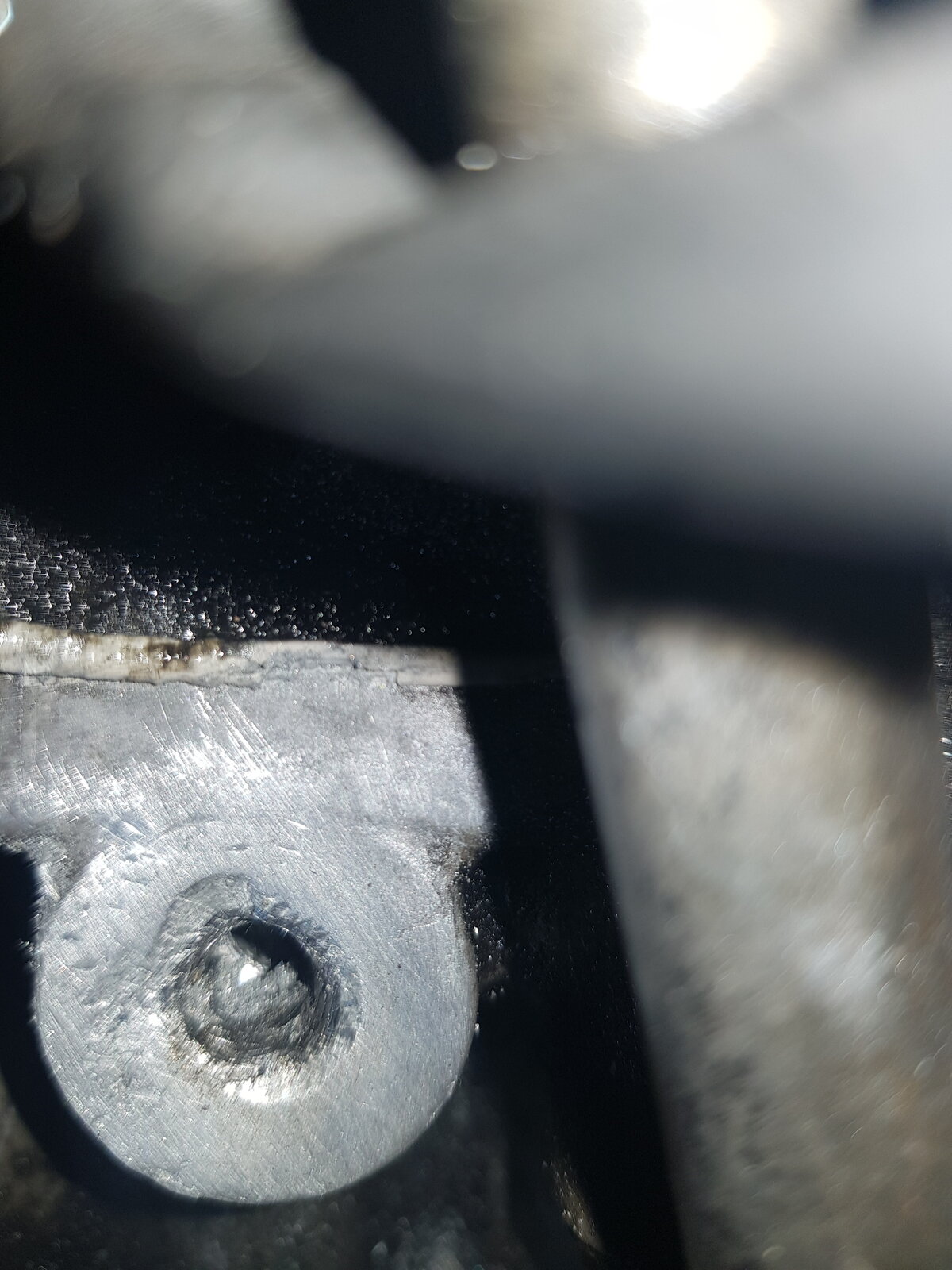

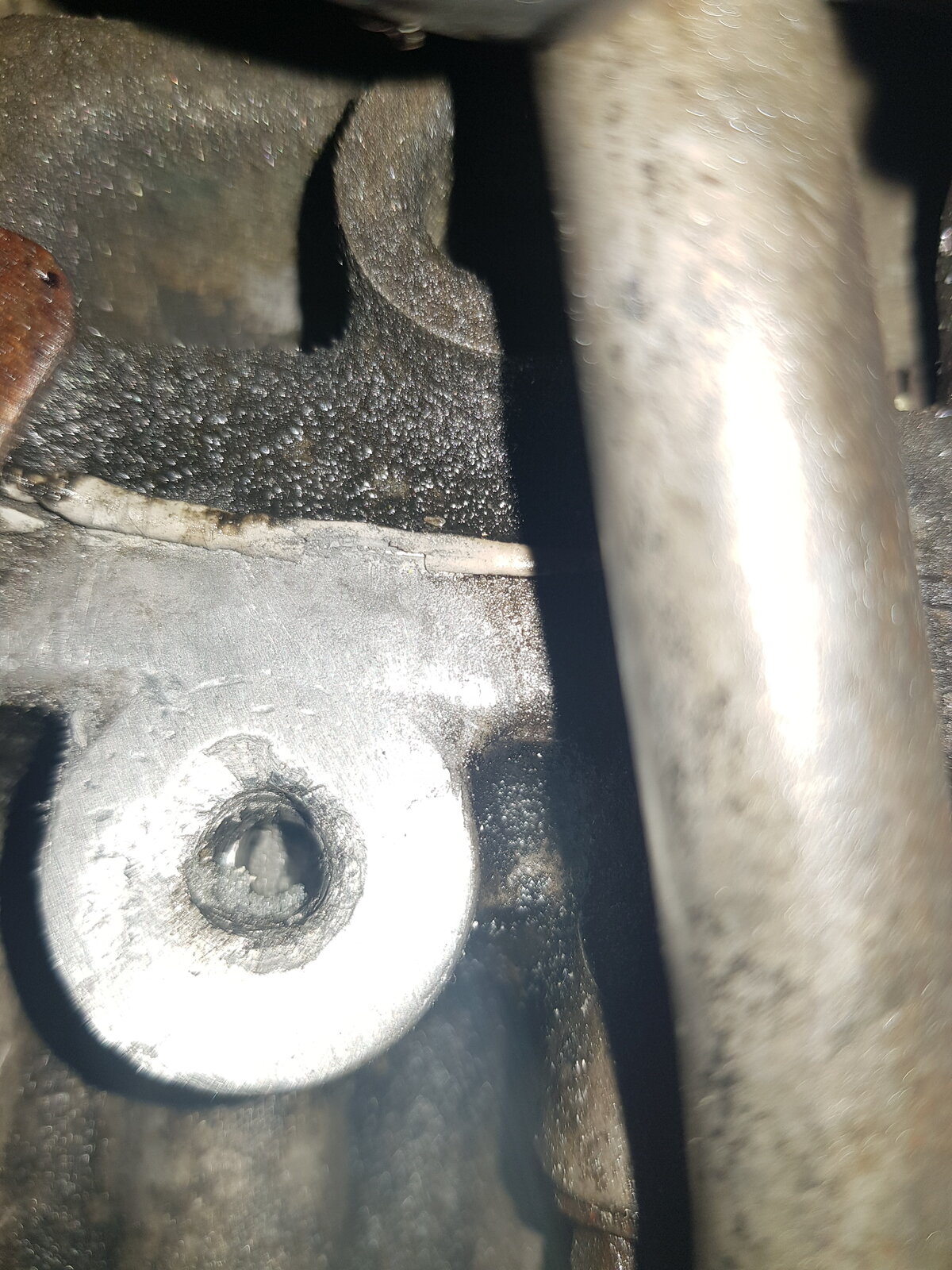

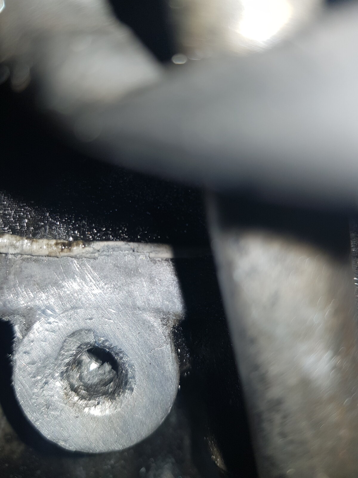

Got extractor, removed radiator to have better access but I have realised the garage has messed around very badly. Not sure if they tried to hammer down instead of using extractor and then told me we put job on hold till Christmas. The 1/4 inch extractor now fit in but not sure if hitting the sensor or the engine block. I have attached photos. Freeze spray and heat still not working but at this point I doubt there is anything left
Photo 1 when left car. Photo 2 after they messed around

I'd go for the extractor, nothing else to try there. However, gentle drilling one step up at a time should break the thread of the sensor and then hopefully it will unwind or at least break up.
I think you are wasting your time with heat now.
I guess you have the replacement sensor to hand- you will be able to gauge how deep things are from that.

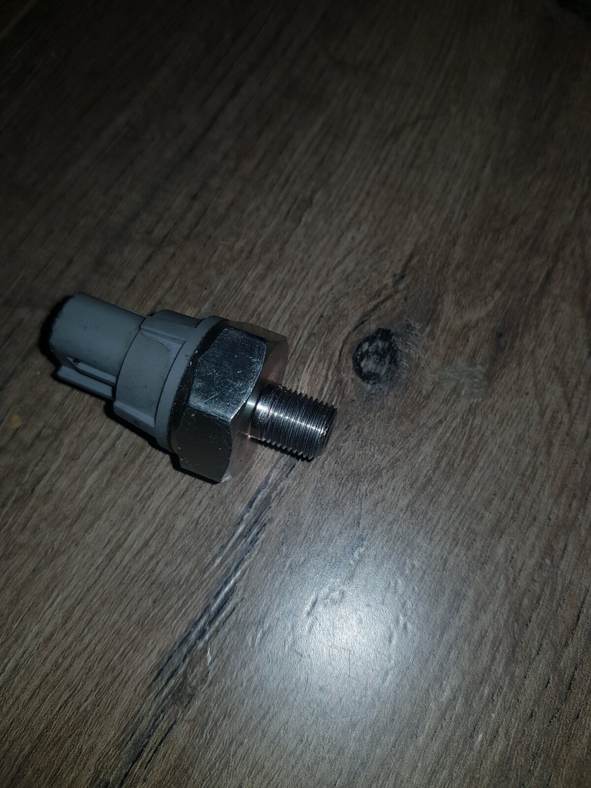

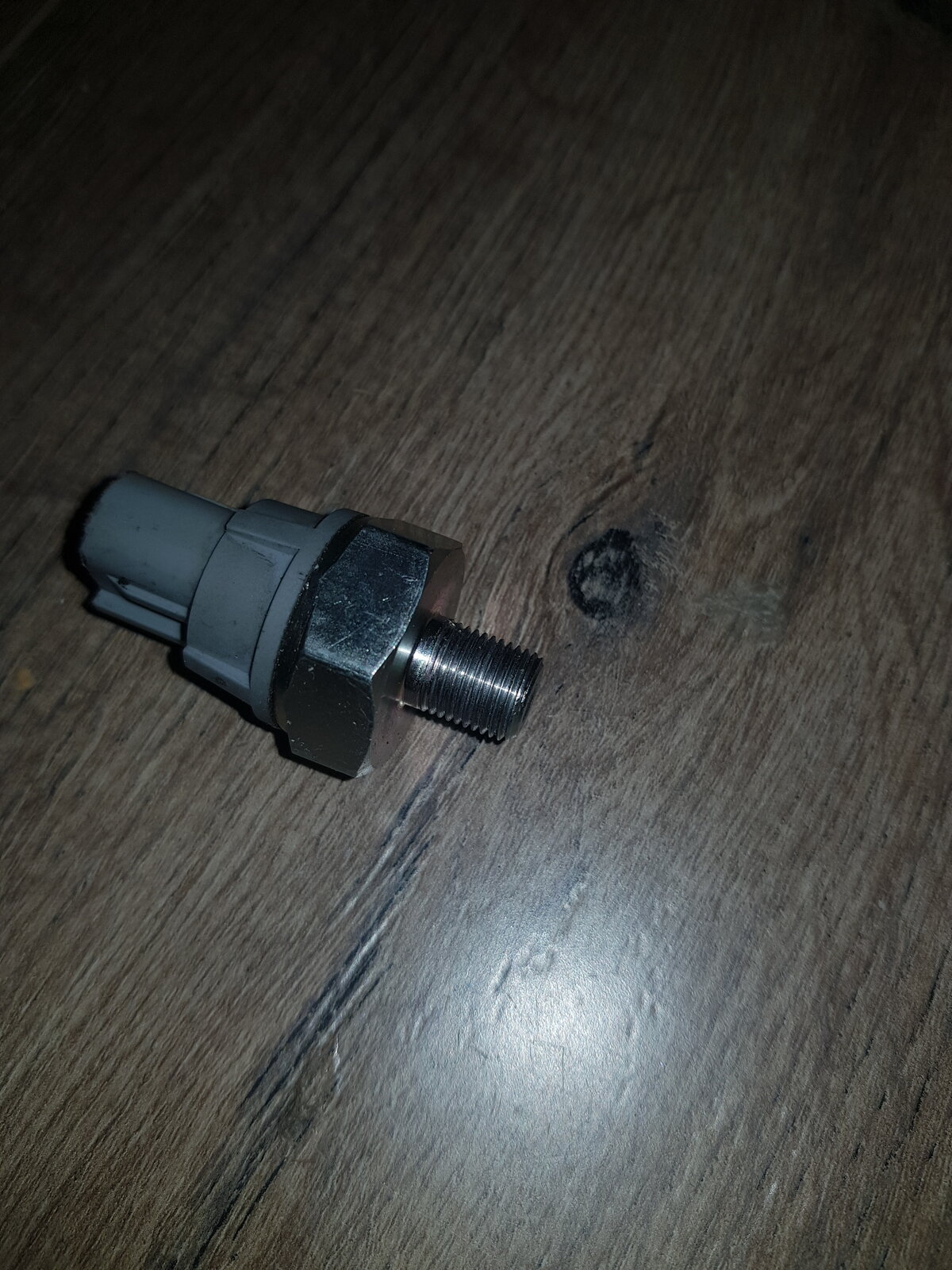

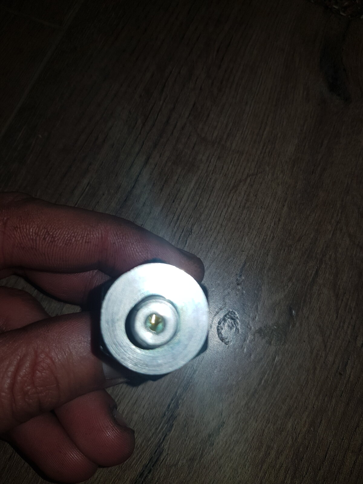

I cannot work out from the photo, whether the shiny wider part is part of the sensor, or the block. Any chance of a photo of the new sensor?
If it is part of the sensor, could you perhaps try knocking the edge around with a screwdriver and a hammer?
You cannot, legally - it would need to go to an a/c specialist to recover the contents. Beg, borrow, or steal - a drill right angle adaptor and used a very short drill bit.

Thanks, it is just the threaded part left in. Time for right angled drill adaptor, a short drill bit, then try an extractor..

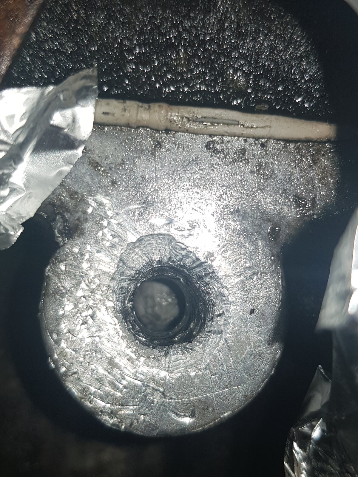

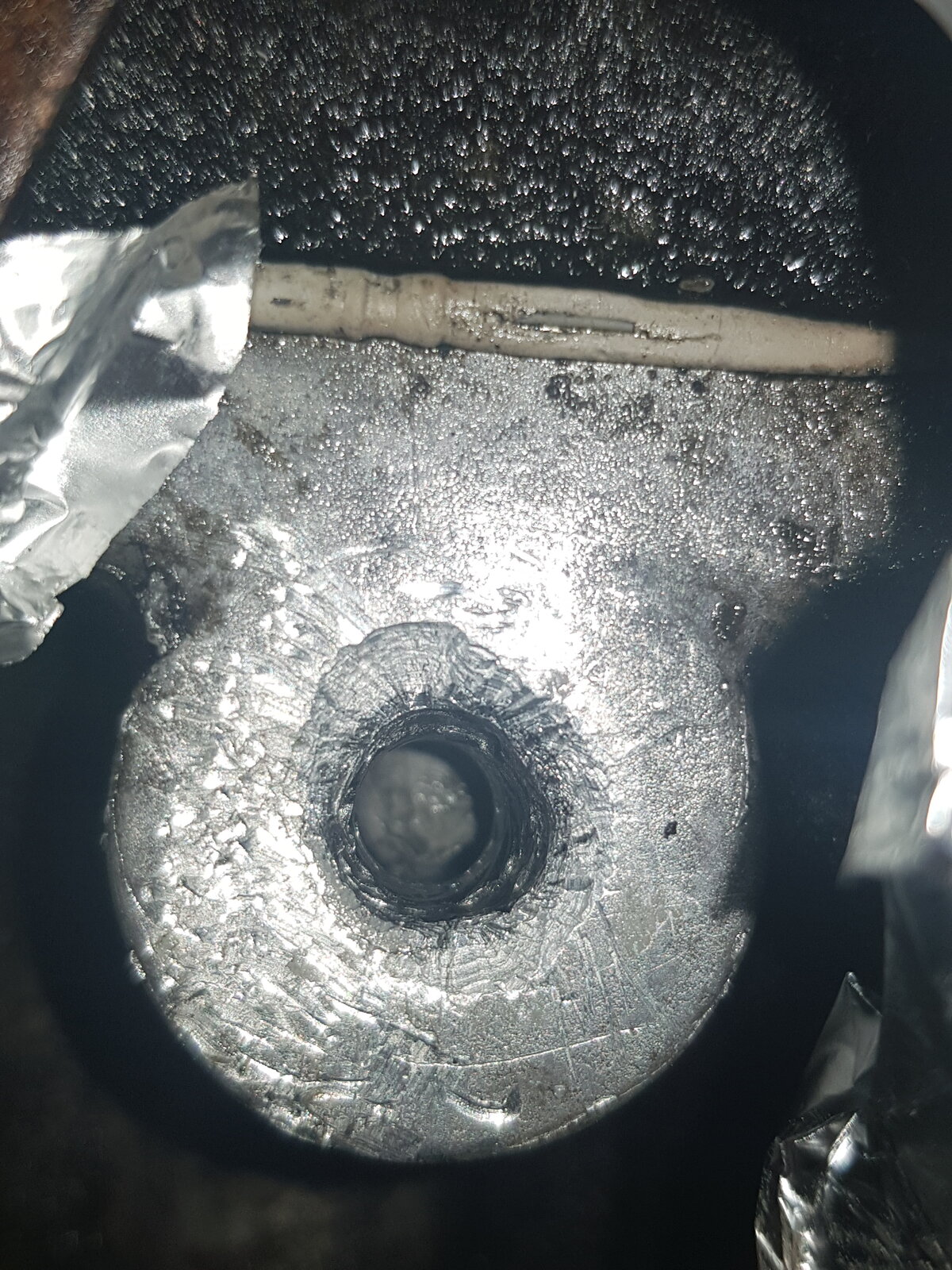

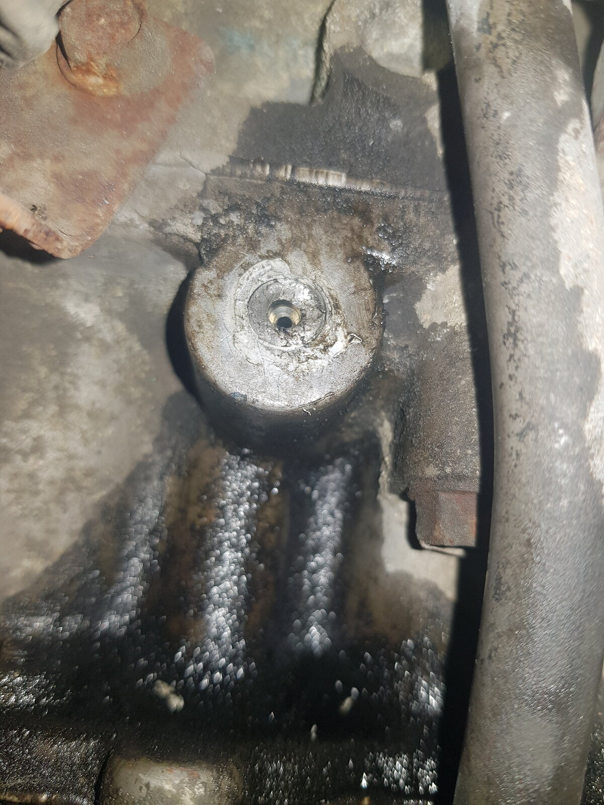

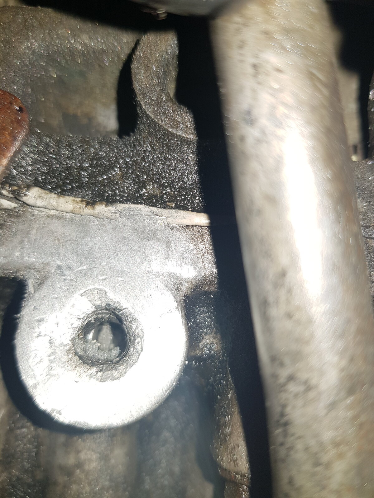

Few more photos after cleaning up with bit of sand paper.
Seems like the extractor is still biting the threaded part.
Tomorrow will try again with extractor. Best option to hit the wrench with small hammer shot or strong steady force?
Didn't get what you mean for right angled drill adapter, short bit and then extractor. If I drill even bigger I guess I would need a tap to make new thread as nothing will be left if I drill into it. Please clarify and will get what needed. Many thanks
You said (I thought) you could not get space the get a drill in? If you have managed it then OK..
The idea is that you just screw the extractor in, turning it anti-clock and that should screw itself in until it jams itself. Once jammed, it should start to unscrew (hopefully) what is left of the sensor. Good luck!
Worst possible result, is to break the extractor in the hole, so if you feel it springing / close to breaking, STOP.
Your next trick is to drill it out completely and tap it, hoping all the bits of metal drop outside the block, rather than in. You would need to get a suitable tap from an engineering supplier to match the thread of the sensor.
If you do break the extractor in, you will not be able to drill it out - it will be engine out and taken an engineer who has access to spark erosion. OR - if it seals itself from oil leakage, you could maybe do without oil pressure warning.
I'd ascertain the thread diameter then drill through with a 2mm smaller bit, that should get you to the state where you can start tapping away what's left of any thread (with a small flat bladed screwdriver) and pulling out the twists with needle nose pliers. If you can't get anything loose you'll have to chance a bigger drill bit, but don't go nearer than 1mm to the actual size. If you end up not managing to get any thread out and your hole ends up 1mm less than the bolt diameter then a tap will cut a bit of a thread - it may not be perfect but if you can gently screw the new sensor fully in then you will be able to successfully seal it with a suitable thread sealant.
If this fails (and you don't have much to lose) then a local engineering shop will be able to helicoil it for you.
Drilling out threads is always a bit hit and miss, it's difficult to drill exactly down the centre and you need to spot that first bit of the crest of the thread becoming exposed.
