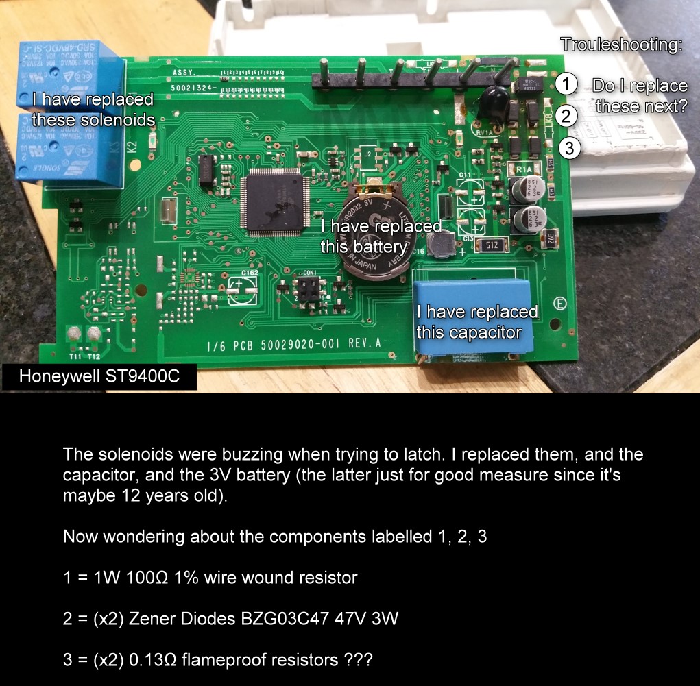

Switched the system back on (restored power at the system isolation switch) and found that the programmer was buzzing and the display going off then on then off then on and so on. Sounded like the relays weren't latching correctly.

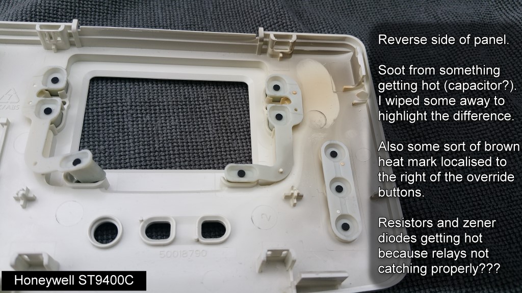

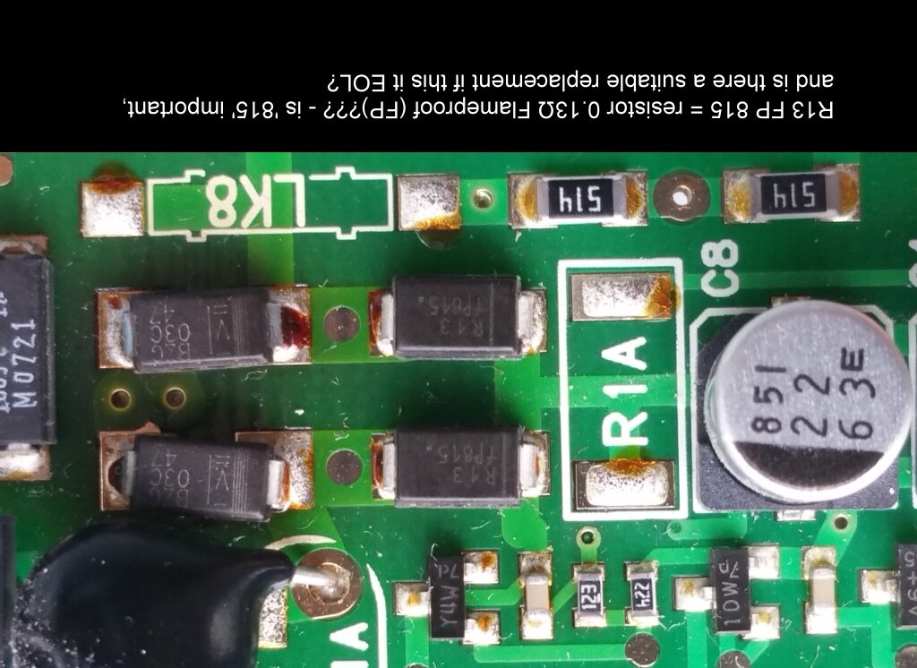

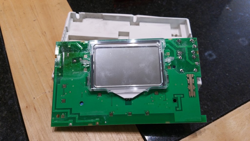

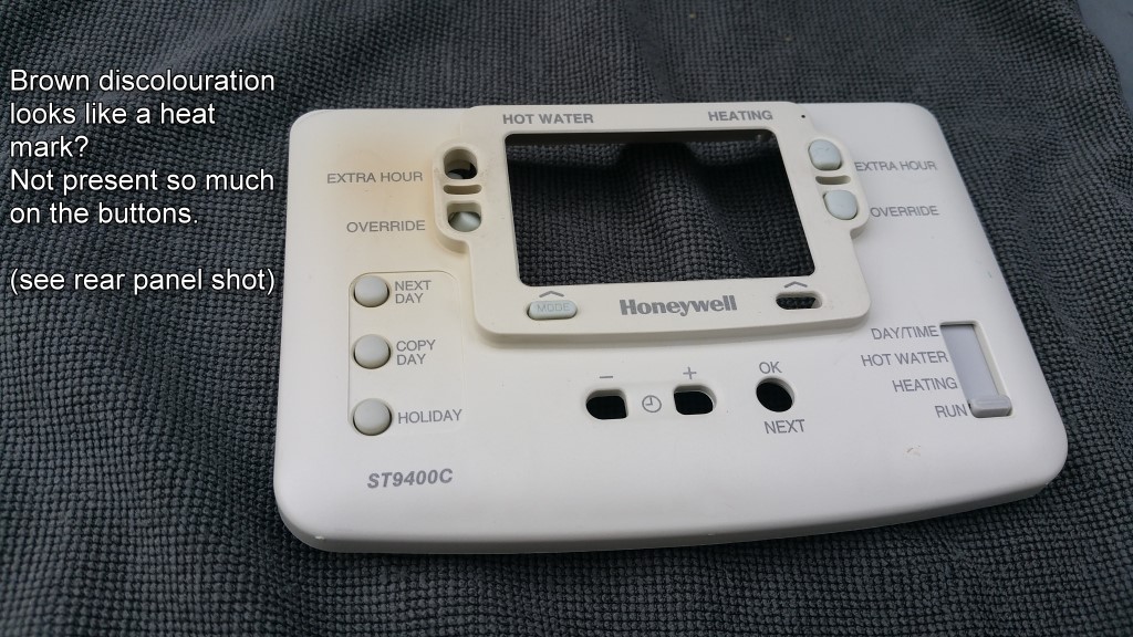

I opened up the programmer (see pictures) and replaced the relays and large capacitor with identical value components. Relay now does not buzz (that's good), but still getting this power cycling on/off. Obviously something is still not right.
It looks (and feels like) the pump is running, and from what I can tell, the motorised value is still operating.
I need to continue troubleshooting, but what to look at next is the question.

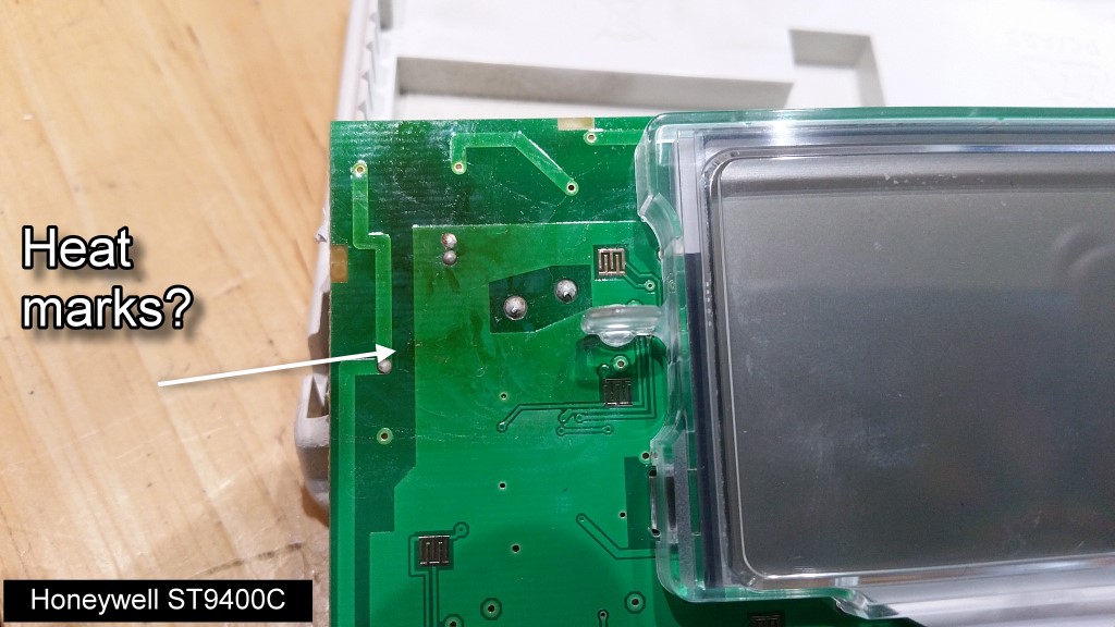

Does this still sound like a problem with the programmer. If so, are the heat marks corresponding to the resisters and diodes a clue? Do I replace those components?

front cover.jpgrear cover.jpgboard_display side_heat marks.jpgboard_heat marks.jpgboard_componentside.jpg R13 resistors.jpg
Remove the programmer from the base, using links, prove the integrity of the system, if all ok, but and fit a replacement programmer.
I do not have the circuit diagram for the 9400
I suspect the power supply section of the 48 volt supply is a capacitor+diode and it might be that the two capacitors have failed
After a certain age some of these will remain "good" only as long as there is a voltage to polarised them but when un-polarised the dielectric surface deteriorates.
Replace the programmer.
Also get the boiler serviced as indicated in the manual. Anything less is not a service

Apologies, late to this party. I have the same heat mark and warm to the touch spot on my ST9400C. This is Deja Vu for me, given my other posts on a Manrose extractor fan circuit, where a resistor is used to bring down the voltage for the timer circuit, then the heat given off by the resistor eventually blows the nearby capacitors. Another bad/cheap design driving premature failure and unnecessary electronic waste. I would say if you can no longer feel heat when placing your finger on the casing heat mark, the resistor is gone and could be replaced to fix. If the resistor is still getting hot, then a nearby capacitor has popped instead. The latter was the issue with my extractor fan, replacement capacitor fixed it.

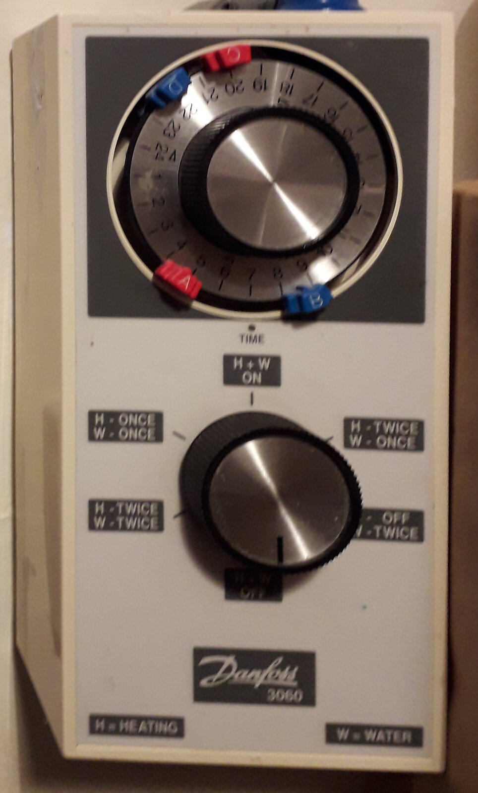

In the main simply not worth repairing, as to what to replace with, well the ST9400C is a simple programmer, same job could be done with one of these Danfoss3060programmer.jpg except they look hideous, so today we want a programmable thermostat so instead of simple on/off, it can set different temperatures through the day. A simple programmable thermostat is cheap, around £35 but wireless or one which also does domestic hot water (DHW) cost a little over a £100, likely the cheapest is Hive.

The old Danfoss 3060 I show was in this house, and I had to decide how much to spend and how far to go to improve my system, and you have the same problem, how far to go with the improvements?

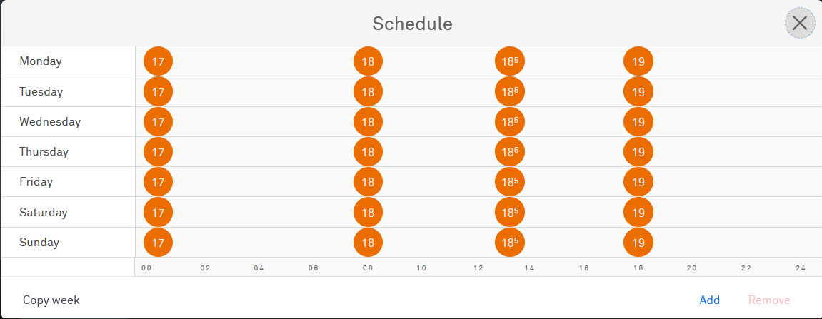

This 1698757610582.png is my schedule, the thermostat is set to heat up more and more as the day goes one to get around the fact it is monitoring my hall not all rooms. At the moment DHW is not on a schedule, as my heating is C plan I can't turn off DHW, it is always one when the CH is running, I did in the summer heat DHW three times a week for ½ hour each time, but since fitting solar panels it is electric heated in the summer, it costs 9p a kWh in lost payment on the feed in tariff, so cheaper to heat with electric.

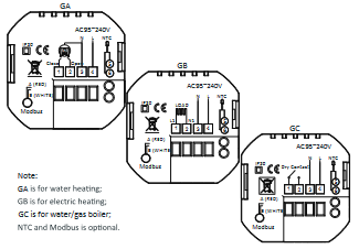

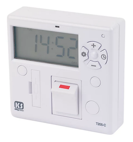

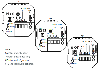

The Moes range 1698758354031.png of thermostats is about the cheapest with internet control, the BHT-002 BC is around £25 which is very cheap, but that leaves you to find some method of heating the DHW. Not an insurmountable problem, a simple timer 1698758829859.pngcould be used, on the other end of the scale you could fit EvoHome Wiser etc, and control each room independent.
However the main point is it is unlikely to be cost effective to repair the programmer, like mine Danfoss3060programmer.jpg they are destined for the museum, they are no longer fit for purpose.
