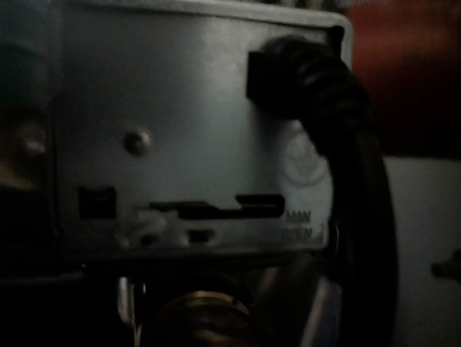

I have noticed that over the past month or two that my hot water is not lasting as long. I will run a very small bath for the children and have two showers and at the end of the first shower the water will go cold. In addition to this over this time I have also noticed that the heating also is taking much longer than it used to. I have noticed that the pump does sound noisy and is vibrating a bit but this has been going on for a lot longer than when these issues have.
Does anyone have and ideas as to what this could be or how I could fix it? The boiler is relatively new so I don't think it is that and the hot water used to last for the small bath and 2 showers and the heating was a lot quicker to get to temperature.
It is a conventional boiler with a hot water tank. I believe I just have the one valve
So I have had a look today and the valve is a Honeywell 3 port valve. There is a metal bit at the back that goes from manual to auto I have had a look at that and switches from manual to auto and it does not move on it's own feely back to auto which I believe it should do. Does this mean a new valve?
What is the valve not doing that it should be?
Not necessarily
If it’s stuck in mid position then it’s not allowing the full heat to either circuit.
It would be allowing heat to both circuits (whether called by the stats or not). I don't think that explains the symptoms, though I can't think of what does at the moment.

To test the 3-port valve operation, the OP simply needs to turn on and off, in turn, the HW, then CH. He should then hear the actuator react, to the changes in demand. If the suspicion is that the actual valve itself might be stuck, and the actuator head is removable - he could remove the actuator and try turning the valve spindle back and forth. It should almost turn, with finger pressure, but a pair of pliers might be needed.
If the actuator head, is not responding by moving, a common fault, is the motor failing. They can be bought quite cheaply, but not easy to fit, simpler to just buy a replacement actuator head.
