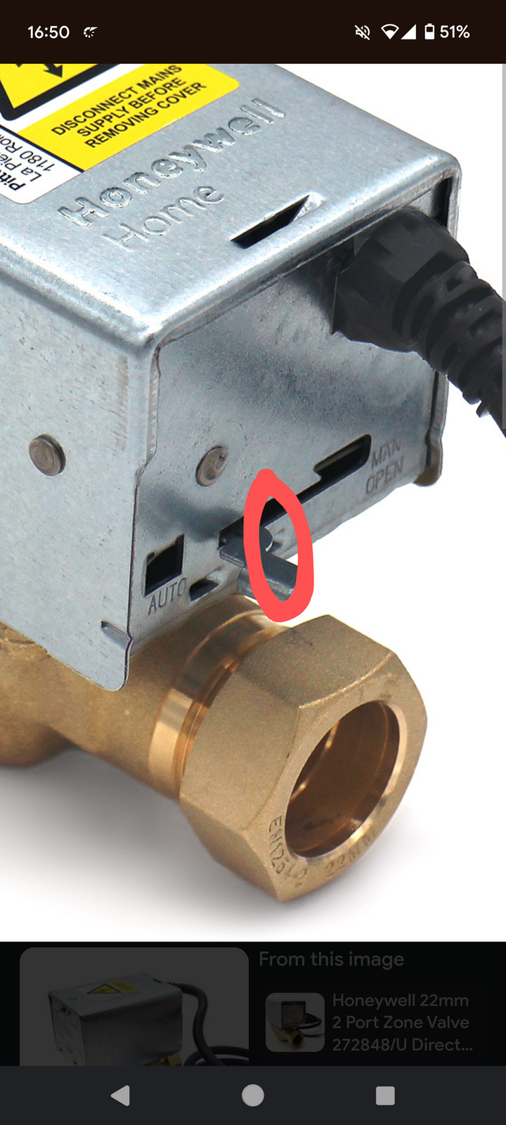

I have turned heating and hot water on separately. I could not here anything from the valve or actuator when the CH came on, when the hot water came on I heard a noise as if with was reacting to something but the metal bit at the back of the valve didn't move at all on both occasions (not sure if it is meant to or not)

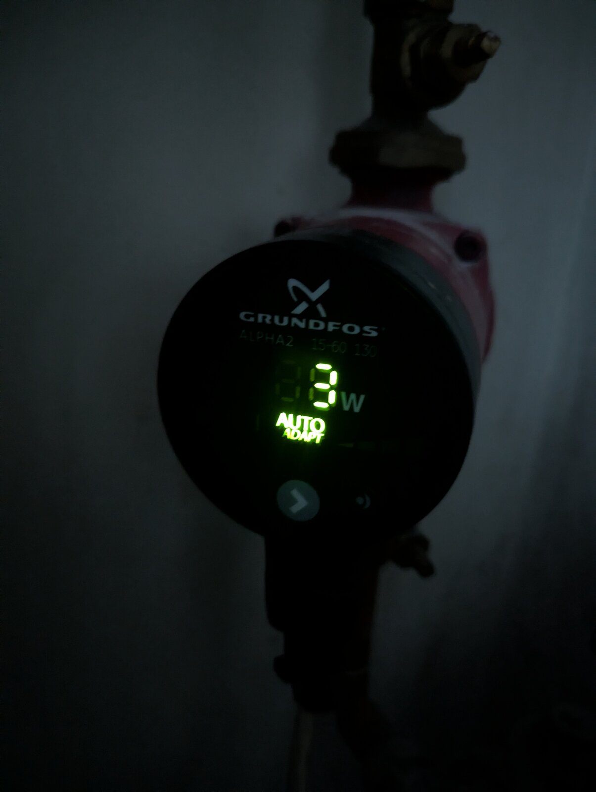

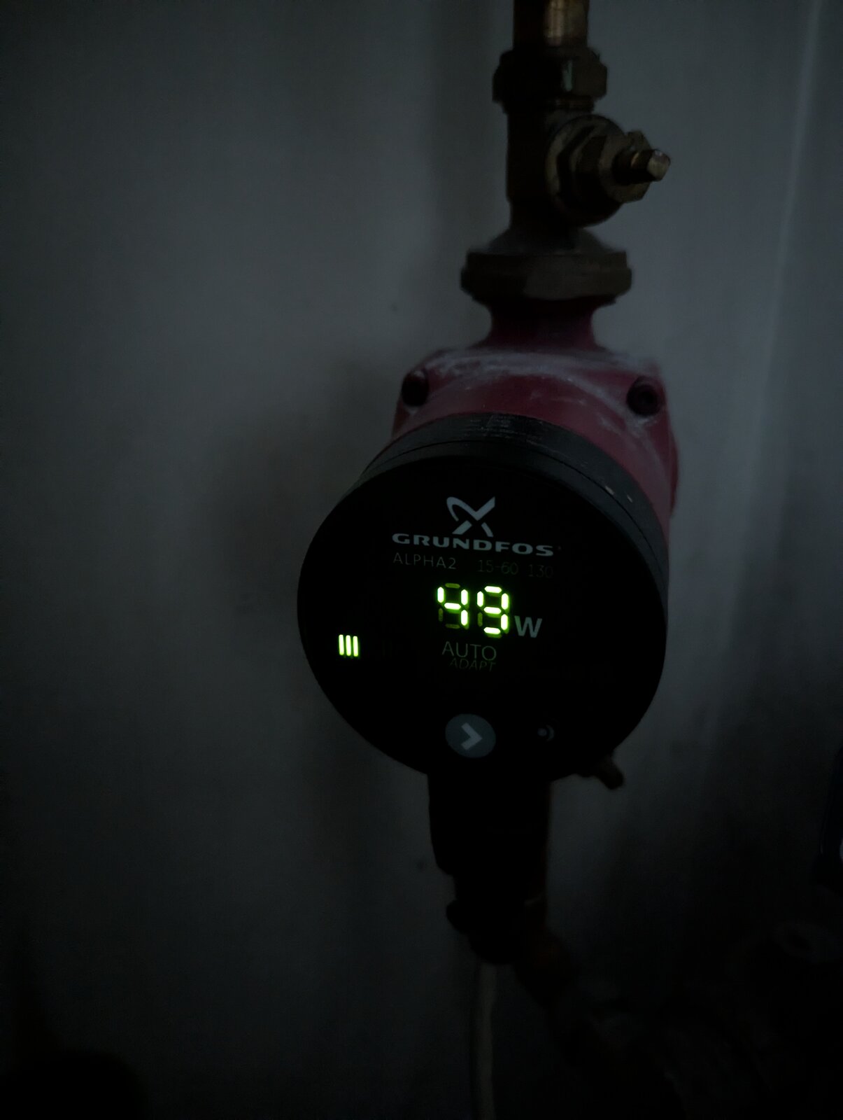

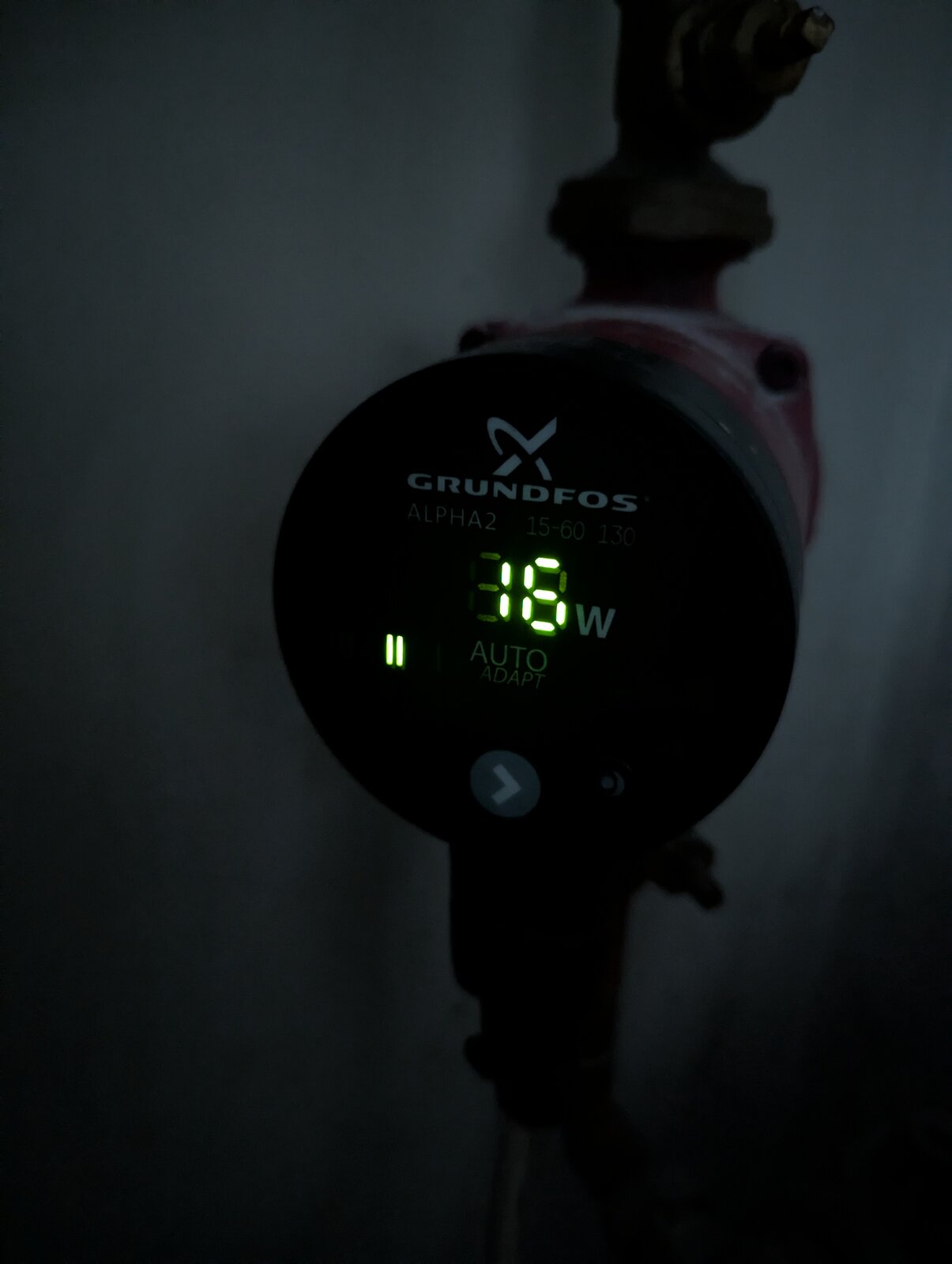

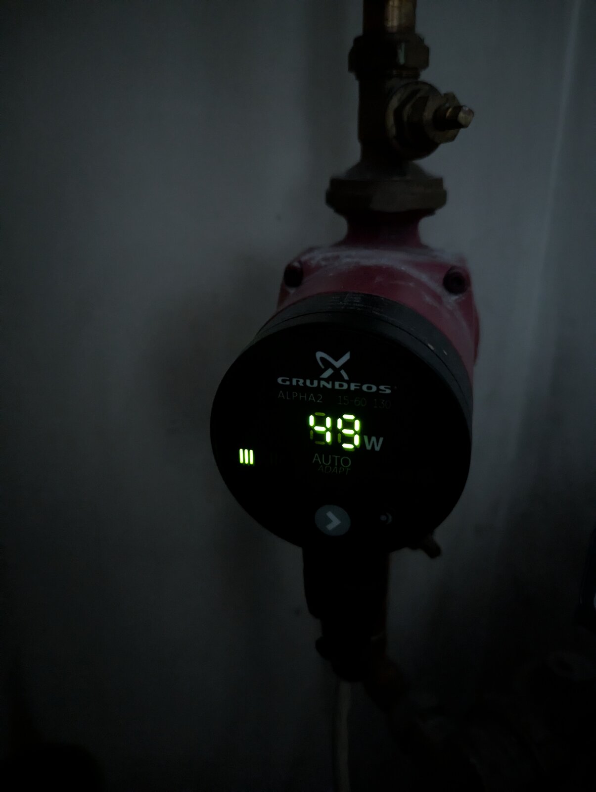

Of note the vibrating appears to be when the pump is on 3 lines, when I move this to two as shown in the video the vibrating is much lower (don't know if I should put it on this or not though?).
The video won't upload. It looks as though on 3 the pump is obviously working a lot harder and really vibrating but when I put on 2 it is much quieter and on the AutoAdapt setting is silent. I don't know if this will massively effect performance or whether I should do this?

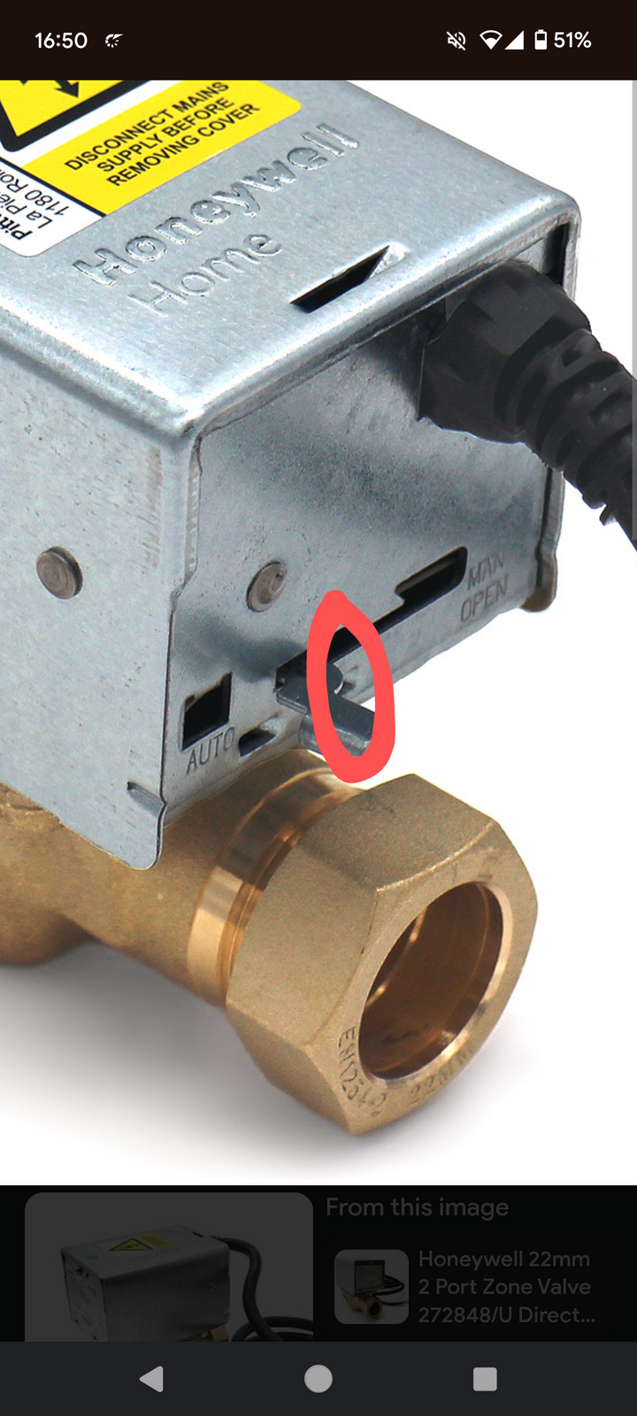

When I initially looked at the valve this grey metal bit was slightly to the right circles in red. I moved it to manual and released but it did not move back on its own as shown in a lot of the videos I had looked at it was just stuck and I had to move it myself back to auto and I move it all the way to the left (left of the red circle) and it does appear that the heating is heating up quicker. Could that have fixed it or just a coincidence?
It could be either, or neither.
The lever moves the valve manually to latch it in the mid-position, HW + CH, so the system can be bled. The first time, CH is called for, under normal operation, the manual lever will self release. My own experience, suggests 3-port actuators are the least reliable part of a heating system. My system uses one, so I always have a spare, in the cupboard, ready to fit.
I believe it could be this then as there is no movement from the valve at all by the looks of it! It makes the clicking noise but that metal bit at the back does not move.
Can you post the exact make and model of pump, when you say setting 2, do you mean fixed speed also called CC (constant curve setting) 2?, auto adapt does nothing, if its a Grundfos.
Dont take anything off just yet, I can tell you the exact flowrate from the pump curves
