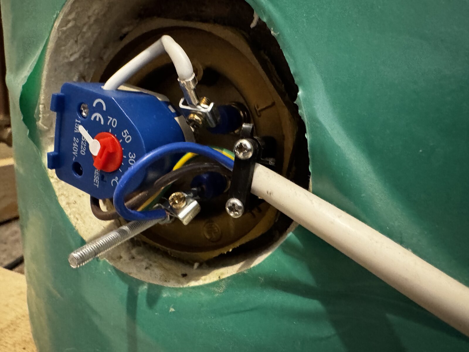

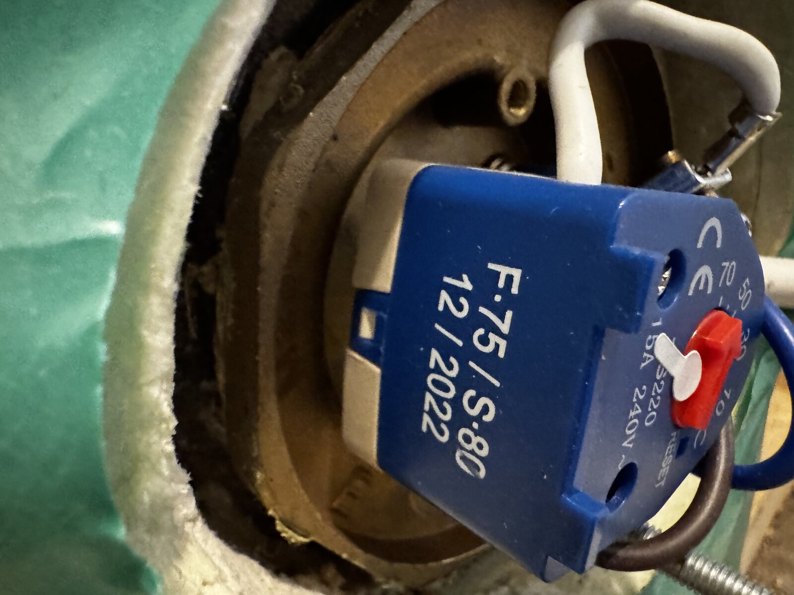

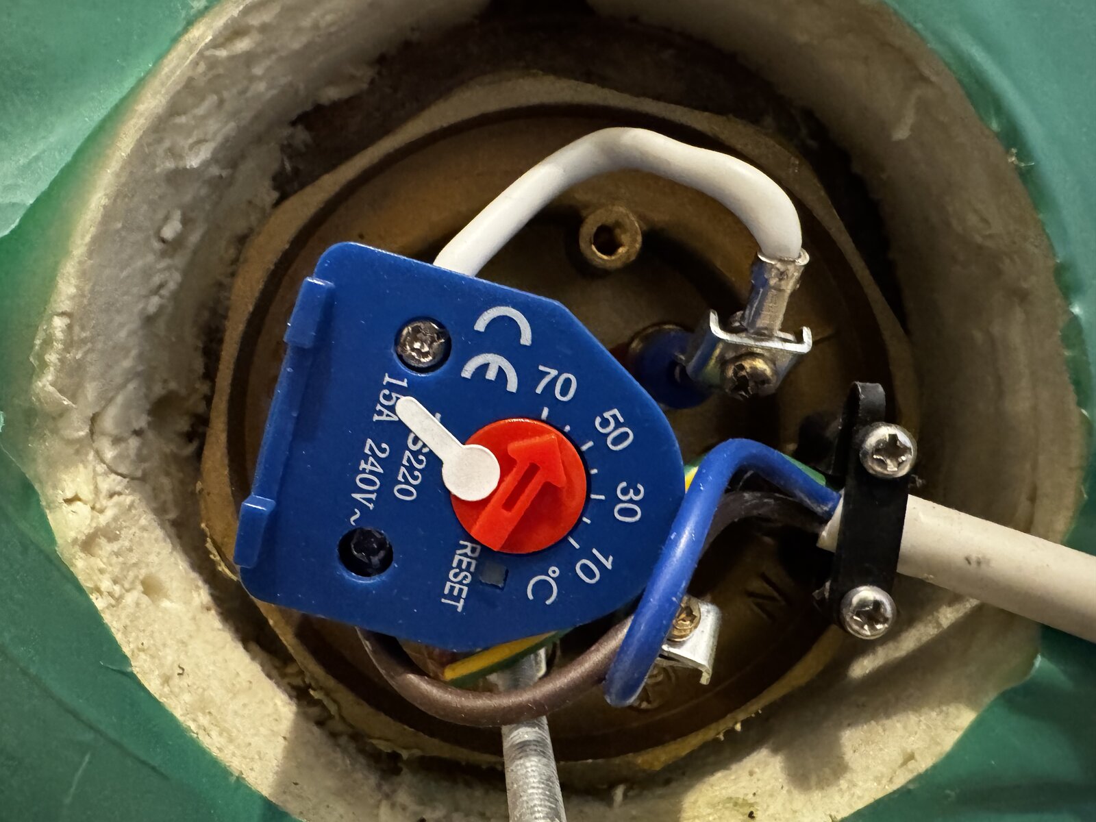

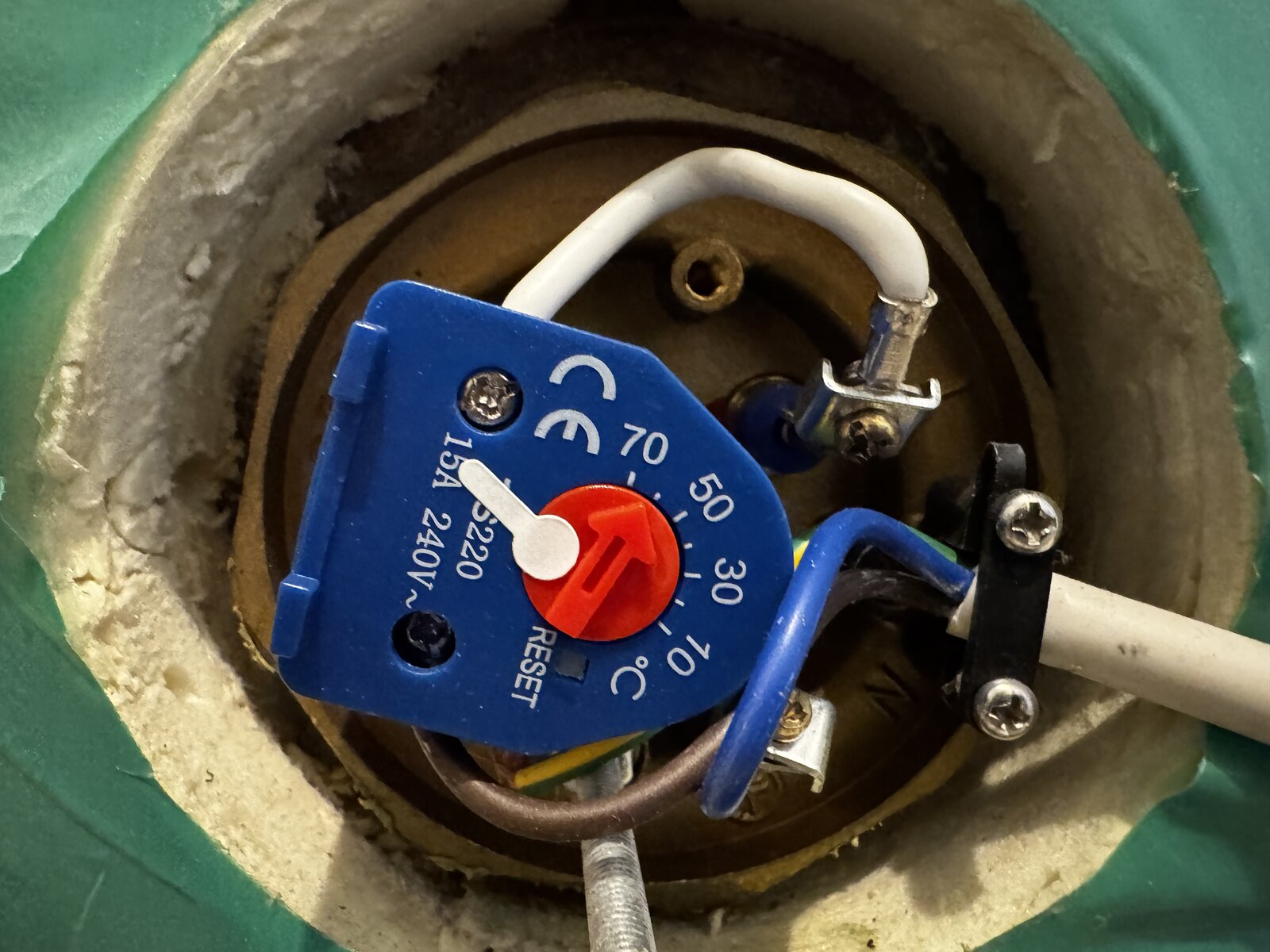

See attached photos of the thermostats.

Sorry, I am not convinced. If those photos are of the lower element, and everything is working properly, including that off-peak timer, off-peak element, and it's stat - then you should have lashings of hot water to fill a normal bath.
As already said - the boost, just makes use of the upper element, to heat a smaller quantity of water, should the main store of off-peak heated water, be exhausted. Per litre of hot water, yes they are expensive to use - more than twice the cost of your off-peak heated water. Which is why it is so essential, to ensure you get a full charge of hot water, and up to temperature, during the cheap E7 period.

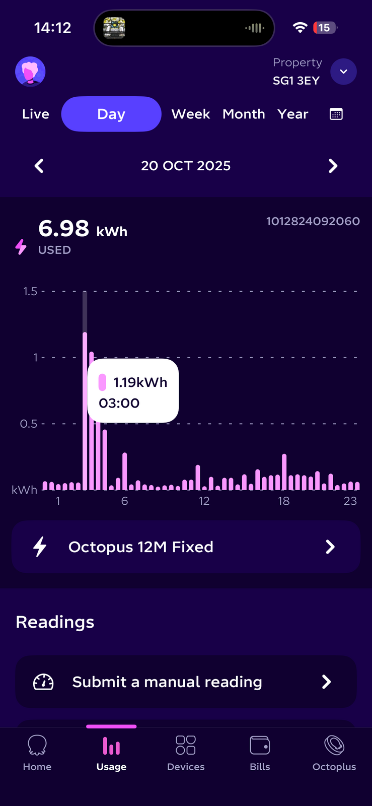

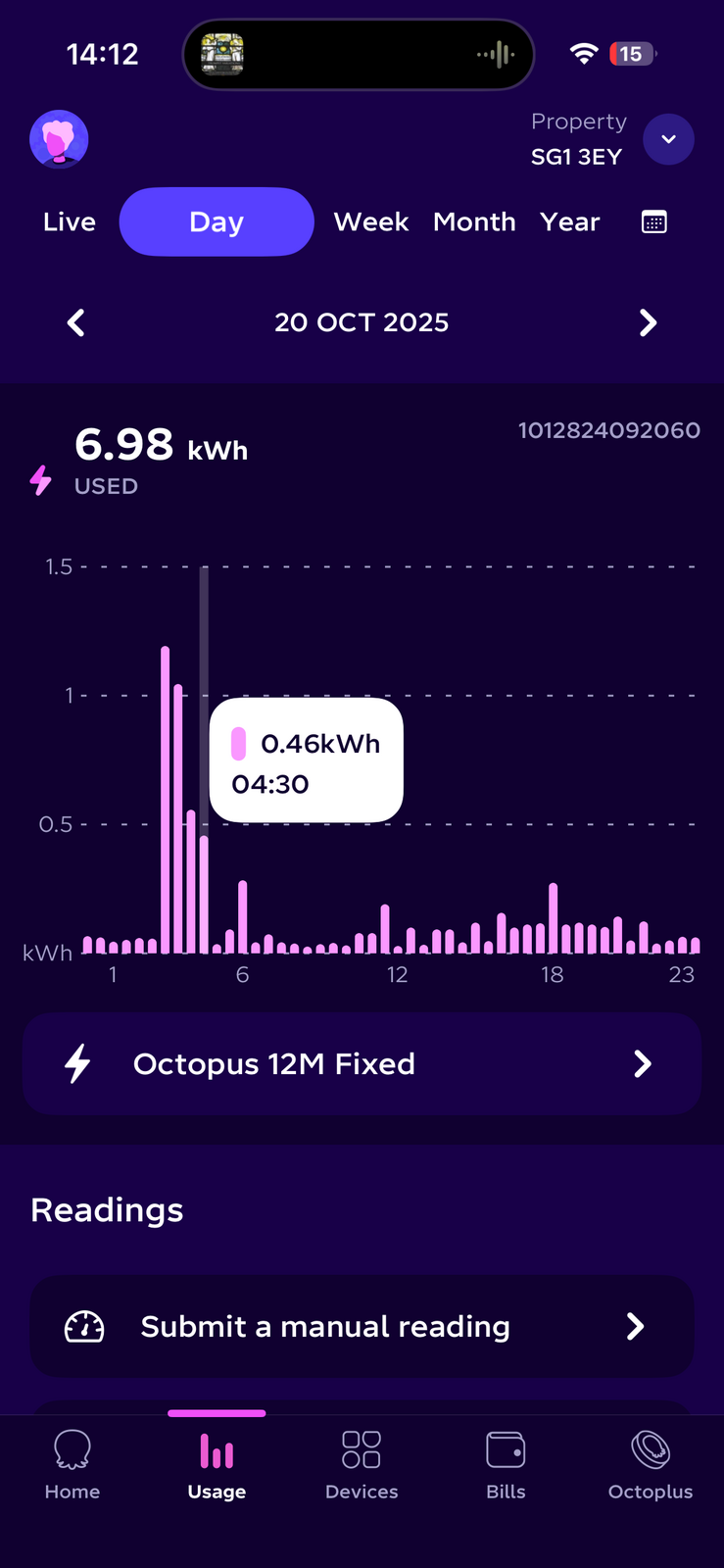

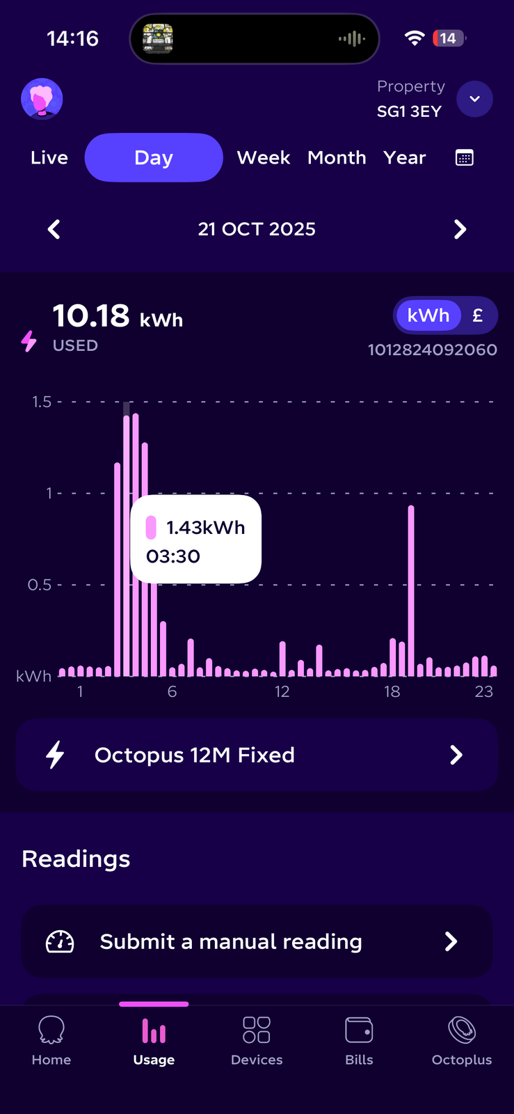

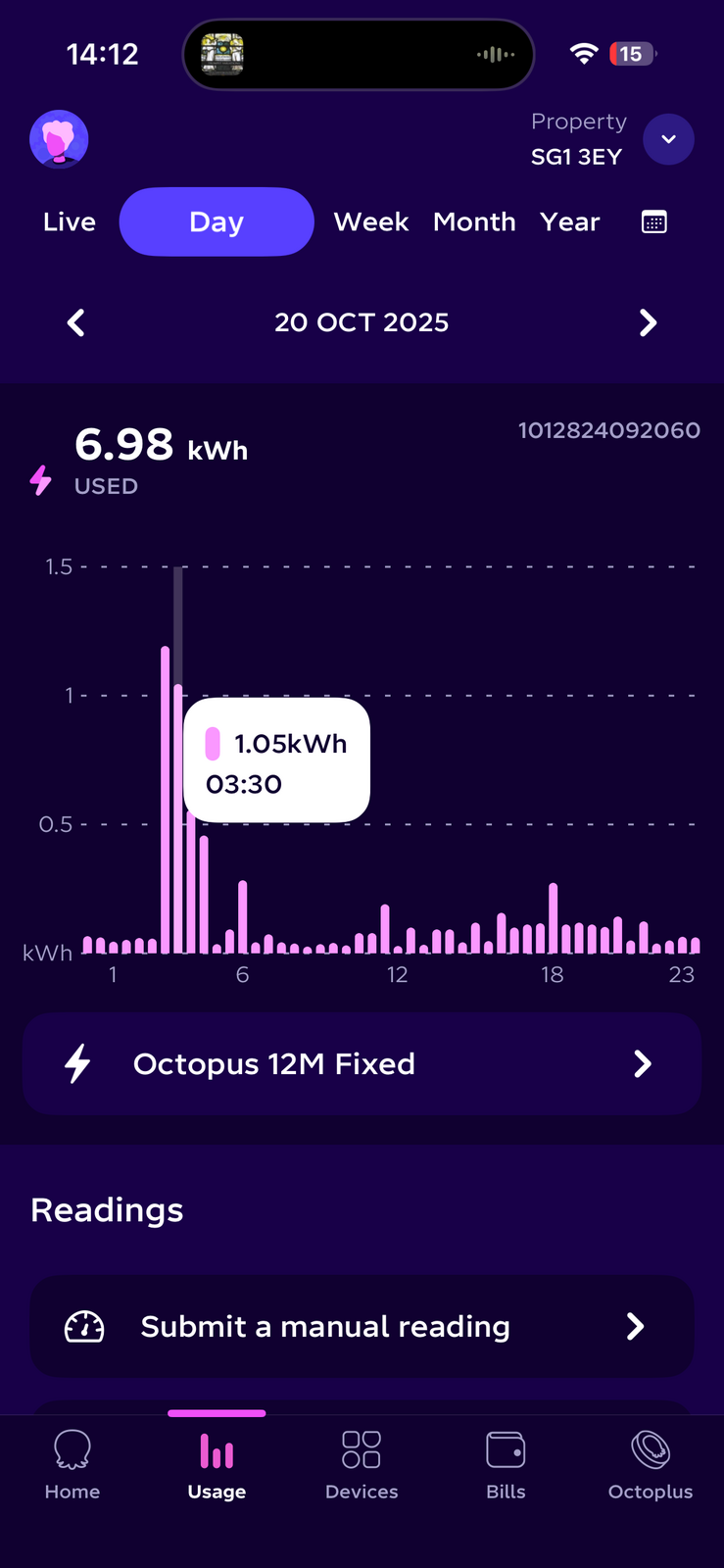

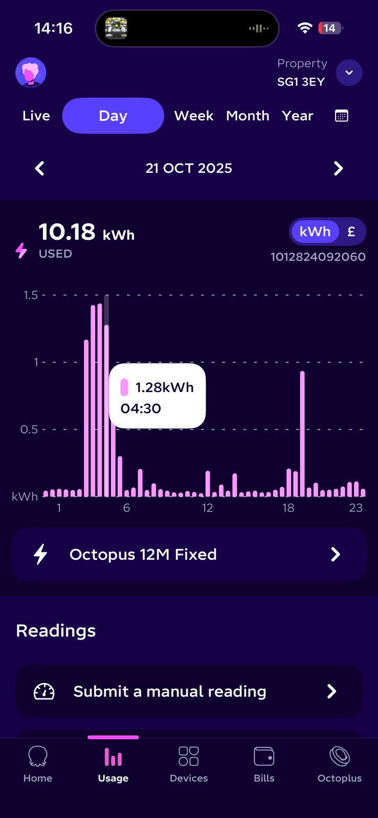

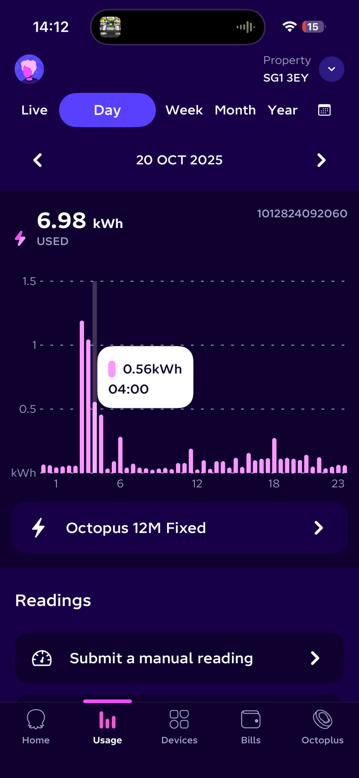

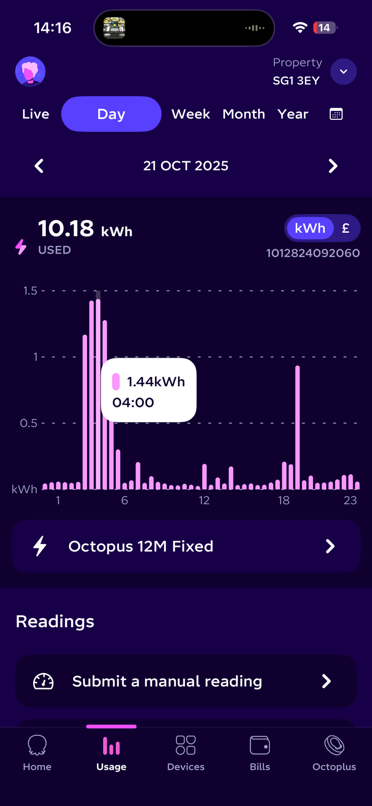

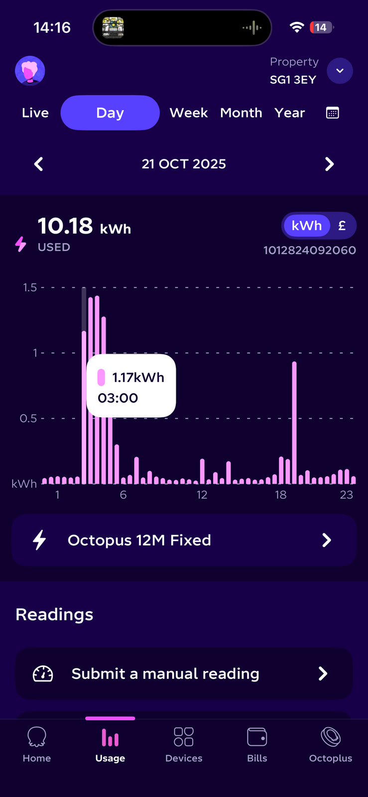

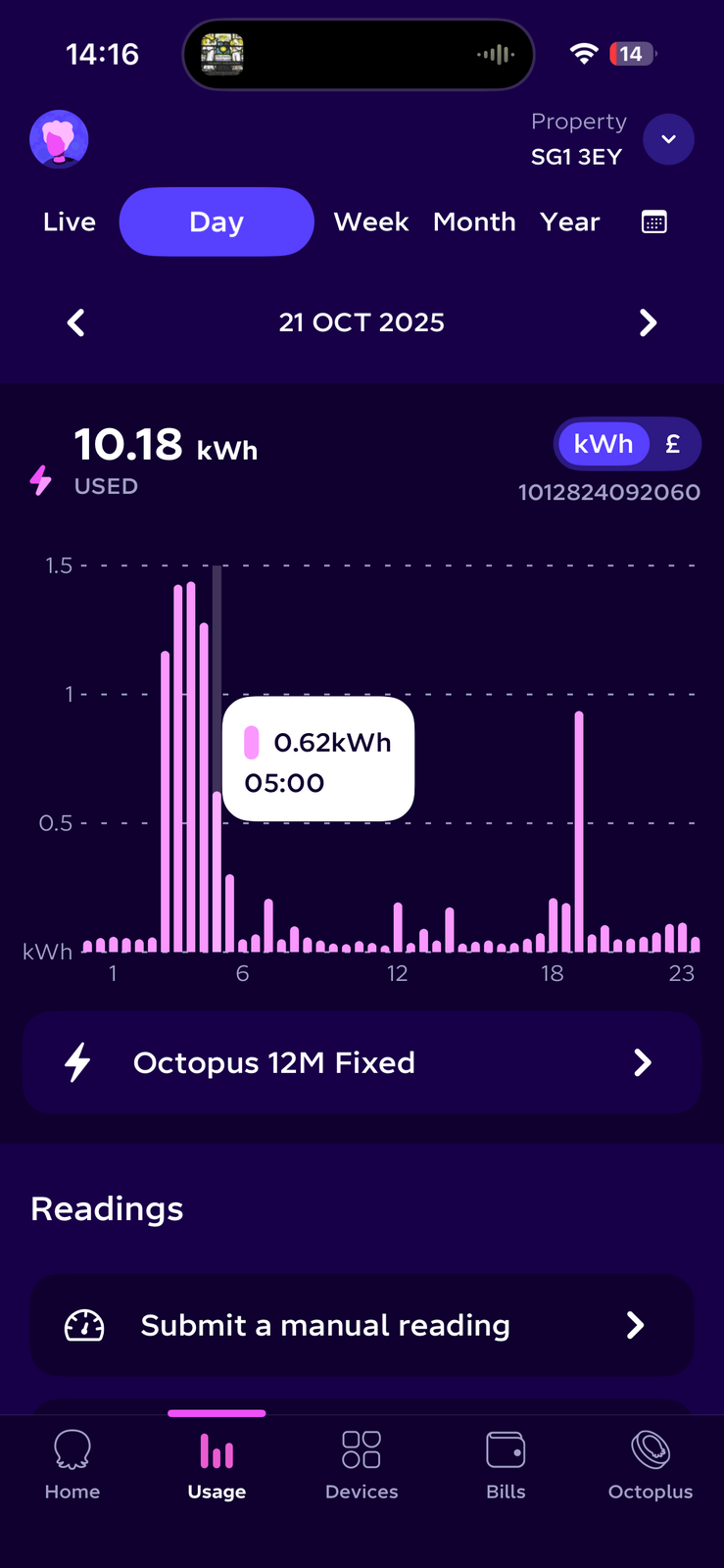

Here is a screenshot of energy usage during the times when the tank should be heating up. This was on days before the heaters were switched on.
I might be wrong as I don’t claim at all to have knowledge in this area, but glancing at these energy usage readings to me suggests the tank isn’t fully charging??
All immersion heater elements, consume around the 3kw. Your maximum in those graphs is 1.43Kwh, which suggests a small storage heater is charging up, rather than your immersion heater. That seems to suggest, your cylinder is not being charged up with hot water, during off-peak at all. The only hot water you would seem to have, the limited amount, provided by that boost system.
I wonder, have you checked your consumer unit, to see if any of the MCB's in there might have tripped?
Other than that - either the off-peak element, the thermostat, or the clock have failed, assuming the supply is OK.
^^ my thoughts but how is the water being heated unless it’s a 1.5 kw immersion?
Regarding those last graphs I showed you above were days when ALL heaters were switched off, none were charging at all.

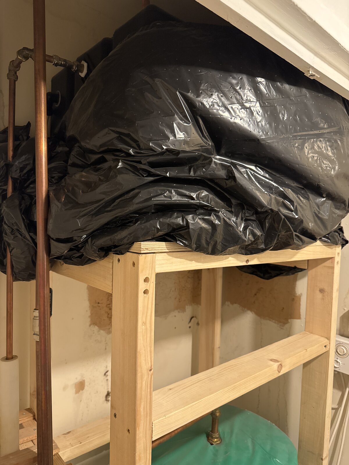

This is all making me now question somewhat the guy who came out today, from HA, not a third party contractor. He believes my cold water is from the mains, yet after he left and I wish I had questioned him on it but what is the black box above my hot water tank?? (See photo below).
That is an header tank, as you draw hot water from the cylinder, it will be topped up by that tank.

The thermostats seemed to be set to just over 60 degrees (I’ve attached photos of them again just to be sure)

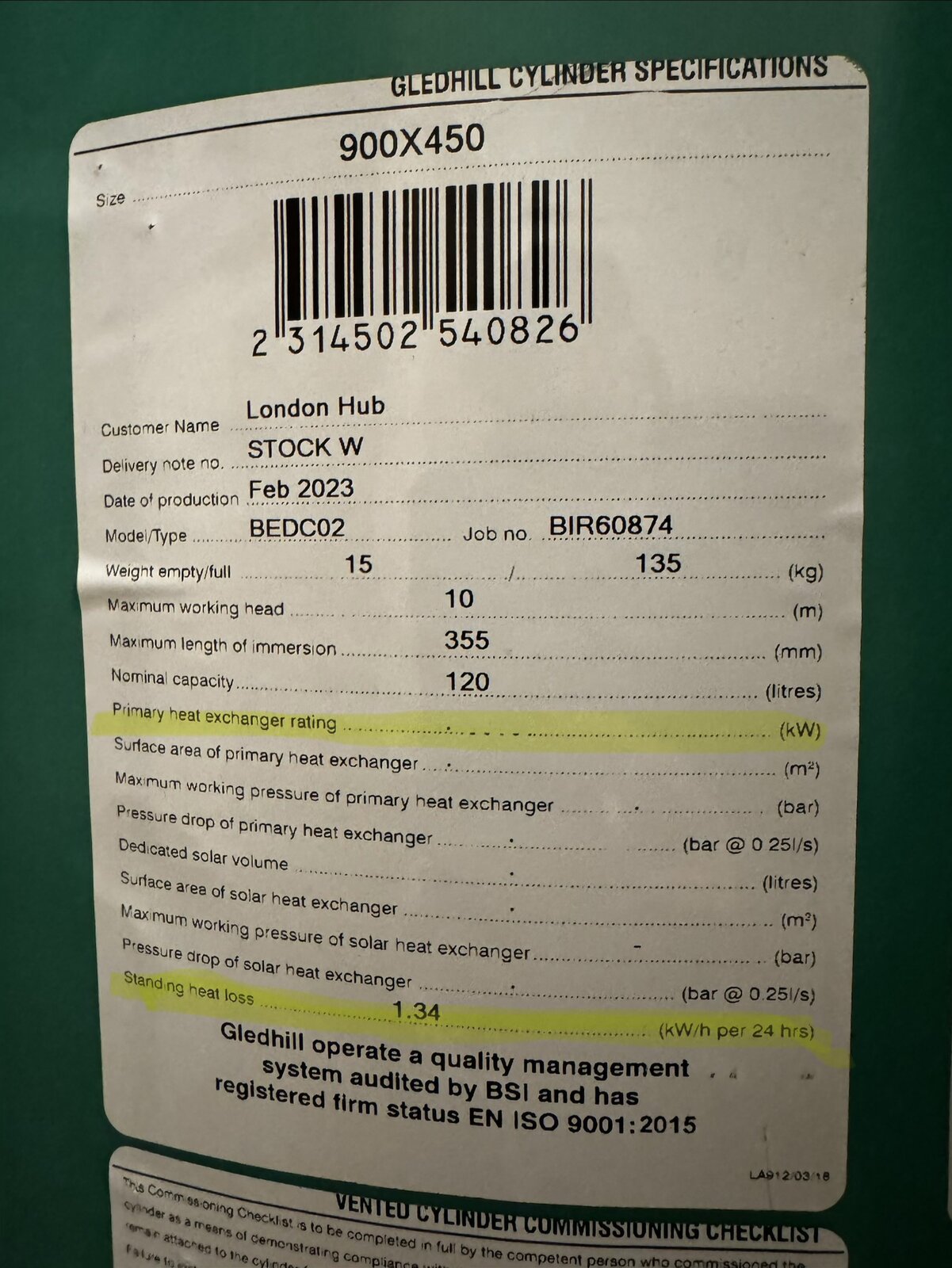

My best guess is that the E7 is heating the top immersion, and the boost is connected to the lower immersion. And the immersion is a 1.5 kw unit
Unless I’m blind but can’t see the immersion kw info on the cylinder (see attached)
