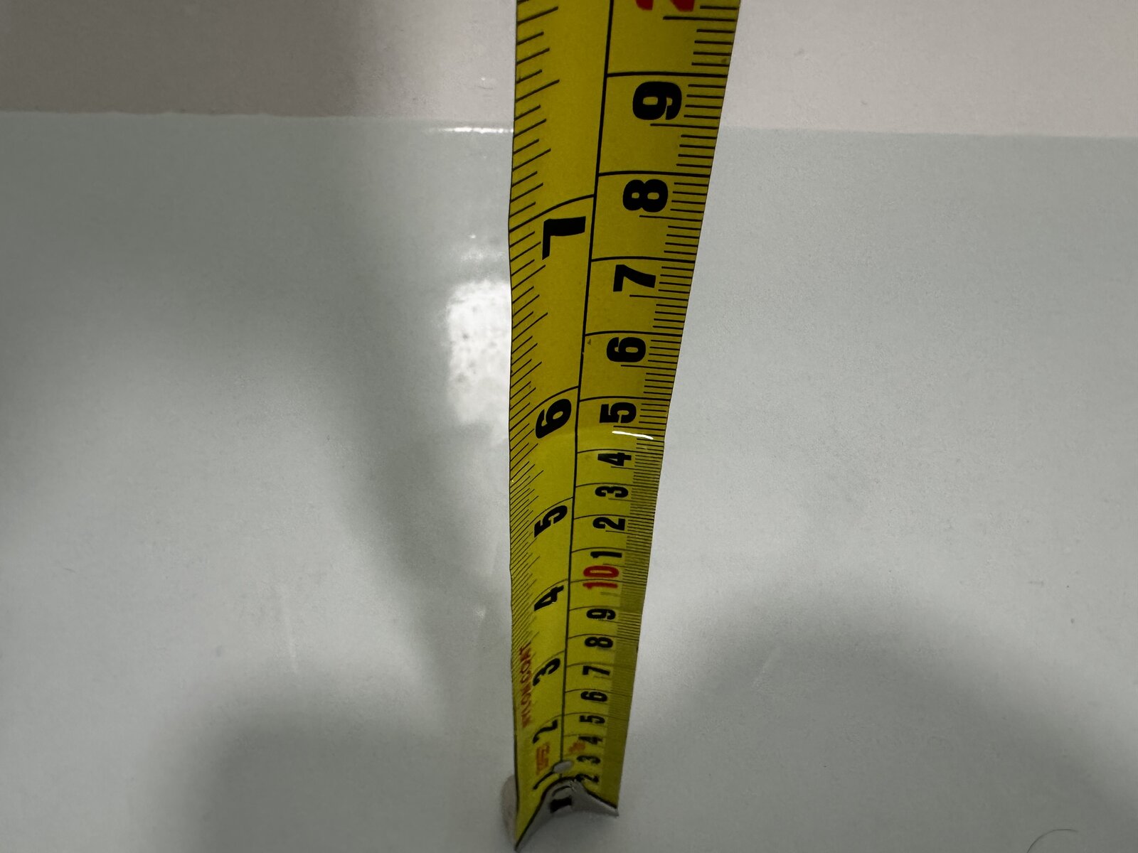

Run a bath again this evening and see photo of the measurement of hot water when finished before it turned cold and before I added any top ups from kettle and finishing with cold tap to get to right temp for me. And as I’ve estimated and measured before it is under 15cm deep.

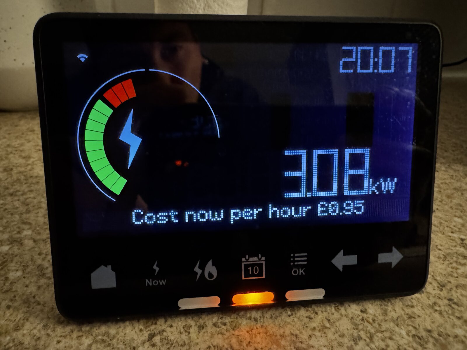

Also added photo do the energy usage live whilst I turned on the boost to see, and it sees to prove it’s working as it should 3Kw top immersion when boosted. But is it working overnight properly that’s the question!
Very obviously not. As explained earlier, and I agree with the diagnosis - the lower element has failed, and whoever 'fixed it', simply linked the boost element, to operate on both the boost, and the E7, thus giving you that very restricted amount of hot water. It likely, needs either a new bottom element, or perhaps a replacement controller. Either could be at fault.
It's a major fault, and is easily sorted out properly.
