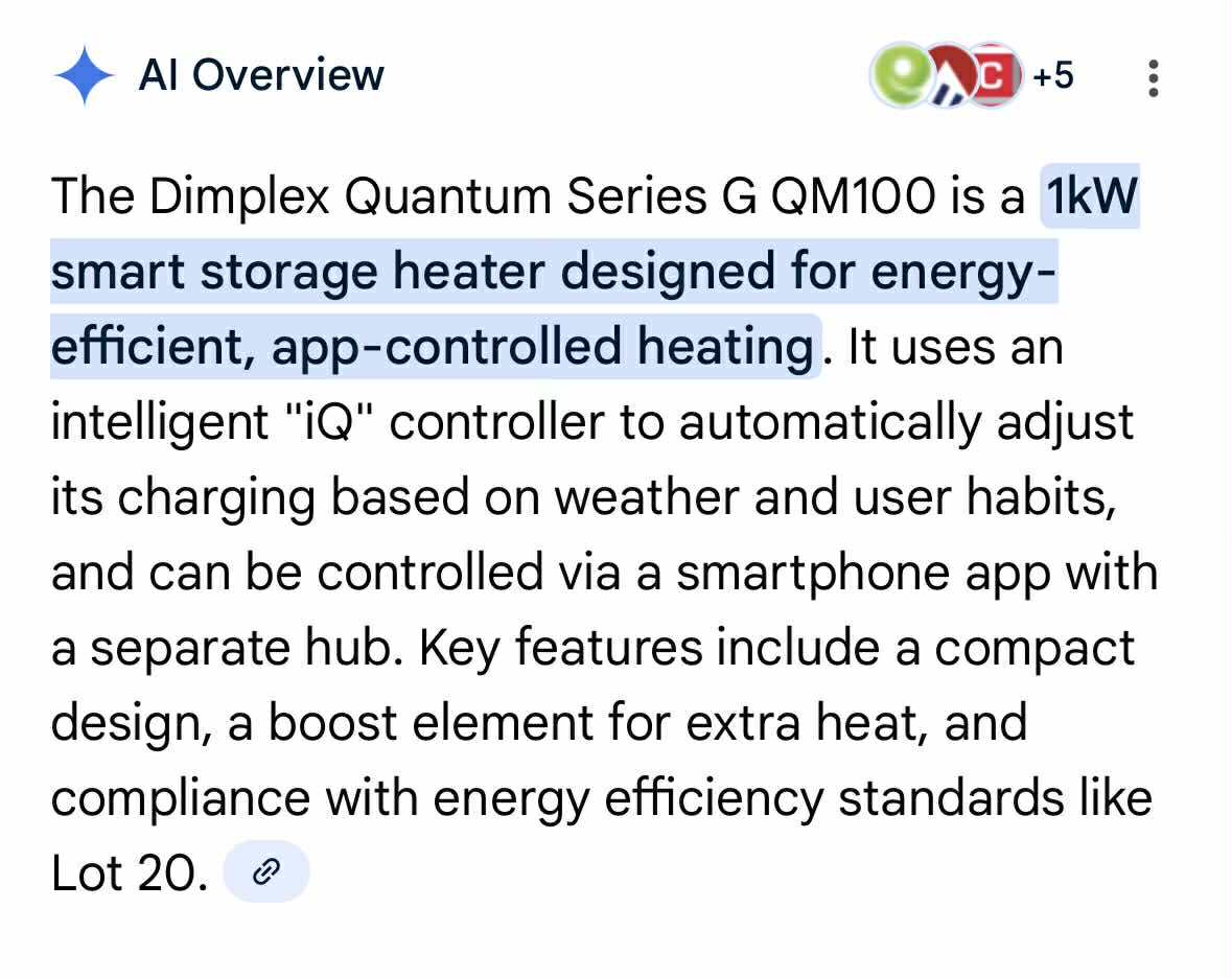

That is the total energy I suspect, so includes storage heaters etc.
Looking at the graph if the immersion heater and storage heaters switched on together I would a higher consumption for about 3 or 4 hours. The immersion is probably 3 kw and storage heaters are going to be 1 to 3 kw.

The heaters are 1kW if this helps, the below screenshot info suggests mine are app-controlled, they are not, I think those are only for the WiFi-enabled models
