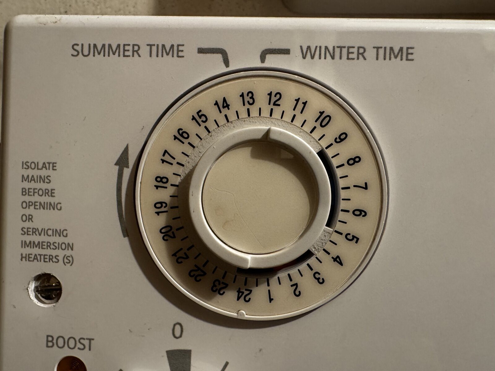

Yes turned that on and immediately makes a that sizzle sound for a minute or so. Took photos to show the light also came on.
That should be turning the upper element on, to produce a small amount of hot water, for those times when you use up all the hot produced on E7, via the bottom element. Is that clock, set at the correct time of day, where is says 'summer / winter'? That's BST/GMT.

As the clocks went back last night, the clock is also set correctly today as well on ‘winter’.

You could isolate the power, and remove that cover over the bottom element, and see what the thermostat is set at, under there. It will have an adjustable slot, pointing at marking for temperatures. 55C is what some recommend, but we like hot water hot, so we have ours at 65C. The hotter the hot, the more cold needs to be added to use it, the further the hot streches.
You could also try rotating that controls clock setting slowly, listening for the clicks as it turns on and off. It would need around 2 hours of on, to fully heat the cylinder. Don't forget to reset the clock, to the correct time.

has both the User and Installation Manuals for you to read ... the E7 times should be preset correctly but who knows? (ON time between 4.5 and 7 hours and between 23:30pm 09:00 and affects the bottom element only).
Boost only does the top element.
It may be worth checking when the timer is set to go on/off as I can't tell by the photos.
