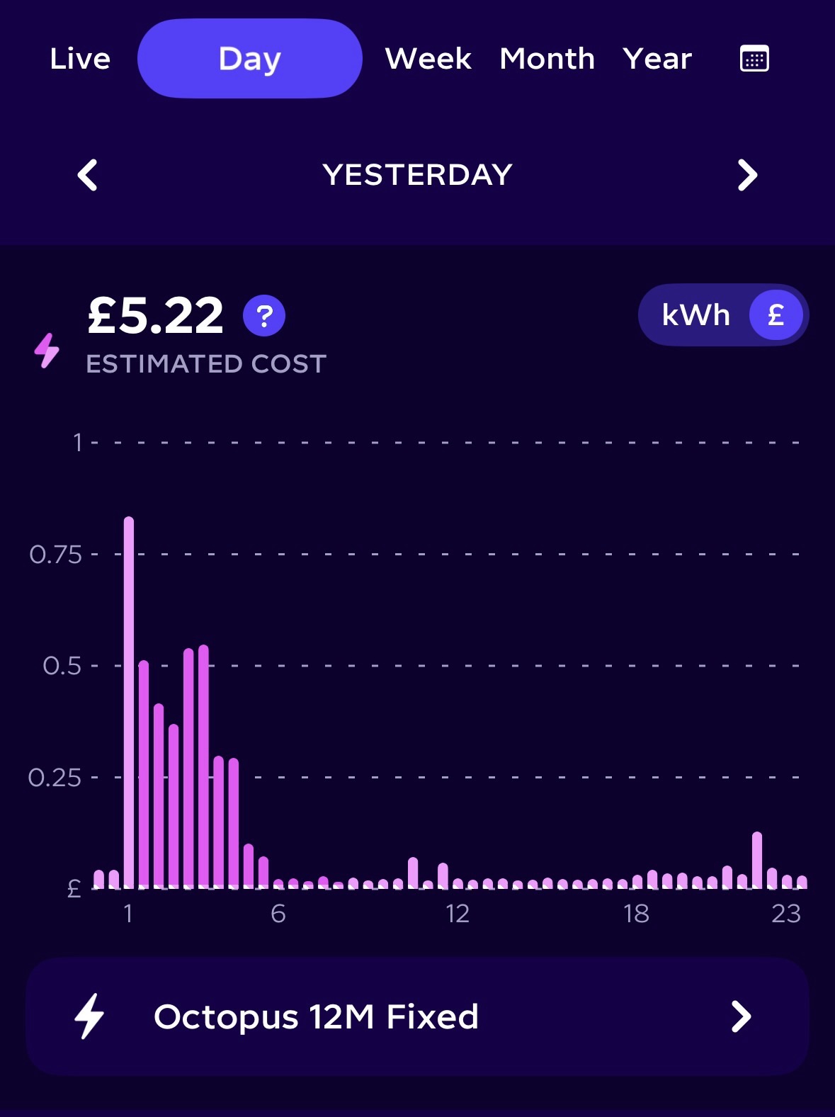

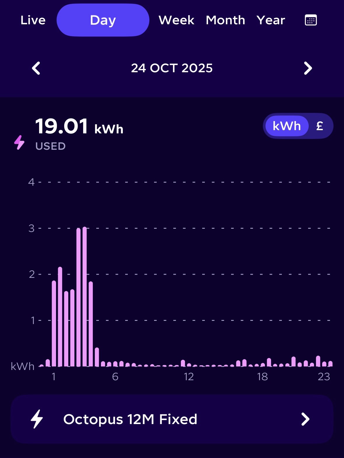

Don’t know how helpful this is, but attached is screenshots of the octopus app’s usage dashboard over two days: Friday 24th and Saturday 25th (showing as ‘Yesterday’ at the time of screenshot)
24/10/25: 19.01 kWh (£3.78)
25/10/25: 29.18 kWh (£5.22)

Looking at the Octopus readings, it looks like you're on a fixed tariff, rather than a time of use tariff like economy 7.
If that is the case, then a change of tariff will help, especially if you have storage heaters. You'd then just set the water heater and the storage heater timers to come on during the cheap period.
Can you post a screenshot of your octopus tariff that shows the price per kWh?
Is economy 7 still an available tariff?
You might look at Octopus flux as an alternative, if it's not...
...though you'll need to think about how to avoid using much power in the expensive 4pm till 7pm flux peak time if you do that.

so far I’m being charged £2.75 to £3.81 per day since Thursday (when I first turned them on), today has reached £4.29. Given the continued rise in Gas, I’m being told by those around me I’m worrying too much about it and it’s likely going to be not ‘far off’ from what central heating costs would be, proof will be in the pudding of my Oct-Nov bill, I’m on a fixed E7 tariff with Octopus.
Do NOT use the cost - use the kWh (kiloWatt-hours) consumed please... 1 kWh is one unit of electric and is then easily compared to other energy forms.
If on E7 there will be two rates Day and Night one higher (e.g. 30p/unit) and the other lower (e.g.7p/unit)
Well spotted! Those screen grabs show you seem to be on '12 month fixed', it's going to cost you a fortune, come the cold weather. This is what you should be on, I think they can switch you remotely - https://octopus.energy/help-and-faqs/articles/what-is-an-economy-7-meter-and-tariff/
