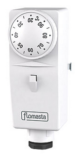

Is there some thing like this
![1705845691088.png 1705845691088.png](https://cdn.diynot.com/data/attachments/330/330278-0eed47386543071f51dba3b51db43b2f.jpg)
on the hot water tank? Do you even have a hot water tank or is it inside the boiler?
