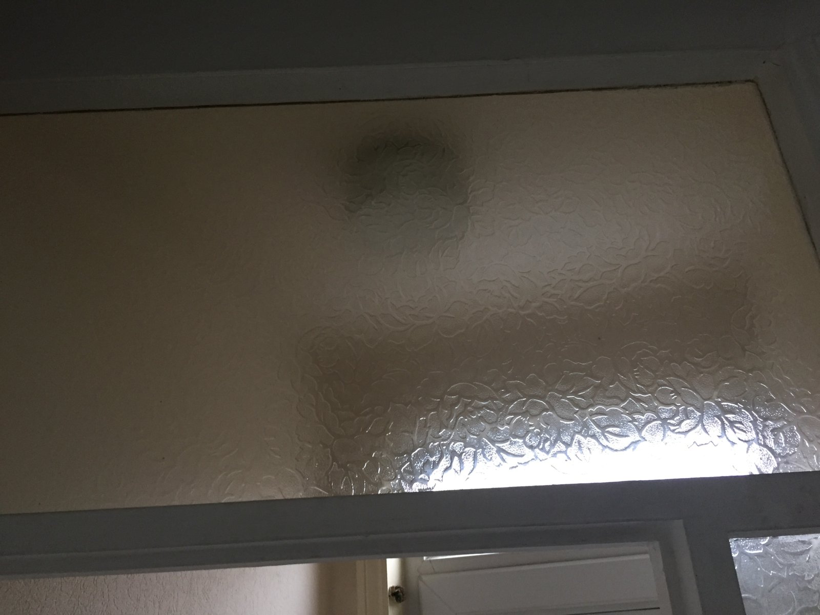

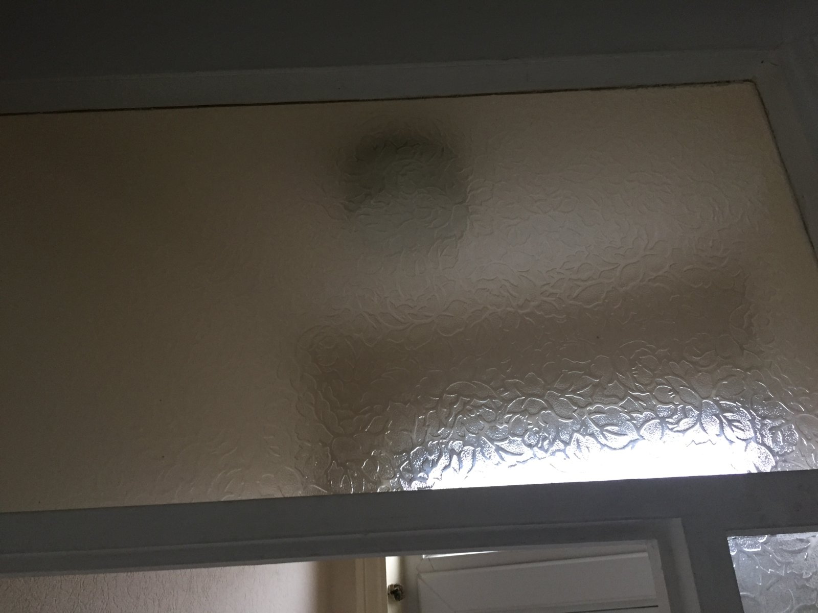

Hi, I have a 1930-40s terrace with glass panels in the vestibule,with a small section of glazing going down to the floor, can I tell whether it’s safe ?
Also a half glazed internal door with a leaded pattern on it, looks fairly modern.
Well the glass in the picture is Florielle and is relatively modern. Ideally as it's above your head it should be toughened . To tell in one of the corners should be a ' Stamp ' showing the tough mark . With either be en12150 or bs6206.
Again the same for the vestibule, if it needs replacing it will have to be a safety glass but if it's original it may very well not be a safety glass currently
Above doors does not need to be safety glass, Although if you plan to change it for the extra £10 to get it toughened I personally would

Thanks guys, I didn’t notice any markings , but it sounds like it may still possibly be safety glass ?
If I crack the bottom one would it shatter into lots of small pieces if it’s safety glass ?
Toughened glass shatters into tiny pieces like car glass and will also withstand a greater impact before it breaks unlike laminated glass however laminated cracks but stays intact like a windscreen, both are classed as a safety glass

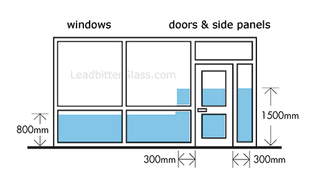

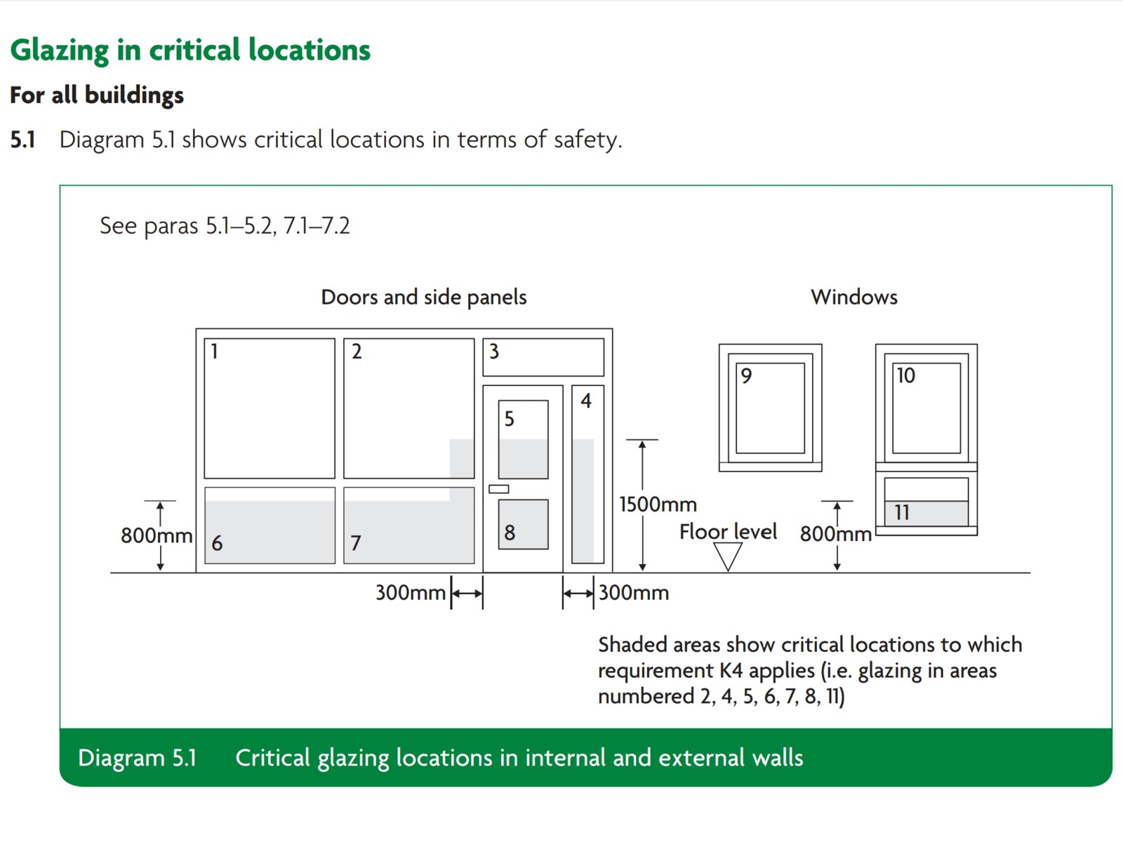

Leaded glass, if its the traditional kane lead with individual pieces of glass then they are exempt from document K or reg 14. If you have stick on lead so the glass has to be safety glass if it falls within the 'critical location as defined by document K or reg 14 i.e. any glass lower than 800mm from the floor, any glass panel within 300mm of a door upto a height of 1500mm, any glass within a door upto 1500mm. However if the glass within a door is less than 250mm wide and no more than 0.5m2 in a area then 6mm annealed glass will suffice
Your 'fanlight/toplight' although within 300mm of the door is well above the 1500mm mark so by regulation does not fall within the 'critical location' but as has been said for the few quid difference between float glass and toughened you play it safe and spec toughened glass, the side panel is within 300mm obviously and because it goes right to the floor it has to be safety glass
Heres a handy guide showing critical locations, if any of the glass falls in the shaded area then it needs to be safety glass......
