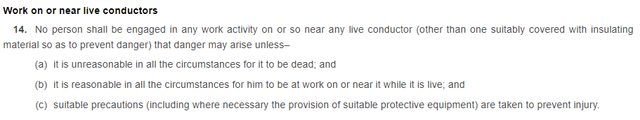

how electricians work with live wires when changing consumer units?
They don't.
The supply is disconnected first, either via an isolator if there is one, or the main fuse if not.
Not only is live working dangerous, it's also against the law.

There are safe working procedures developed to do this.
I don't want to go into too much detail on a public forum but such methods involve techniques such as only exposing one live conductor at once & using insulting tools & gloves.
I've heard of such procedures for jointing cables and changing service cutouts, but not for changing CUs.
