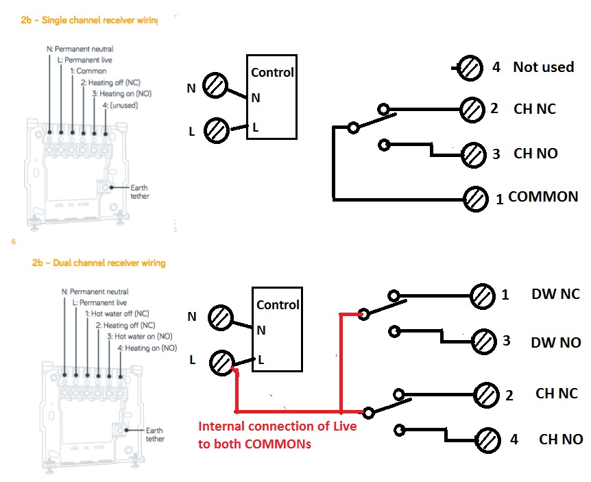

There is a critical difference between the single channel and dual channel Hive receivers,
The single has a dry contact ( volt free ) change over, The common has to be connected to a voltage source from the boiler.
The dual has two change overs with the commons connected internally in the receiver to the Live.
The dual receiver cannot be used to switch a 24 volt control ciruit to the boiler
