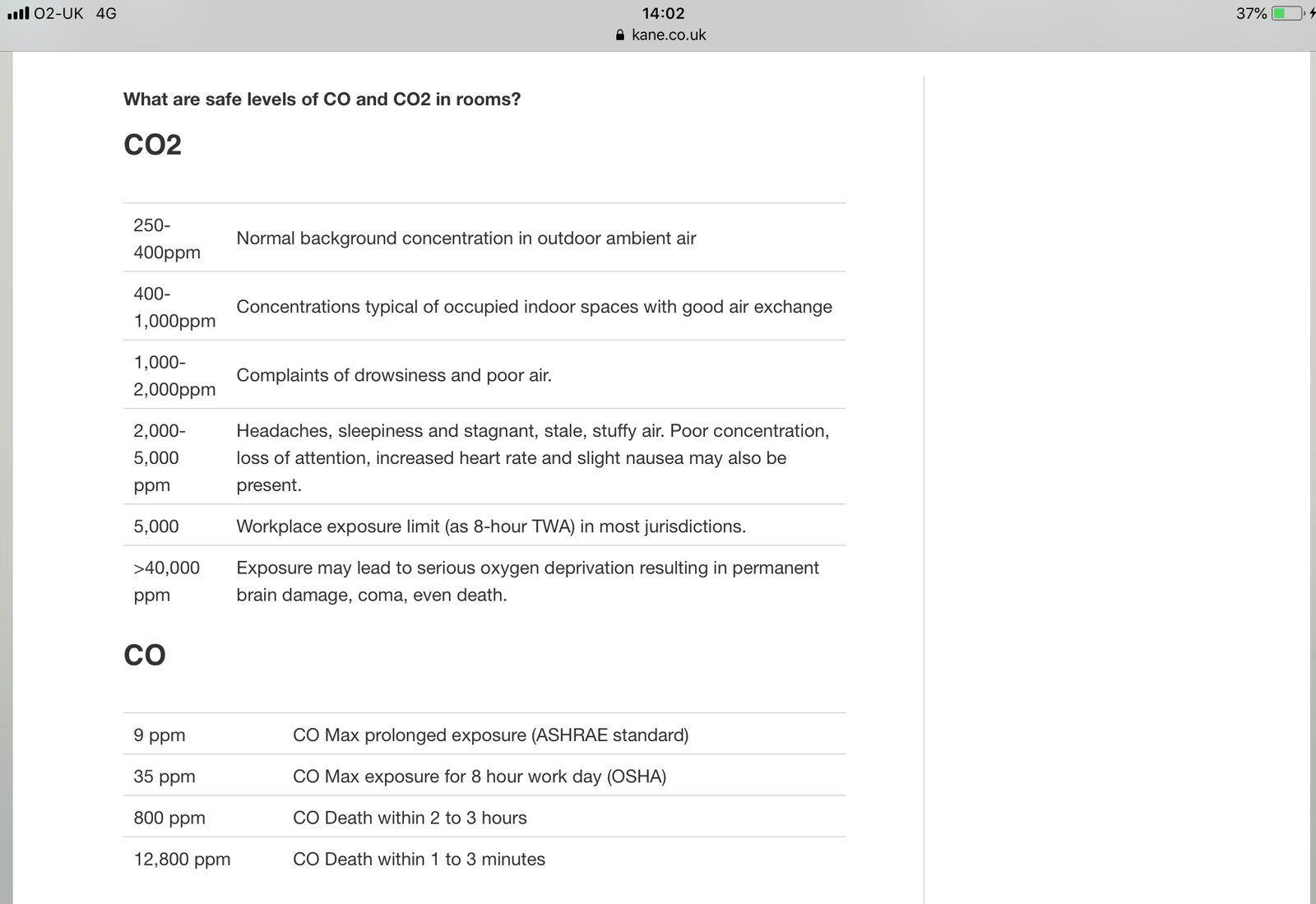

Yes, If in high levels of concentration. (CO2).
Unless you’re getting confused with Carbon Monoxide? (CO)
