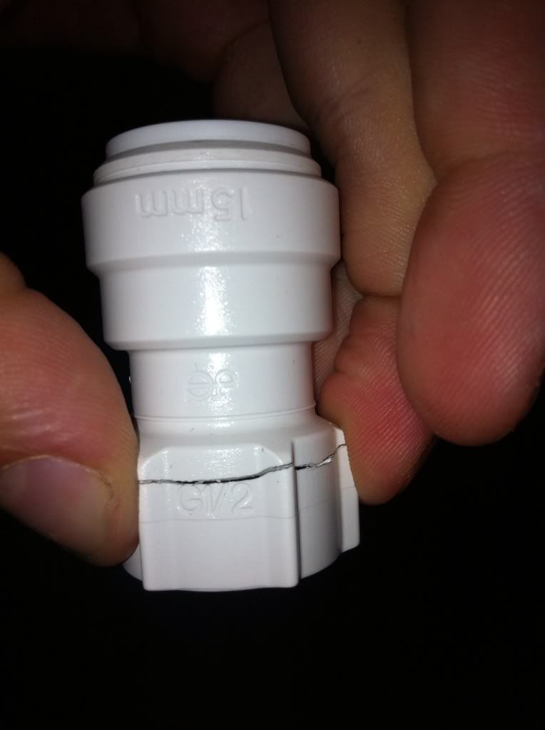

Some one show me ANY evidence (not including polybutylene from the 1970's) that plastic or 'push fit' is any less reliable than copper ?? There is non is there, just old wives tales.
Lasted 12 days
As for 1000 years the orings have an expected life of 25 years on clean cold water. On a heating system either dirt or containing chemicals this will be considerably reduced. I'm not trying to scare you I speak from experience
gasservice1985 thats shocking I agree
Lasted 12 days
I had to remove one of then over christmas that had split exactly like your pic. Insurance wont pay the home-owner as its an 'un-approved fitting for a central heating system' apparently. I re-piped in cu.
