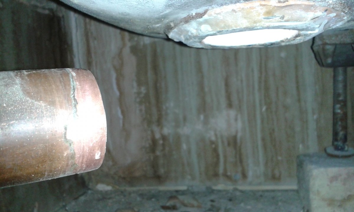

Yep, if you are going to fit a new waste.....the rose will just spin inside the bath anyway, and they can be dead awkward to hold.
Did this have the copper trap, originally?

Is it a better idea to renew the entire waste, including the overflow, in plastic? I guess there was a copper trap somewhere here, with the nut at the bottom to let the crap out.....takes me back, those!
John :)
A bit hefty for the job mate as you don't want to score the bath underside.....a grit wheel is really what you want - that one is for masonry.
No chance of getting a hacksaw in at an angle?

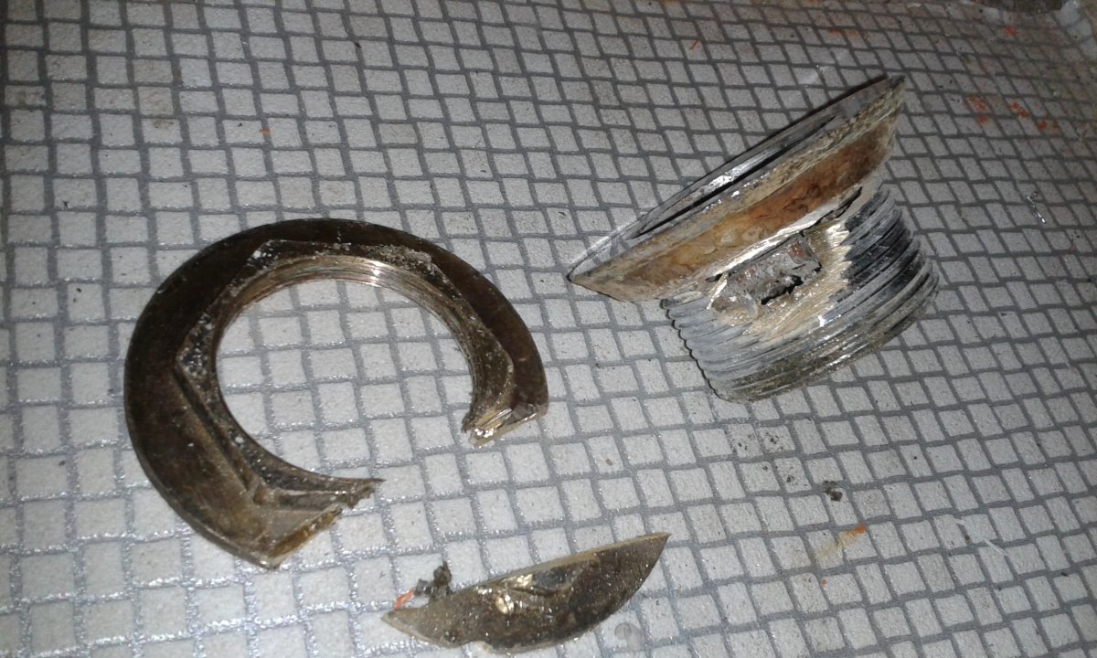

Drill the nut with a drill the same width, then use a heavy screwdriver, cold chisel, to snap the nut off ... easy peasy ... lemon stuff ;)
THanks Guys!!! For all the advises really appreciate.. Start this morning at 10am and just finished now
