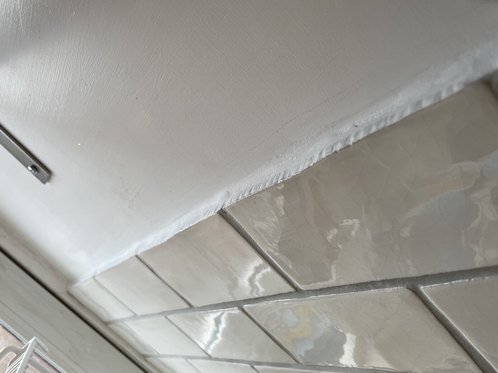

I've recently had these tiles installed, and would like to smooth the top somehow so I can then paint the top the same colour as the wall (I do not want to use tile trim). The tiles are quite 'rugged' hence the jagged line.
I've applied primer. What's the best product / process for smoothing out the surface before painting? Should I use something like polyfilla and then sand it down a bit?
Thanks!
You could use some easifill plaster, maybe applied with a cheap mini plastering trowel to form a straight line
Then sand with some abrasive around a block of wood - be gentle with it easi fill is soft
Whatever happened to tiles with one or two rounded over corners?
Thanks, that sounds like it could work.
