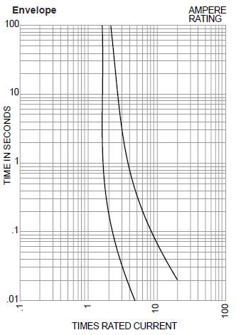

I found the curve for the 13A BS 1362 fuse.
As can be seen inrush around 4 times rating and needs around 1.5 times rating to blow. There is a variation in fuses but for 30 minutes it should take between 1.6 to 1.9 times the rating to blow. So I was not far out when I said 20A it is in fact 20.8 for 30 mins.
So around 4.7 kW so if everything is correct 3.3 kW should not blow the fuse once running unless used for more than 1/2 an hour.
