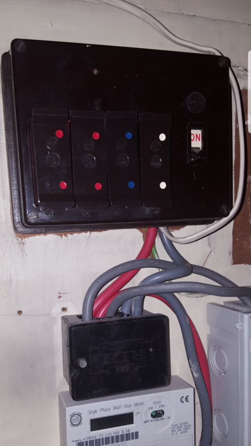

Sounds stupid but my lights blew a fuse and my fuse box is very old I believe I have to buy some fused wire and do it the old way.
How do i do it step by step.
I understand I have to unscrew the fuse for the lights.
Are all the switches in the other (grey) box on the right pointing in the same direction?
I doubt the grey box to the right is anything other than for a shower or out building etc?
The lights are going to be on the white fuse - This needs pulling out with the fusebox turned OFF. It is then pretty obvious how to replace the wire.
If you have no fuse wire, you could order one of these instead: https://www.tlc-direct.co.uk/Products/WYB6.html
I'd definitely replace with MCB's if you can, but you may not be able to fit the black cover on after as they are a bit tall.
Make sure you use the correctly rated fusewire, the lights are generally on the white dotted fuse and use a 5A wire. The fusewire should be available at all electrical wholesalers and expect places like B&Q, Wickes and Homebase to have them in stock.

Although 9 times out of 10 you can do this, first one should measure the loop impedance, I am uneasy about advising the change without first measuring.
You can however also fit cartridge fuses, if the fuse is too big for the loop impedance then it will take a second or so longer to rupture with a fault, if the MCB is too big then it moves from micro seconds to 5 seconds there is a huge step if the loop impedance is exceeded.
In theory if OK for a fuse it is also OK for MCB, but years ago often the loop impedance was not measured. I would swap, but I can measure the loop impedance.
to be honest - it would be a priority to upgrade to a modern consumer unit. RCDs change the game in terms of electrocution risk. I see there is a FIT meter too, so assume there is some sort of PV set up?
