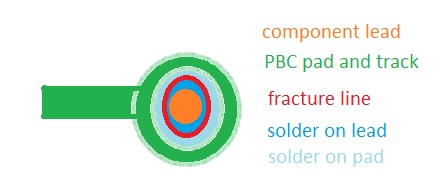

About ten years ago I got involved with the repair of a friend's boiler. Intermittant fault which the service engineer said was due to the PCB which he changed and took away the old one. Another fault occured soon after that and a second replacement PCB was fitted. This time the old PCB was not taken away and I had a look at it. Build standard was very poor. The faults on the boiler were due to failed joints on the PCB where pins in the connectors to the wiring loom were soldered into the PCB. To make PCB assembly easier the holes in the PCBs were over size. Instead of the pin being a tight fit and hence mechanically fixed into the board the pin was held in place only by the solder. Heat cycling and vibration resulted in annular cracking of the solder and thus loss of electrical connection between the pin and the copper pad of the PCB.
I took the matter up with the boiler manufacturer and they agreed this mode of failure had been identified as a quality problem and the company who manufactured the PCB had been told to improve them. The outcome was that the wiring loom for the boiler was soldered directly to the new PCB and all new PCBs came with the loom attached, the old loom was removed from the boiler and discarded The new PCB also had anti vibration clamps to secure the loom and prevent the joints being subjected to vibration from the loom.
I also became aware of the cost of the PCB to the boiler manufacturer which was high compared to the ( estimated ) cost of making the PCB. Then there was the cost to the installer of the PCB as a spare part from the manufacturer. Quite a bit of profit to all involved. Which probably explained why some repairers would resolder the joints on PCBs they had removed from faulty boilers and then charge the full price when using them to repair other boilers.
The manufacturers did supply free of charge a new PCB which was installed and as far as I know is still working ( the friend moved about 3 years ago )
This relates to a heavy component on a PCB but the fault relating to pins in oversized holes is the same type of fractured solder joint
