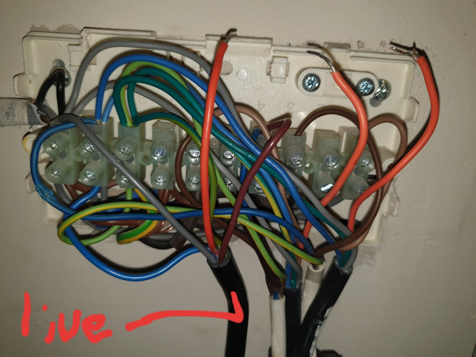

Looks like you have 3 motorised valves ,do you have zonal heating or underfloor heating ?

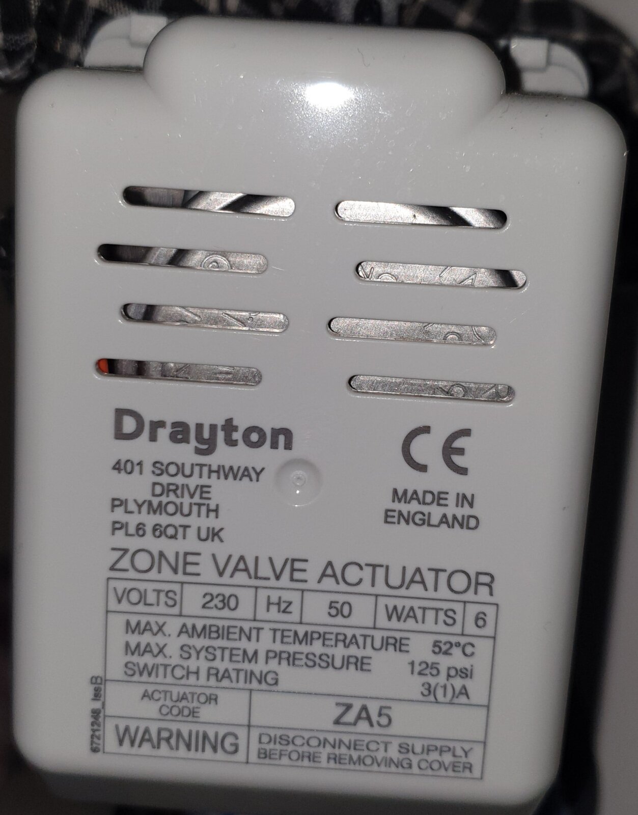

It turned out to be this one which is live coming from the hot water motorised valve! Problematic motorised valve attached below.
Replace the actuator.
That's brilliant @terryplumb. I have now put the two orange (central heating) wires back and left the one from faulty actuator out. Now the heating is working perfectly and going to stand by when demand is off. And showing '0' boiler status.
