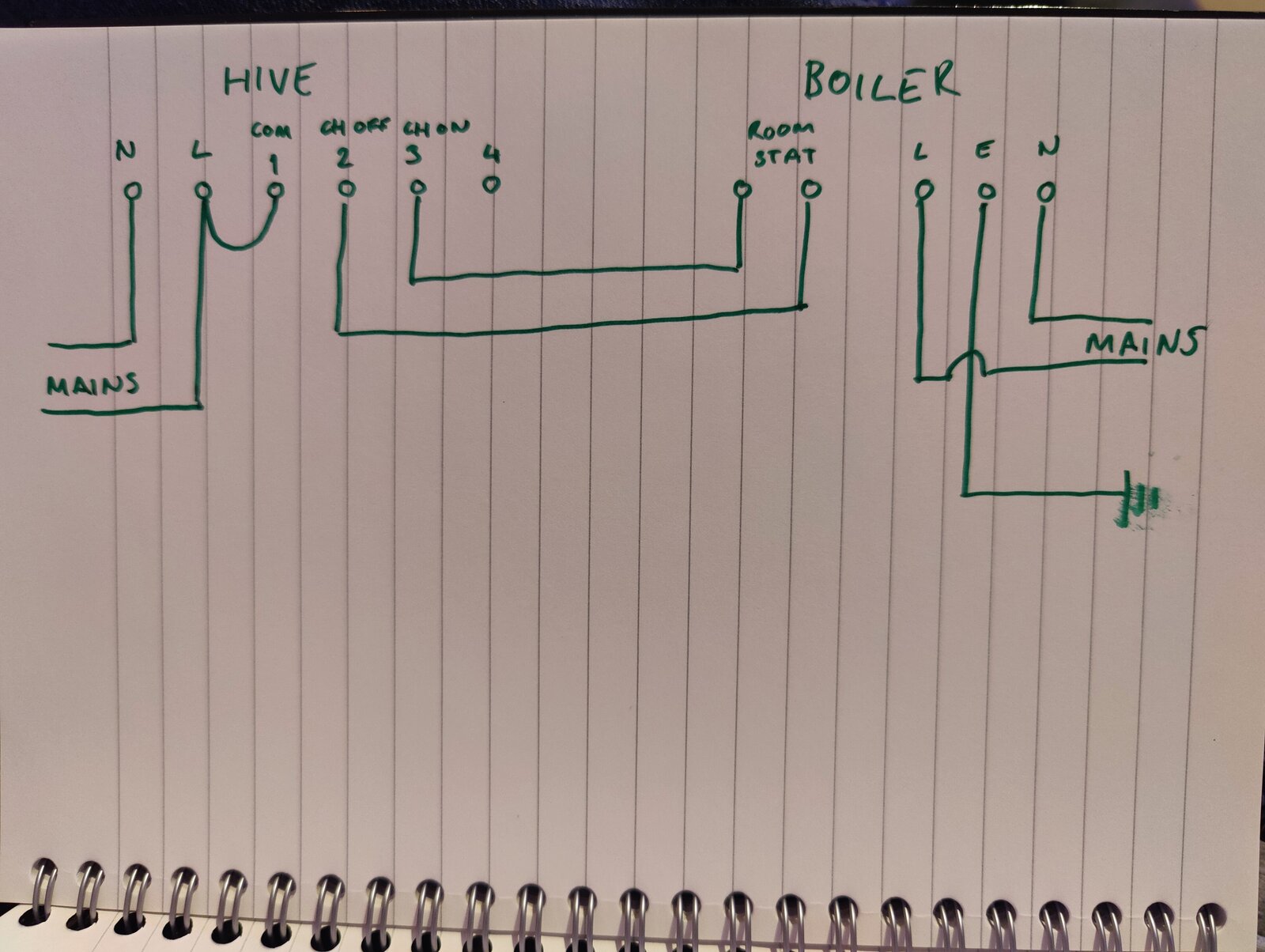

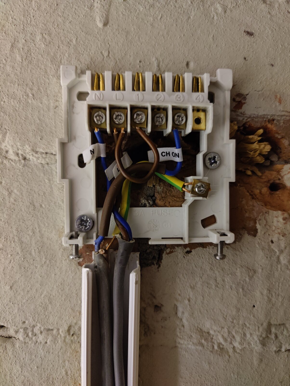

Checked the wiring diagrams, read the forums, and eventually wired up the Hive end with L to L, N to N, a link from L to 1, and the CH ON control wire to 3, as per the photo below, and as the consensus seems to be for connecting these up on the forum.

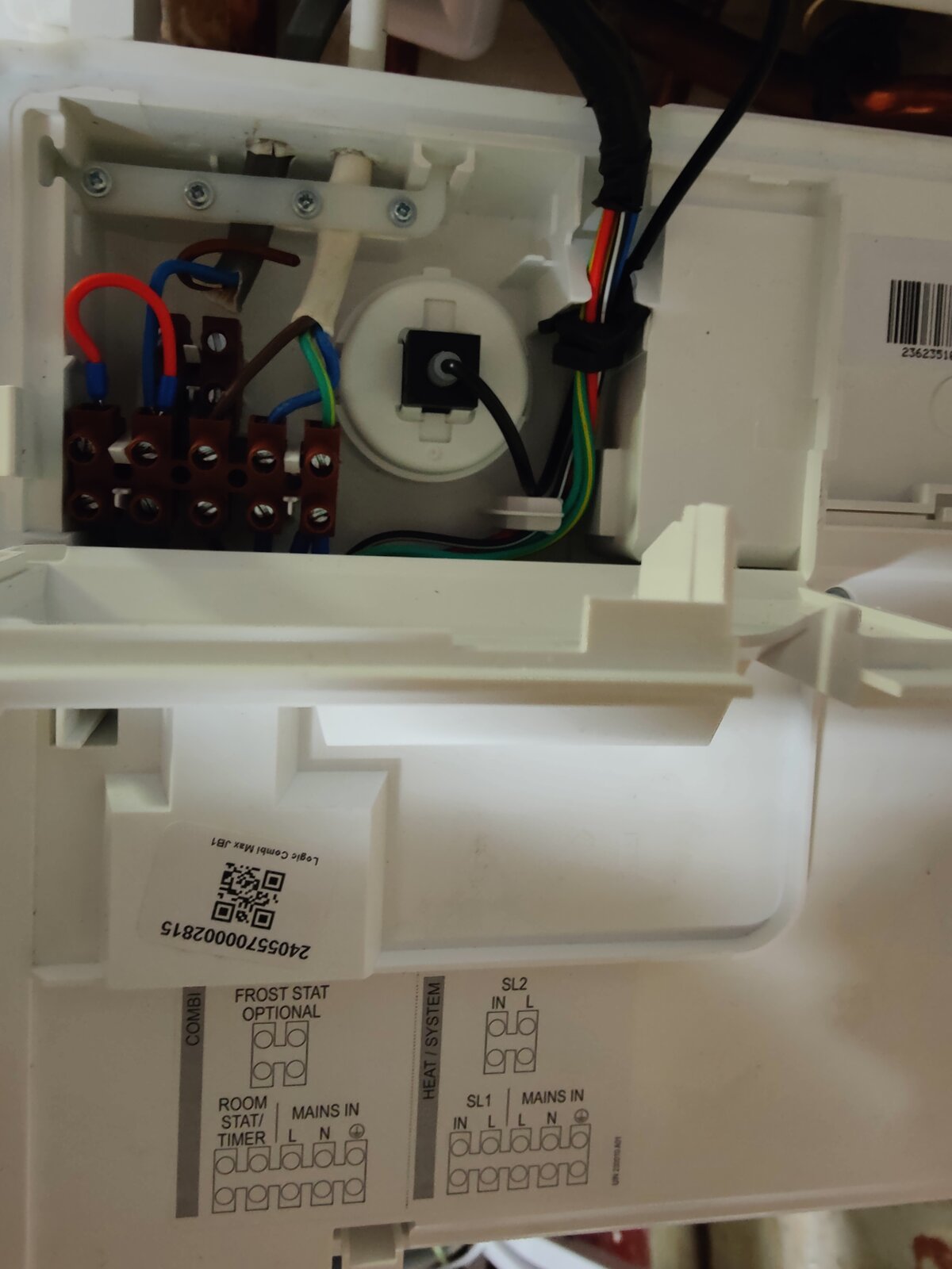

At the boiler end, the terminal block that is the room stat connection has a link loop in it as standard.
Connected the other end of the Terminal 3 wire in the Hive to the Room stat block, as shown:
Unfortunately this hasn't worked. The Hive system isn't causing the boiler to fire up when you press the override button on the receiver.
Also tried taking the 'red' link loop wire in the second picture out of the boiler, but that also hasn't worked. You can see the terminal wiring key in the picture.
Only thing I haven't tried yet is to put the connecting wire in the 'other'/leftmost as you look at it terminal on the boiler.
Can anyone provide me with assistance / a clue as to why this isn't working, as I'm lost. The boiler manual for wiring is useless, as it suggests removing the red link wire and connecting the room stat across both terminals, but nothing on the forum suggests that is correct. I don't even know if it's a wiring issue, or a setting issue on the boiler now.

Or should I link Hive L to Hive Terminal 1, and then run Hive Terminal 2 and Hive Terminal 3 to the double terminal block in the boiler?
Currently, it's wired up like this, which is as I believe other threads recommended, but which isn't working:
I'm now wondering if this can possibly work, unless the boiler defaults to CH Off? Ie unless there is a live signal at CH On, it's off?
My limited knowledge but common sense suggests it might need to be wired like this instead, but this requires knowing which terminal is which on the boiler room stat side (I think):
Or perhaps like this:

The boiler end. Remove the link, as this provides an override (permanently on) controlled by the boiler. So leave the hive as is and transfer the blue wire from the right hand part of the connector block to the left as you’re looking at it. The 2nd picture without a link at the hive is an alternative way, but you’d then need the brown wire connected both ends too.
Right. I shall try that then. Not sure how one determines which terminal on the boiler block is CH On across the room stat, as there's no markings to indicate, but if it turns out to be that simple I shall be happy!
On the second picture, presumably that also relies on getting the CH On/Off matched on both Hive and boiler side, which again, no markings. And if that doesn't require the L-1 link at the Hive, where does the power in that circuit come from?
It comes from the boiler, it works the same way as a switch. Pretty poor there’s no markings, but it’s in the mi’s.

Turns out - and I don't know if this is common or not - but the standard Hive pin-out diagram for the single-channel receiver suggests that the Heating On (NO) signal is on Terminal 3, and that Heating Off (NC) is in Terminal 2. However the circuit diagram actually printed on the back of my SLR2c states that NO is on Terminal 2...
As soon as I realized that, swapped the wires over and bingo! All working!
The system set-up did still need the permanent live loop to Common on Terminal 1 to function however, so it seems that if you're wiring up with both NO and NC connected as per one of the sketches I posted, you do still need this as neither boiler nor Hive Receiver supplies this live-to-Common in the same way the dual-channel receiver does.
