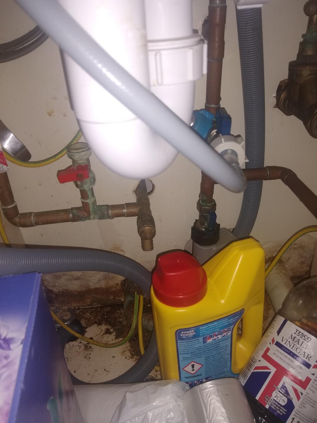

I hear sounds of water that I did not hear (or noticed) before. I do not remember now when this exactly happens (with valves open or closed etc), but I will do again and take note of what happens. The water seems to "gurgle" from a white, wide plastic tub located below my kitchen sink (not the one in picture 2; it is more to the right and not pictured). I also saw hot damp coming out of this pipe (I think) or from a pipe nearby when I tried to have the boiler work some days ago (at that time I had not noticed that I had a beautiful pressure meter below a removable panel, because the panel was very hard to open and I thought it was fixed and I had a boiler with no pressure meter!). The damp came out with a loud hissing sound, as the door was closed I cold not see exactly where it was coming from.

I have no idea what the gurgling white plastic tube under sink is , show a picture !!

"I have no idea what the gurgling white plastic tube under sink is , show a picture !!"
I am in the office now. Once at home I will take a picture and post it.

I now have the pictures of the gurgling white tube (part B) yesterday): The gurgling came from the big tube on the right of the picture here below. The big tube then makes a turn on the left (picture 2) and goes back to the kitchen wall (picture 3), whence a further turn left brings it, no doubt, in the direction of the boiler.
I realise I will call a technician and will most likely need a new boiler (I might post a new thread on this), but I would still be curious to know what was with the gurgling if it is of any interest to this situation and to others.
