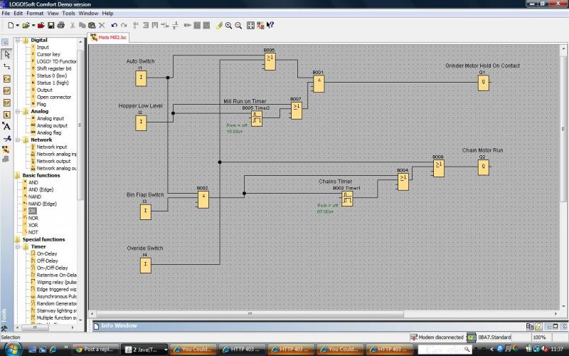

Thanks BG. It is a fairly small and simple set up really, hence only the need of 4 I/O. I have done a bit of design on the LOGO software, I'l upload a screen shot of it below.
Another question, if I have a 240V signal as an input, would that be classed as analogue or digital? This is probabily a silly question, but cant quite work it out! Ie if a switch turns on and sends 240v back and into the I1 of the PLC, to make the out put on.?
The reason I want to use a PLC instead of contactors etc, is because I am keen to learn more anout PLC and programming, and figured this would be a good project to use one on. The job is for my brother, and cost (to a degree) is not so important as I will be learning along the way. Thanks Chris

I make it 6 I/O , 4 in and 2 out.

Ladder code is easier than function block and other methods in my opinion, the software you have posted a pic of looks fairly straight forward but not my cup of tea. Allan Bradley RSlogix5000 and Mitsubishi GX developer (now GX Works) are my 2 favourite pieces of software for PLC's. However these cost in excess of £1000 to buy for the pc.

On the low cost units this may be the case. This is why i ask about the control circuit - it sounds as though he wants to supply power to the motors using the plc, but since this is not really possible, then it makes perfect sense to design a seperate 24 volt control circuit and buy a cheaper PLC
Bear in mind that the PLC cannot be used for the safety control of the mill - this must be done with hard wiring (probably with a safety relay depending on the assessed risk level)

Thanks for all your points. Yes the PLC would be switching contactors to control the motors, and the E-Stop circuit is going to be seperate from the PLC with another contactor. I will look into those other types mentioned - Thank you all!!

For this mill, i think going down the route of buying PC software is extreme, especially if its being treated as a training exercise. Might be best to get the basics by using the handheld/displays on some lower end products.
