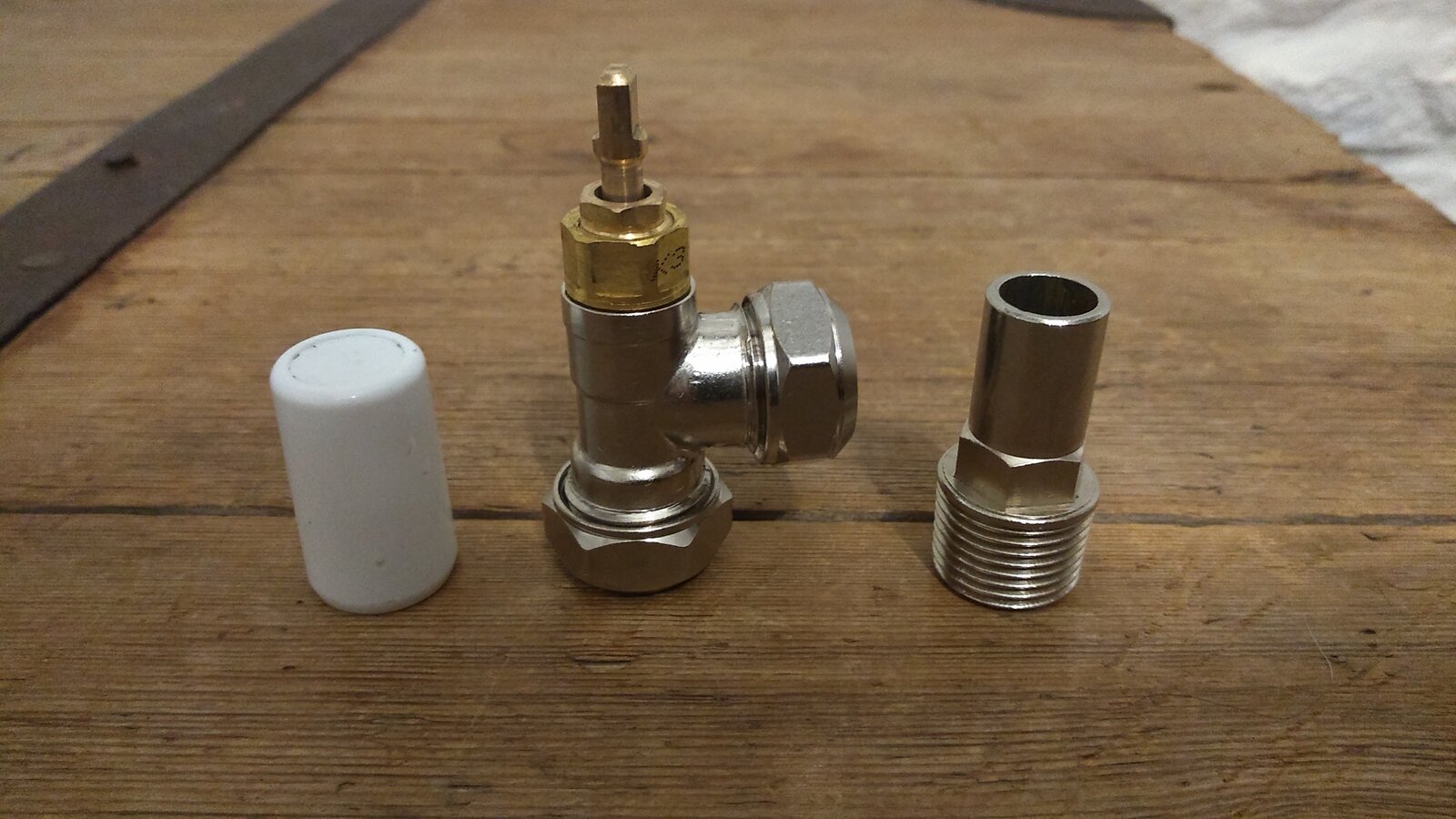

I've just had a rummage and found a couple of these:
To demonstrate my ignorance even further.... They're lockshield valves aren't they? If so, the piece on the right - is that part of it? I have two valves, but only one of those pieces.
Thanks again
The part on far right of pic is the valve tail ,joins valve into radiators threaded port.
The valve is indeed a lockshield.

Have a look inside the lockshield, if the bore is reduced compared to the fitting then it likely will have good valve authority and really make balancing easier.
Sometimes the cheap ones are either totally rubbish or surprisingly good.
