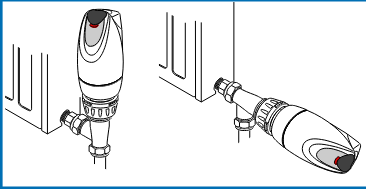

error codes to show range too wide and range too small, the eQ-3 head at £15 has this, so one would hope more expensive models would also have it. Some makes due to length can be rather vulnerable to damage 1771268629784.png1771268629784.png and some are not able to be manually set, one is forced to use an app. There are kits to match them with different bases, 1771268871717.pngsome with more options as to others, but the 30 mm base ring seems to be what most use. I now have Drayton Wiser, which has been working well, but I have only used 4 makes, I at £15 a head would not consider using a manual head, but as to if worth paying more for non-linked heads not so sure. The linked Wiser head means there is no need for any wall thermostats, but having to either bend down or use an app, is not what we all want, the likes of Kasa and Wiser you can combine a wall thermostat or sensor with the TRV head. But size of ones home and design can change if they really help, my last house open plan, I only had TRVs upstairs, one wall thermostat downstairs was enough.
