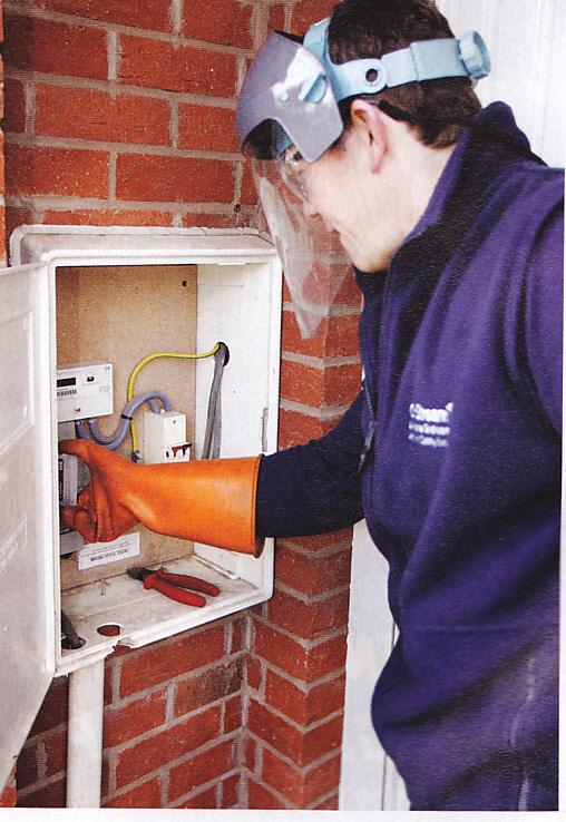

A fault at the cutout could result in a current of several hundred amps, releasing as much energy every 10-20 seconds as a stick of dynamite.
And it is sealed. And its real dangerous if something goes wrong.
Meter guys wear stuff like this, just in case….
full
Although if you have an isolator after the meter, as in that picture, you can turn off the supply there and fit your own meter alongside your consumer unit easily enough,
Do I see correctly - guy working on cutout fuse with CU isolator closed so no guarantee that fuse isn't carrying current
That appears to be the case, although I suppose it's possible that the CU Main Switch is open. However, even if it is, I would personally still want to use that isolator!
In passing, I've watched a good few meter changes in my time and, despite what is meant to happen, I'm not sure that I can recall ever having seen any PPE used when the cutout was plastic!
