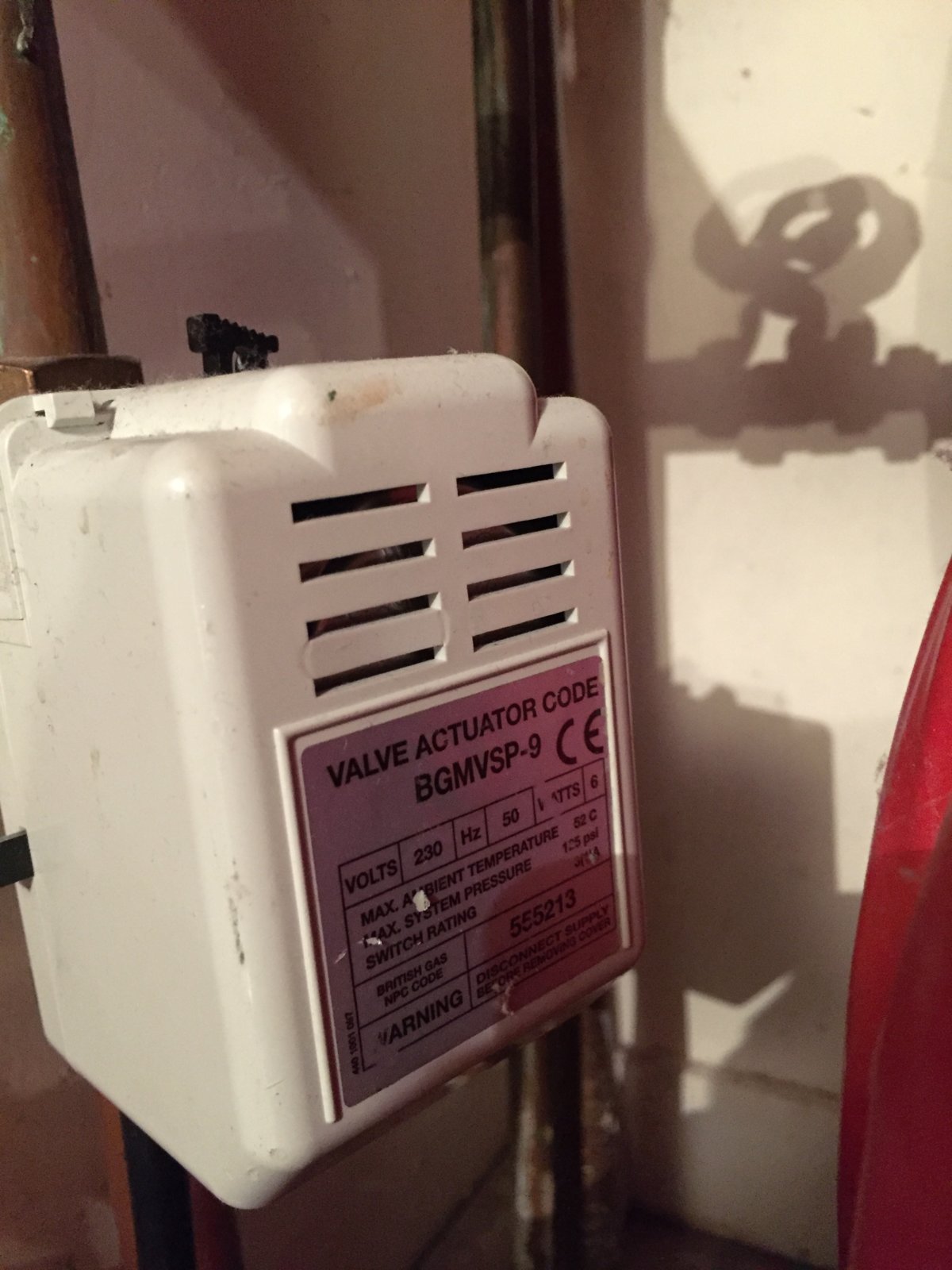

At first glance it does sound like the first system you describe, Stem. The only thing I see in the airing cupboard that resembles those valves is this:
From the side you can see it's a straight through pipe:
There's a black sort of lever switch on top of this, when I move it over, it sounds like it moves some small cogs or small motor or something, but it then returns to its original position (that's all I've messed with at the moment since I don't know what it is yet!). It's wired into a junction box where the pump and thermostat wires also go to.
The thermostat is indeed strapped round the cylinder and looks like an older version of your example (probably something else to upgrade!)

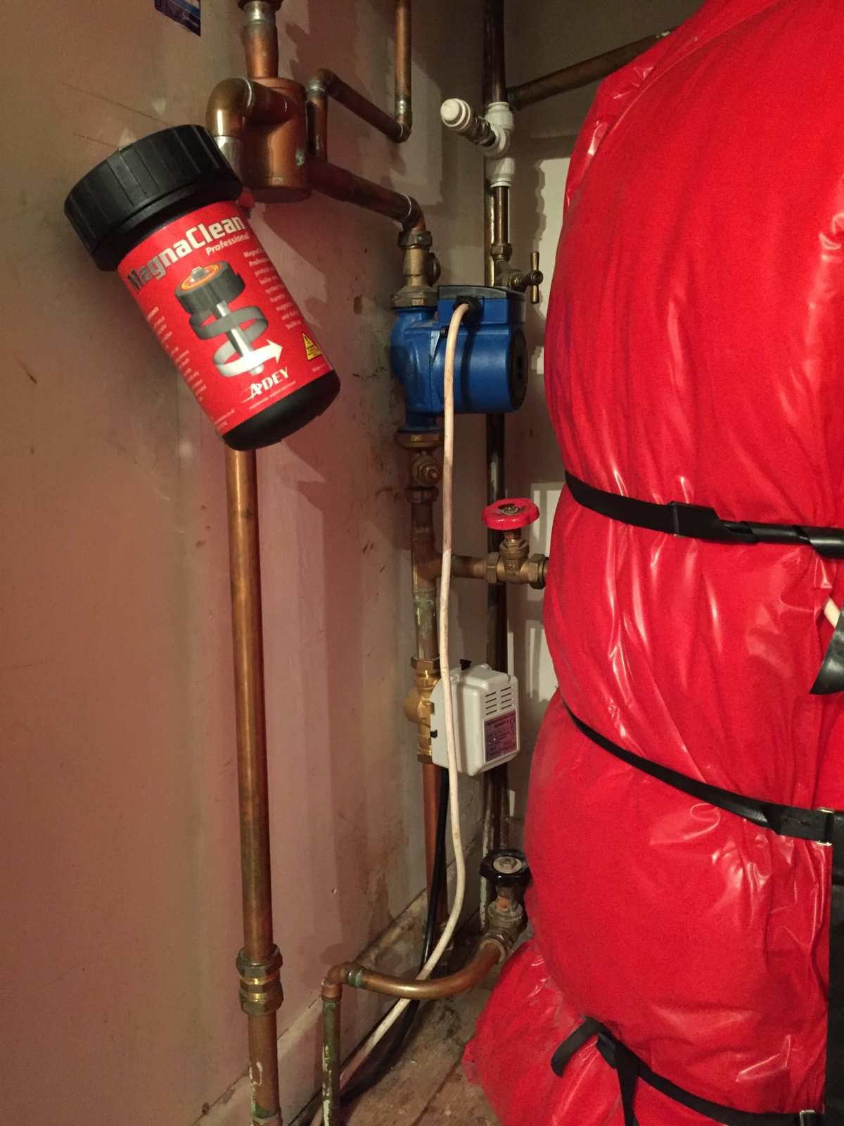

And just for the hell of it I took a picture of the cupboard in general, because why not:

You have a bare copper cylinder and according to your picture just one motor valve.
That means that the water is always being heated when the heating is on, regardless of its temperature.
Not the ideal situation.
It is not a massive job to add another motor valve to the hot water. That would probably even pay for itself in savings after a couple of years.
Replacing the cylinder with a nice insulated one would also reduce heat losses. But a rather longer payback of perhaps five years.

Well that explains a lot! British gas have been messing around with system, you need to get system looked at controls updated & converted to fully pumped system buying a Control Pk will have all what is required, some alterations to pipes in cylinder cupboard and you will have a more controllable system
