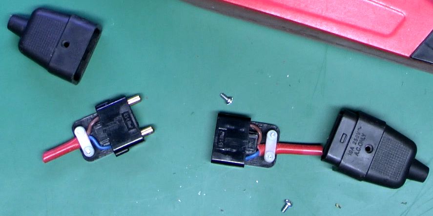

Before jumping to uneducated conclusions, lets go back to the original versions of these connectors which had absolutely no form of strain relief...
I seem to recall they had like 2 pieces of a fibre material and 2 screws that fitted loose in each half to clamp the cable, that was in the early 80's
The modern versions of the connectors look like this inside:
with the part with pins having extra moulded pieces on either side which fit into a matching groove in the outer shell.
That one can only be fitted into the part marked 'connect to appliance', as the 'connect to mains' outer shell doesn't have the groove inside.
Ah that's a result, the item I found a problem with recently had no such groove.

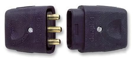

I haven't been able to find a pic of the version I used to use late sixties/seventies and probably into the eighties.
The plug consisted of a black moulding which contained the brass pins which were held in place by the wire clamping screw through the side and were mobile. The cover was a rubber sleeve (shown in orange) which stopped short of the moulding by about about 10mm, the cable end of the cover had no space for the mentioned fibre clamp.
The Socket used a similar moulding which contained the brass sockets and the rubber cover extended such that when mated the covers were in contact with each other.
The cover was held in place with a bolt through the 'centre' hole and a nut.
I used to have loads of the 3 pin version for disco lights etc as they were cheap and smaller than other connectors. I used black covers for mains and white for low voltage (or vice versa), got rid a lot of years back as the wiring failed on a regular basis due to very poor design.
They sound like "Duraplug ones", i will look in the garage i may still have some
IIRC they didn't have a square rear end (cable end) to the cover like your pictures. I may still have some in an old box of crap that I seem to hang on to for some weird reason but it's deeply buried under other junk.
