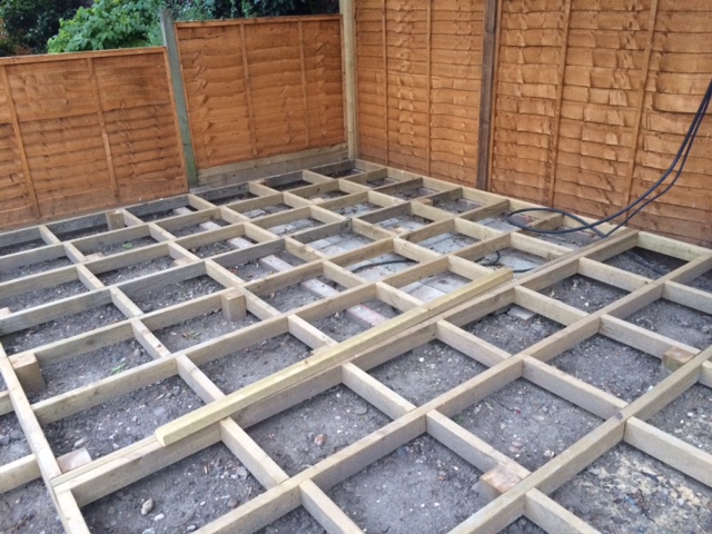

Hi all,
I hope someone can advise.
I built a pizza oven on a poured concrete base a couple of years ago and built a deck frame around it last year.
I had intended putting a shed type structure on it, but am now planning to build more of an entertainment type room.
I am however concerned about two aspects:
1. Strength of deck frame
2. How to insulate the deck frame for the floor
Size of building will be approximately 4m x 5m, 2.4m height, 5 degree pitch roof
Deck is solid, lots of cemented posts.

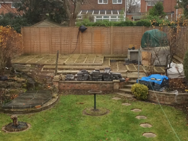

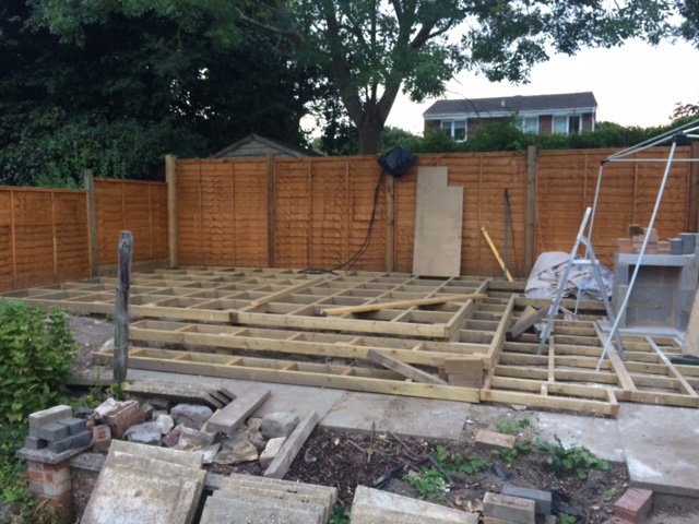

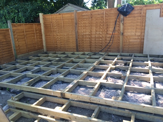

I'll update tomorrow if different, but I think I used 2x4 for the frame and 4" posts. 2nd picture shows all cemented posts (between 1ft and 2ft deep), 3rd picture show additional posts sitting on ground.
Any advice recommended, thank you.

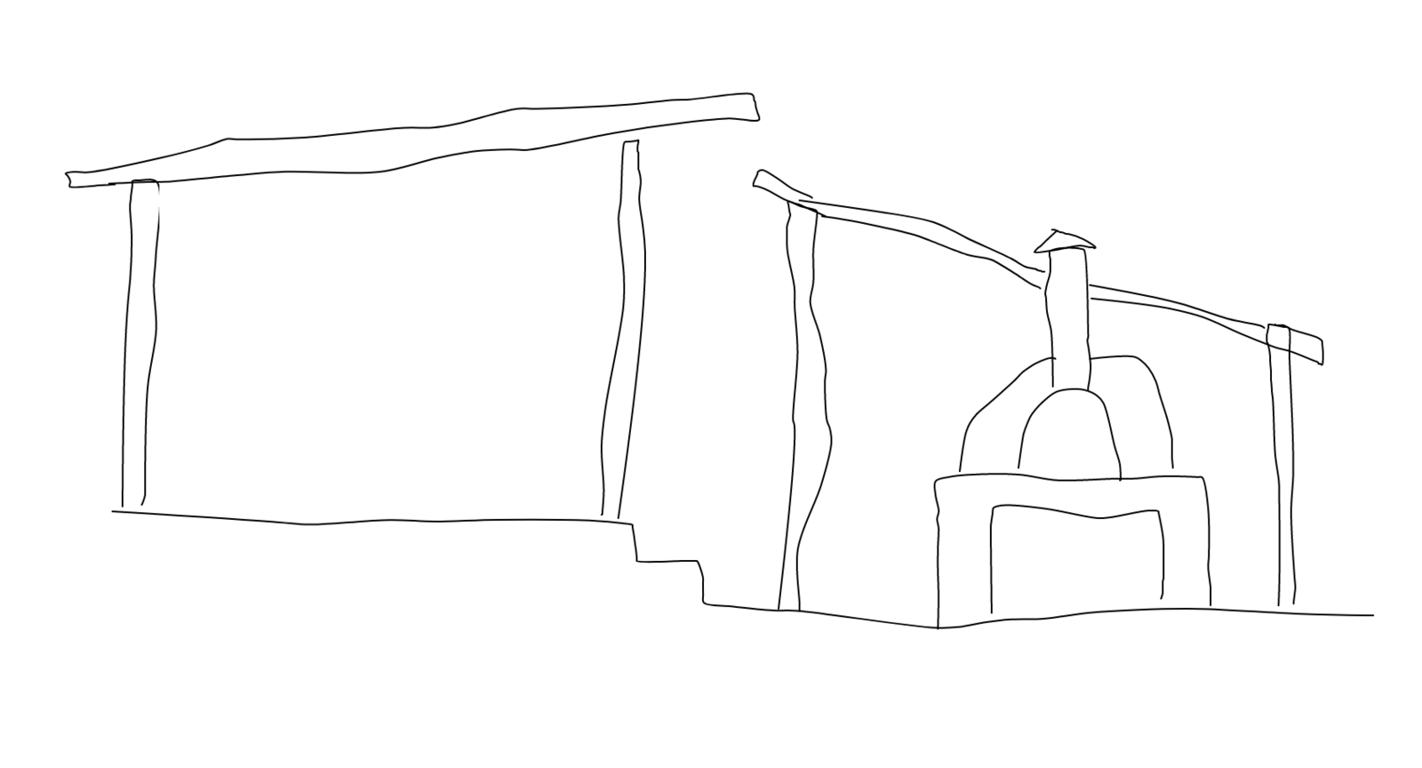

Yes and no...I spent half a year trying to decide on roof type, and how join up the oven building with the main building...and didn't get any further!
So, yes, I am planning to enclose it, but I am still undecided on whether to have it with open walls or fully enclosed. To join with walls or just have it butt up to the main building? The different ground heights of the two 'to be' buildings mean they can't be the same height as the max height I can go within 1m of the fence is 2.4m (to eaves).
One of about a dozen different ideas (probably won't go with this):

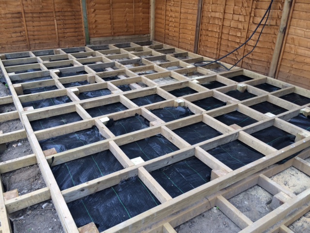

Could I fill the deck with concrete (DPM then insulation then concrete) - good idea/bad idea/would it even work?
Complete waste of time & materials. If you're going to build an outside room then start from scratch. The existing deck won't support any meaningful structure and, when the deck support posts rot, the structure will become unusable.
If you're planning to insulate the slab then what type of heating are you planning? Depending on the size of the room and what you plan to install inside it, you're approaching building regs. territory and maybe getting close to needing planning permission.
https://www.planningportal.co.uk/info/200130/common_projects/43/outbuildings/2
Thanks newboy.
Footprint will be within 15sqm and total height will be max 2.5m, so shouldn't require permission.
I can't go back on the base design (it has to be on the deck frame), so I will adapt the outbuilding to be suitable for the wooden deck frame - even if that means compromising on design.
My assumption would be that any strength I can add to my base by filling with concrete (even if not cost efficient), will give me a little more flexibility on the design.
Not decided on heating type yet, but went to a friends house who had built on an insulted slab, and using a small heater was more than enough to heat the inside (maybe 20 sqm, 2.6m heigh), so anything to add to the ability to retain heat as an open deck frame will not do a good job of retaining heat.
