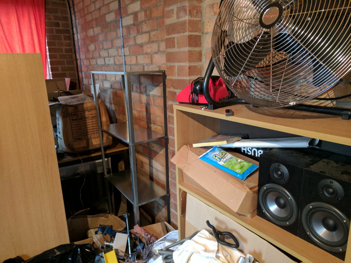

I have a detatched garage of roughly 3 x 5m, which I'm planning to use as home studio. The previous owner started to convert it, by replacing the garage door with a double-glazed three-panel patio door. The walls are a single brick-width thick, and I think there may have been some moisture in the past, as the previous owner used it as a laundry room. I have not seen any moisure in the room in the five years that I've owned the property.

The hope is for it to become a hobby music studio. Most of the music recording will be done on headphones, so I'm not looking to soundproof properly, but a bit of a reduction would be good. I'm really looking to keep the warmth in a bit, rather than letting it straight out of the open ends of the roof. At the moment, I can reach over the top of the bricks and my hand will poke down behind the fascia into the open air. Insulating and boarding the ceiling is an easy win, but I'd really like to do something with the walls as well.
