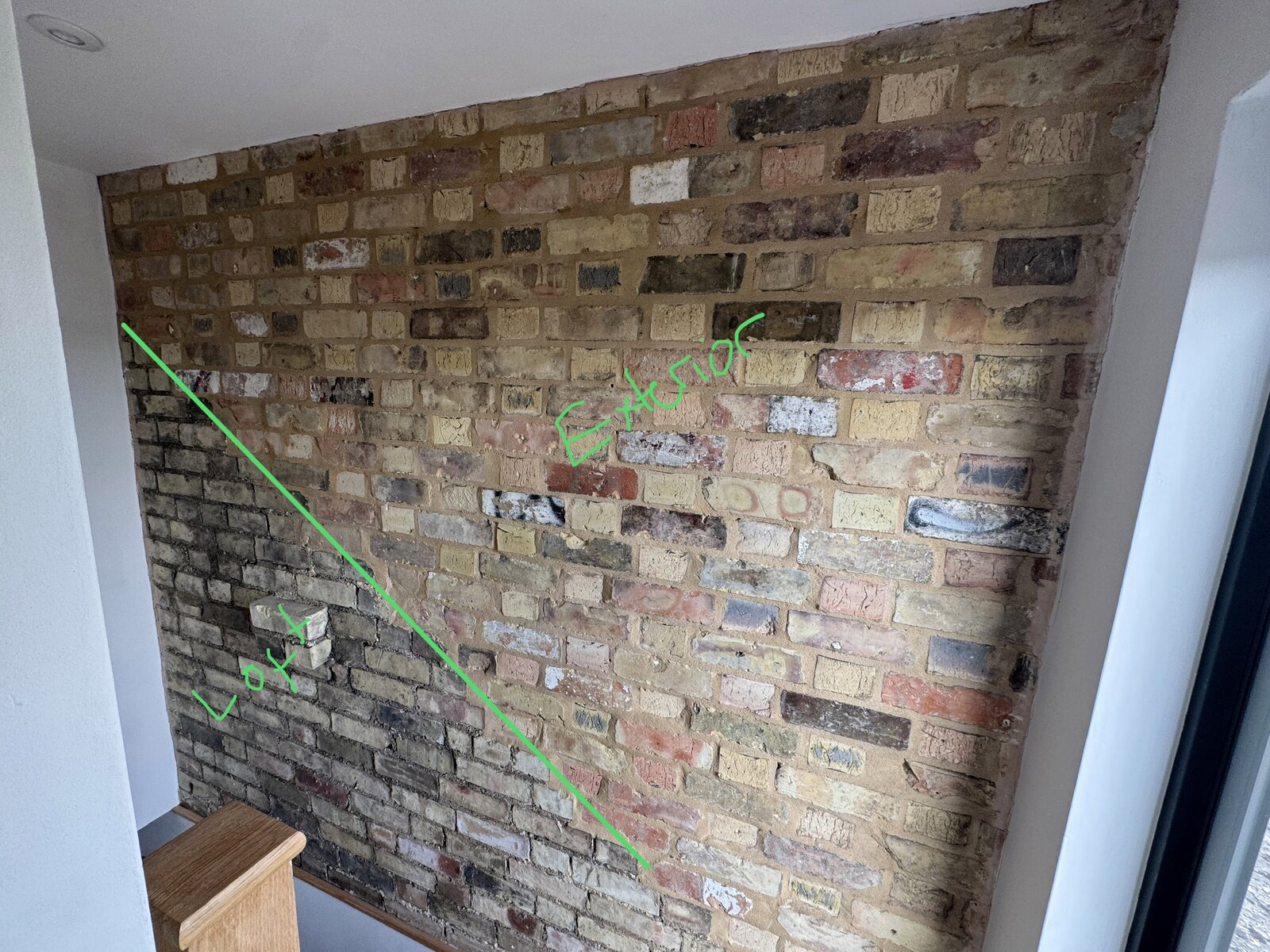

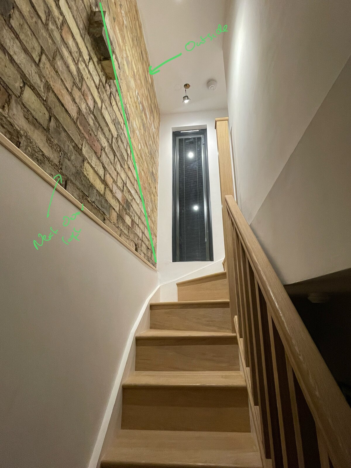

Having inspected the wall, there are some salty deposits coming through and I *think* there are some slightly damp patches - water coming through the brick from outside. But very, very small amounts. Never any water on the stairs below.
I’d really appreciate a final bit of advice.
I’m wondering again about using an internal brick sealer / tanking slurry onto that small area of outside brick, just to make sure to stop any ingress from outside in.
So brick sealer - stud wall (roofing battens) - infill with rockwool / celotex - DPM - plasterboard.
This obviously has no air gap.
I cannot get to the outside wall to seal it from there - it’s a 2nd story, pitched roof.
Would this work? I can’t tell if the brick sealer is a good or dumb idea. I just want to avoid it going mouldy back there.

Ard you sure that's a half brick wall? The brick pattern suggests otherwise - or there'll be a load of rough snapped bricks on the other side.
The waterproofing is a good idea, but you'd be better foaming PIR bonded plasterboard on rather than stud walls.

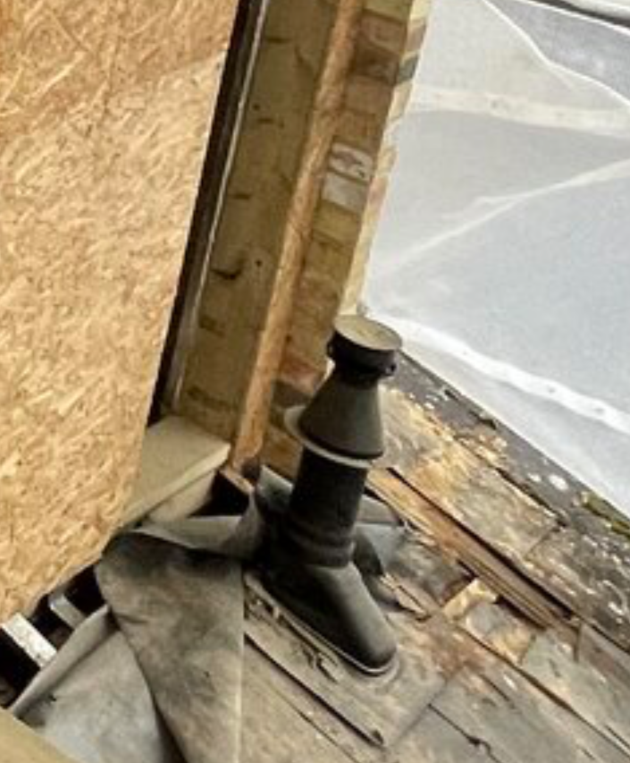

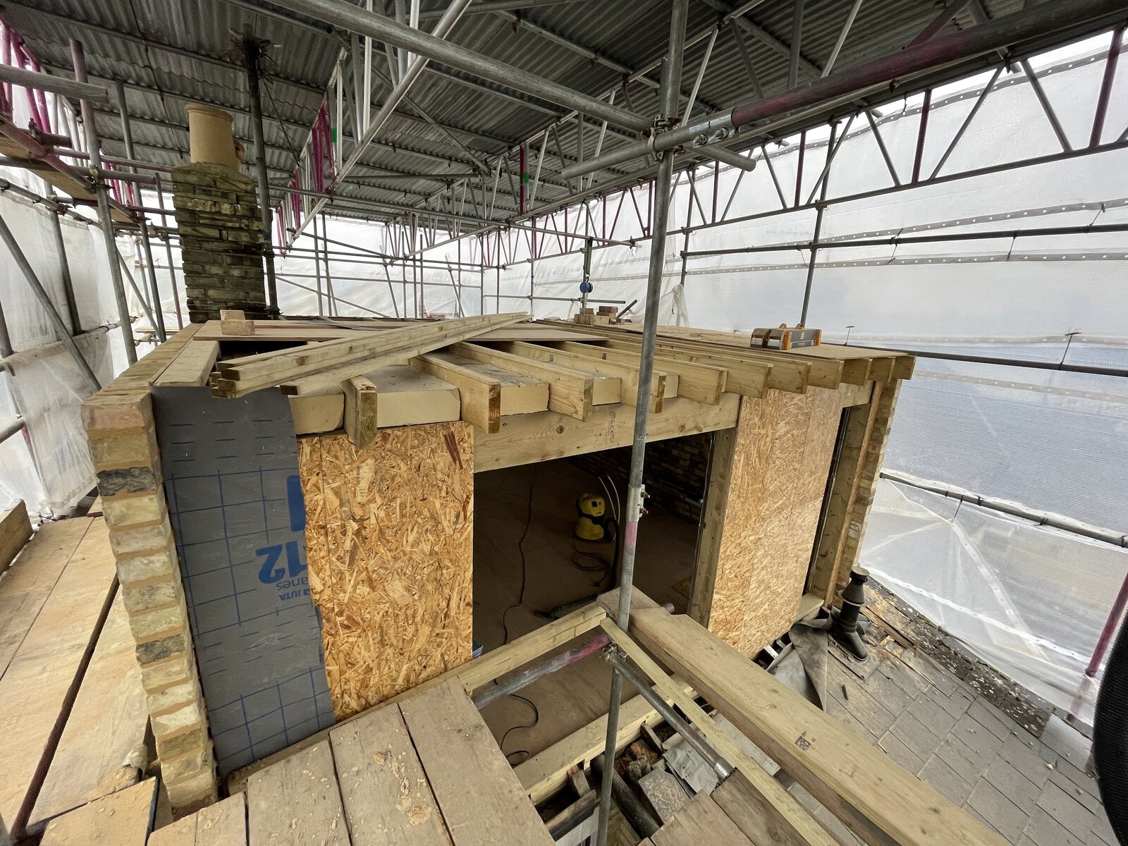

I’m pretty sure that is the case yes. I’ve attached a photo of the opposite side which is identical - so yes I think there are a bunch of snapped bricks in there. That part of the wall isn’t visible from the outside.
Glad you think internal waterproofing is a good idea. Any recommendations for a product?
And why foaming on insulated plasterboard instead of a stud wall?

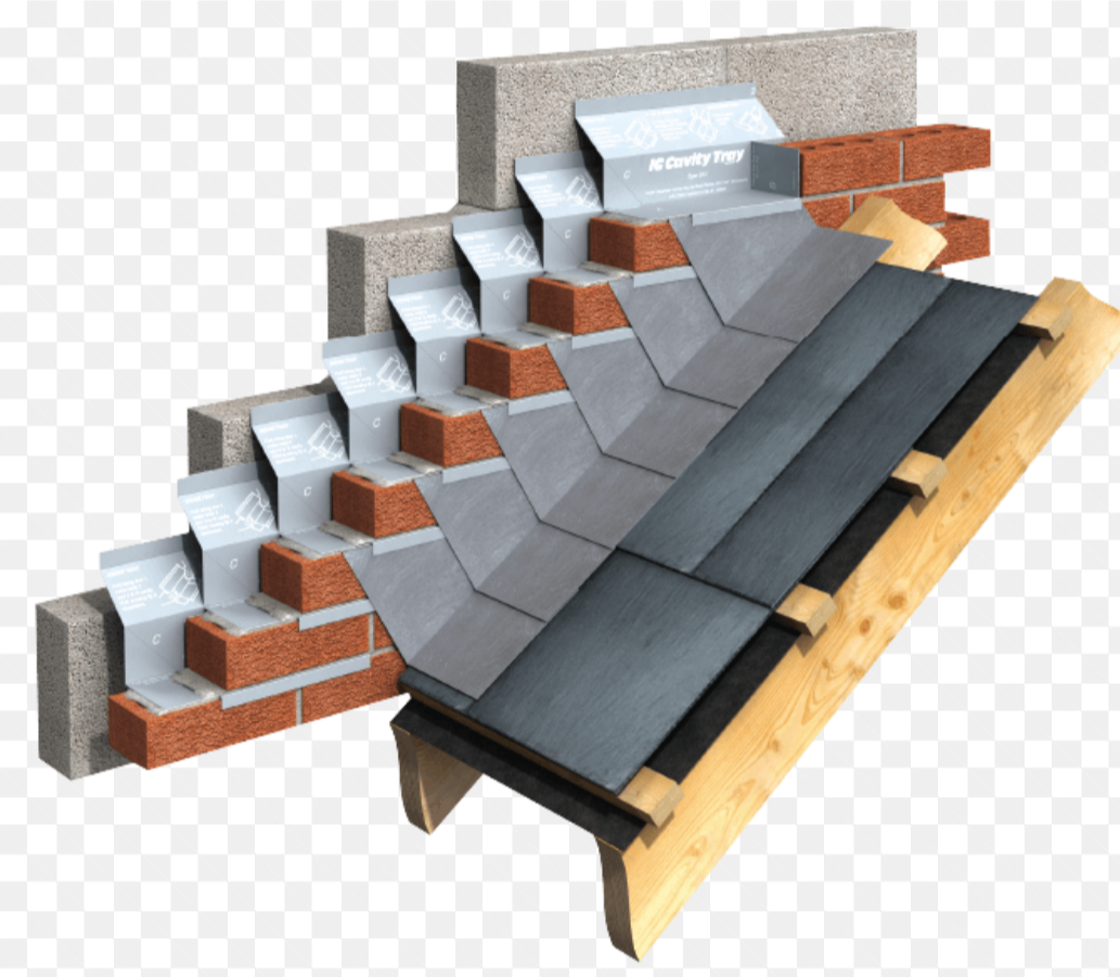

A few coats of the Thompson's stuff. Foamed PIR is an effective vapour barrier, the foam doesn't allow moisture to cross and you'll get a lot more insulation with the limited space you have available (current regs would demand around 100mm). You still have the potential issue I highlighted earlier of water travelling down through the brickwork, which is why you should have a dpc somewhere around where your green line is, to direct it outside.
This is a typical detail, where the DPC is formed using cavity trays in conjunction with the roof flashing - water soaks/penetrates the outer skin, runs down the inside and back out. Obviously you don't have the inner skin!
