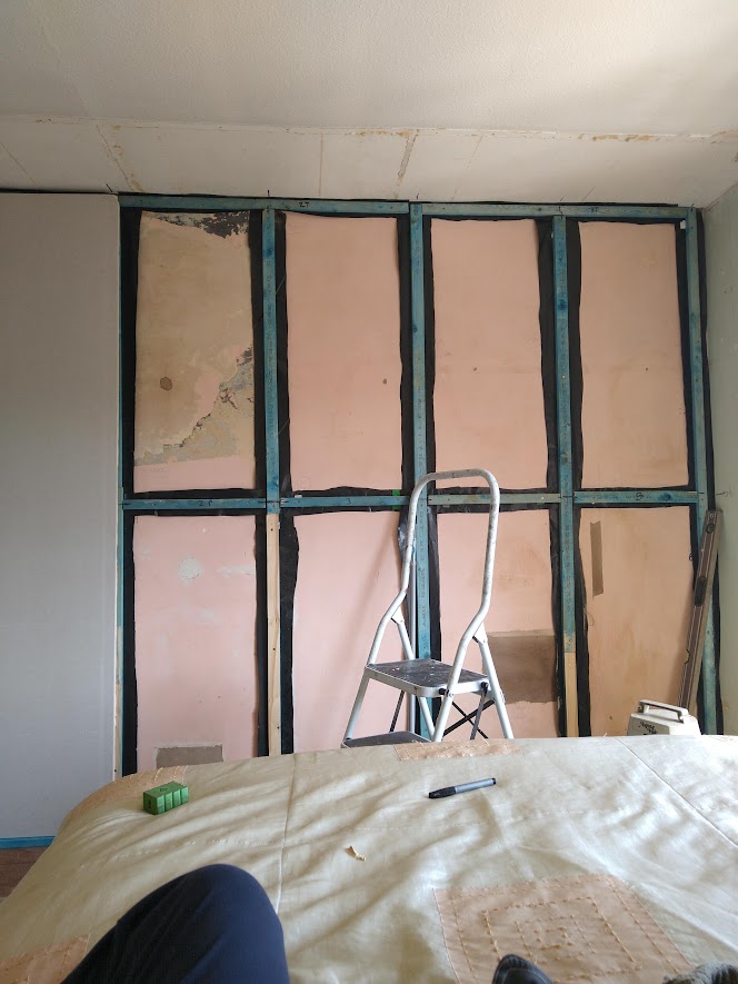

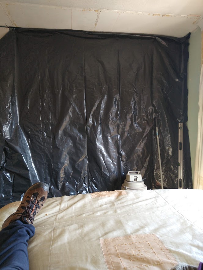

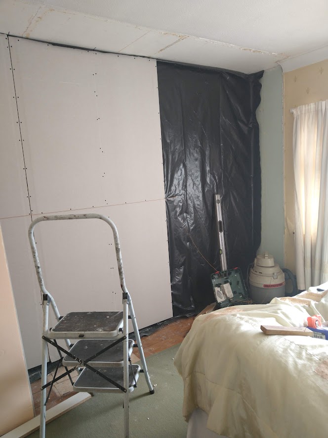

Notwithstanding the insulation aspect the main issue/worry appears to be moisture occurring due to warm air condensing on the cold brick inner surface or moisture coming through the bricks. If you fixed a single piece of polythene on the exposed wall with battens then although moisture could come through the bricks from the outside (only on the exposed section) it could not travel any further and, unless you have torrents of water coming through, would reside in the bricks and dry out in warmer/drier weather (bit like a brick wall does when rained on). Without any insulation moisture carrying internal warm air would condense on the plastic sheeting, putting up insulated foil backed plasterboard would prevent any moisture laden air getting through to the surface of the plastic sheet and condensing. The main challenge is making sure that no moisture can get past the insulation and to this end as well as relying on the foil it would be prudent to fix another single piece of polythene on the battens before fixing the insulated plasterboard. Of course using battens 25mm thick adds to the encroachment into your stairwell space and may not be acceptable. The space between the battens could be infilled with insulation and normal plasterboard used for the external surface although this approach would give a lesser U value, but if you kept insulated plasterboard it will give you a higher U value.
I attach pics of something similar I did in my bedroom a couple of years ago although my wall was one brick thick non cavity but was not to concerned about external moisture coming in and the insulated board was not foil backed. Whatever you do its a leap of faith I guess, good luck

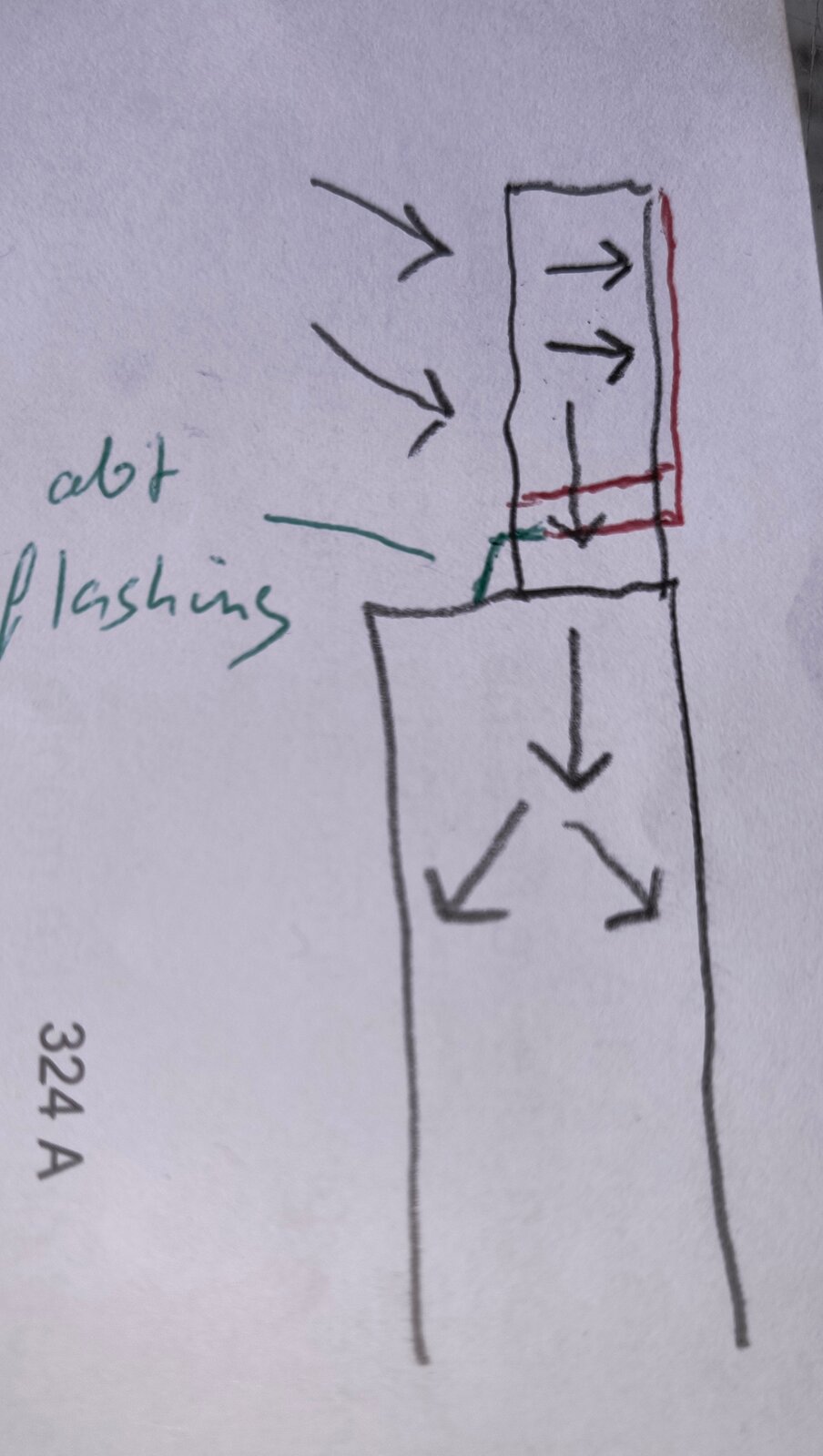

I'm pretty surprised that the wall above the green line isn't wet, and that the wall below the line isn't damp, and that the other side of it (in your neighbours loft) isn't damp. Those bricks must be good.
You could try tanking internally down to the roof abutment but then you're left with water penetrating into the party wall below - I know people mock it but maybe some of that DPC cream injected level with and one course above the stepped flashing from your side of the wall.
