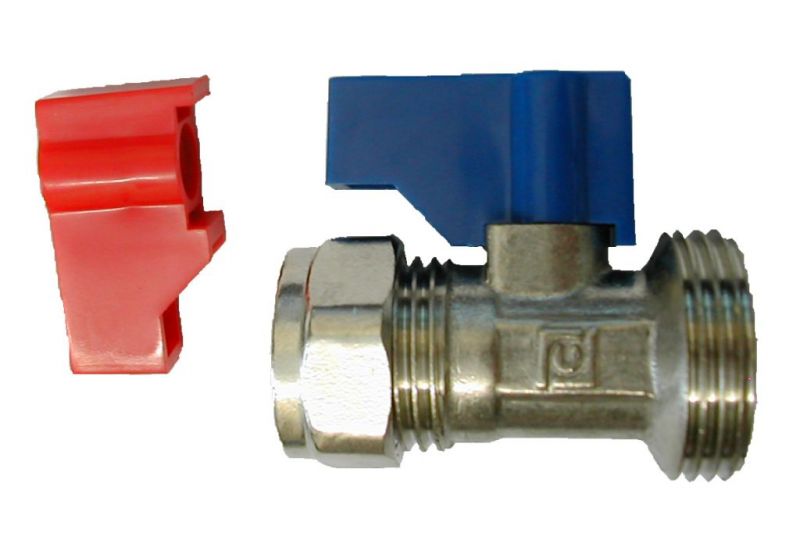

  7. What's this then?
    [​IMG]
  8. Wally©
    Wally©
    Joined:
    21 Mar 2017
    Messages:
    12
    Thanks Received:
    2
    Country:
    Belgium
    An aquastop...:)
