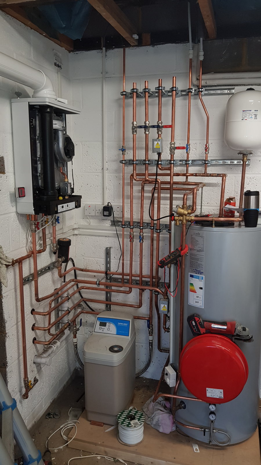

The Eco RF. Like this one ;
I
@Notch7 what Dan said. The ECO RF is a multifunction boiler - it can be either a combi or a system boiler, on sealed or open vented systems.
That's a good looking Job, is it yours Dan. I'm only a DIYer but appreciate the time it takes to plan the layout then execute the job leaving it accessible for future service/maintenance.
Yes, it's one we completed a couple of weeks ago.
It has two zone opentherm heating with hot water priority directly through the boiler.
Total efficiency and simplicity.
If you want opentherm id go for the intergas rapid.
Half the price of the eco with all the bells and whistles.
