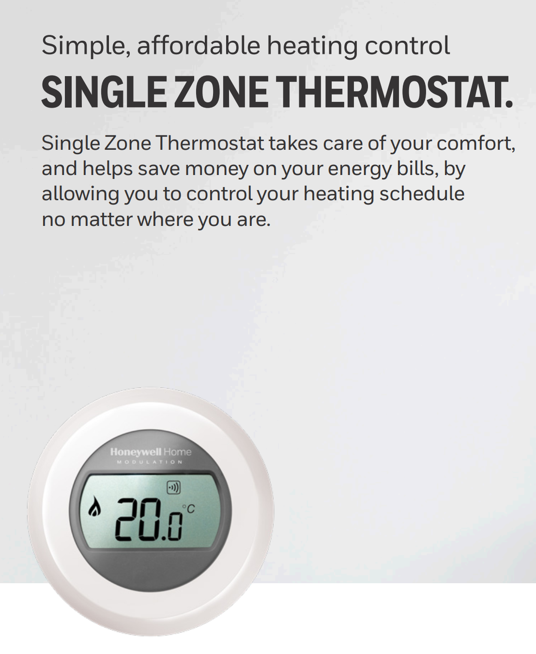

Not really correct, there is but we wouldn't support it with a different brand boiler. It's made and set up for our own boilers and is simply battery RF from stat to powered OT/ON/OFF receiver.
Not being an expert with evohome could not the round stat be bound to an OT bridge Muggles?
I stand corrected, on both counts - I'd forgotten about the round stat!
Do yous mean this
I don whan no steenkin bridge.
I dont want another bleepin box screwed to the bleepin wall with another bleepin socket or FCU used and more bleepin cables.
