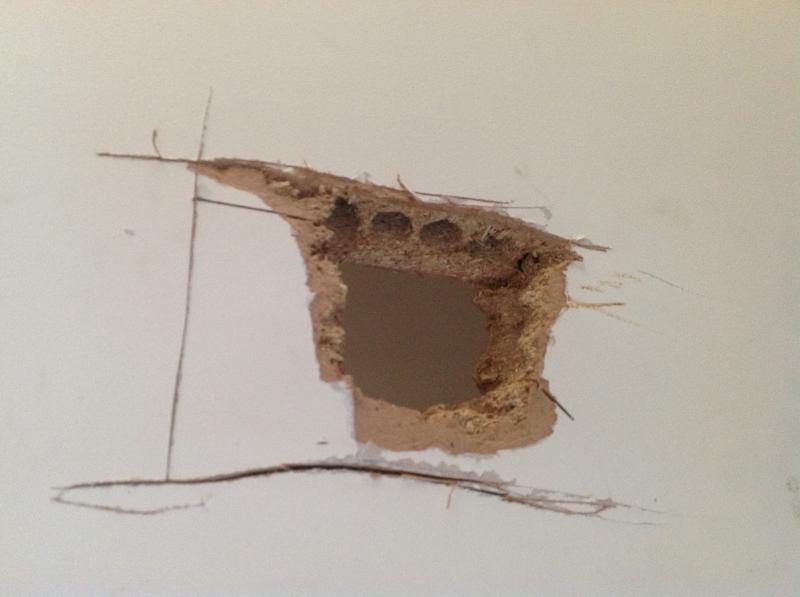

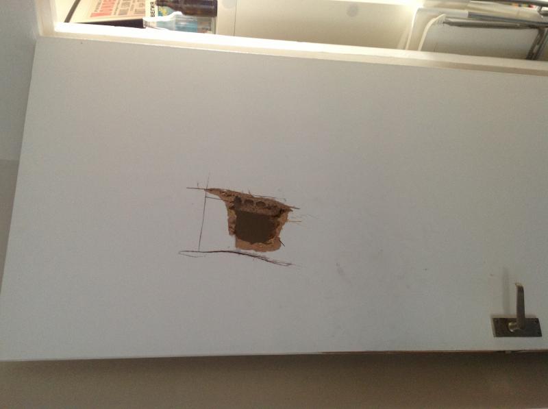

Hello there,
We had an incident where an old table surface managed to completely block our kitchen door from the inside... Short story is that now we have been left with a big hole in our door ( that we made to open it again) and I'm unsure wether I now need to buy a new door or not....
My questions are:
- is this possible to fix without buying a new door?
- if I have to get a new door, what am I looking for? Is this a hollow core chipboard door?
Also the dimensions are a bit weird 1918mm x 703mm...
Any help would be greatly appreciated! Pictures below....
the way i would tackle that hole would be to push filler into the hollow edges and a pyramid shape 10mm high on top
i other words the hole will look the same shape but 20mm smaller
then when dry add another 10mm all the way round again in the same triangular shape
only mix up enough filler for each step
If you can, push some expanding foam into the hole under some of the cracked ply etc. pull back slowly to fill hole. After the foam has set cut of with either a flexible knife or a fine hacksaw blade, a we bit under the level of the surface, fill with glue/sawdust or glue and standard white filler, smooth off when completely dry trying to emulate the finish of the surrounding door face...pinenot :)

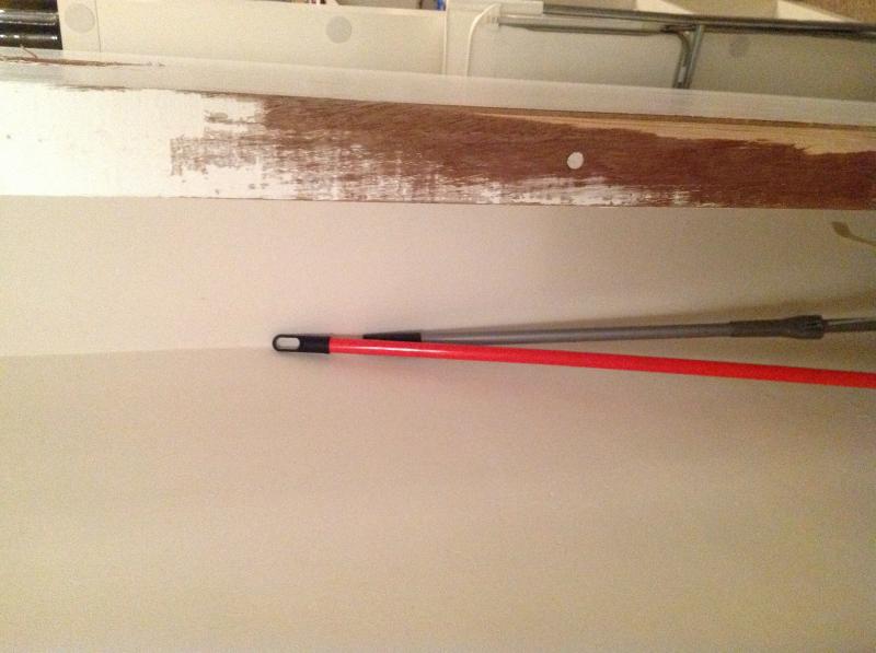

Need to confirm some things first, it looks like a fire door and if it's the kitchen pass door that's most likely. You can check this - first what thickness is it? secondly are there any normal fire door indications i.e. any let in intumescent strips, or small round/coloured buttons along the edges?? ...pinenot :)
Hi Pinenot, the depth of the door is 44mm. Not sure about the strips or buttons though? There was nothing around the frame. I took another picture of the side of the door if that helps...
Thanks in advance!
Yes that's a one hour fire door. The peg is an intumescent expansion peg, designed to swell and lock the door in the posts when the heat builds up. At 44 mm that signifies it's most likely a one hour door.
These are available from Wickes (just one of many retailers no doubt) depending on size from £ 30.99. To comply the door should be fitted with some form of self closing/latch devise and fitted in suitable frame...pinenot :)
My Advice
Don't even try to fix it! It's a fire door! replace it
+1, now that we know, buy a replacement.
It will take about half a day (setting up/down checking everything etc.) for a good tradesman, so expect to pay around £80 - upwards - for a proper job. You are going for a like to like swap over, so know need for smoke seals etc. if there not part of the existing, but you must have the self closing ironmongery refitted - closer, Perko or whatever and reuse the hinges if they're in a good enough state...pinenot :)
I know that you are replacing the door but for what it's worth the easiest way to repair it would have been to pin a piece of hardboard over the entire face , both sides of course , and repaint.
