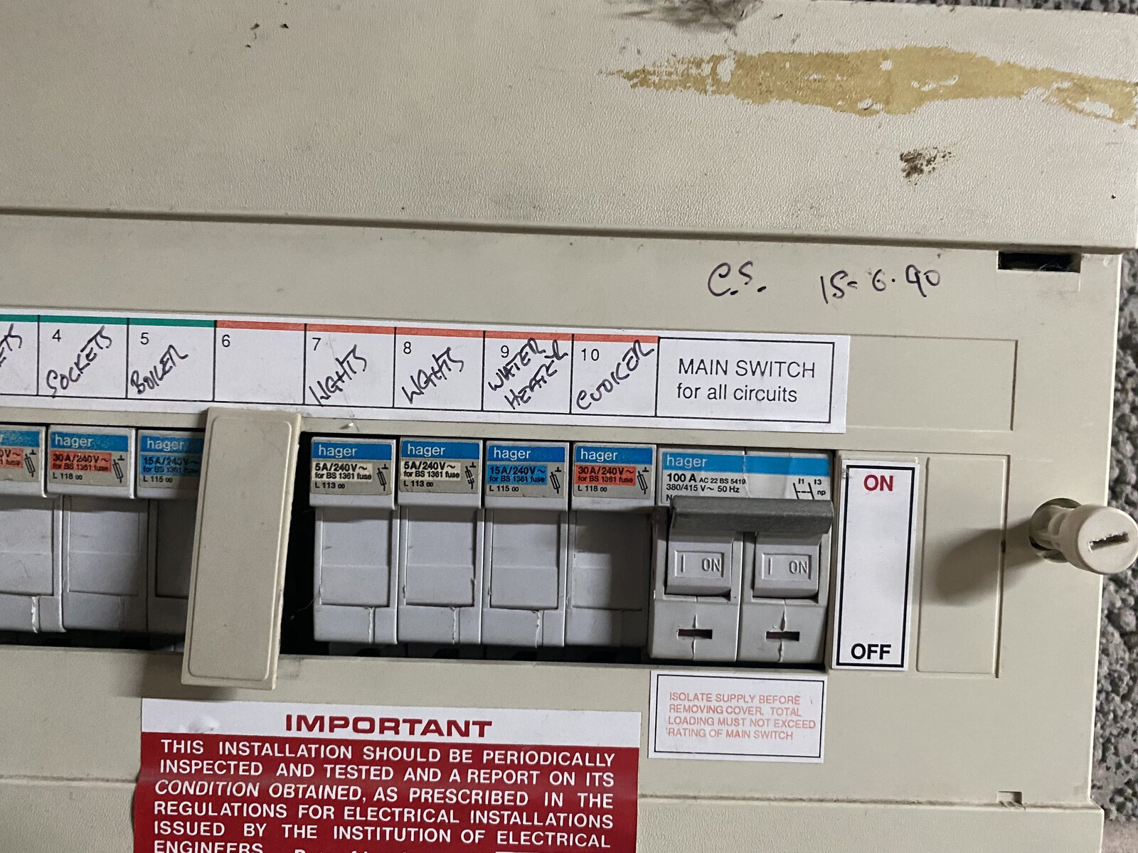

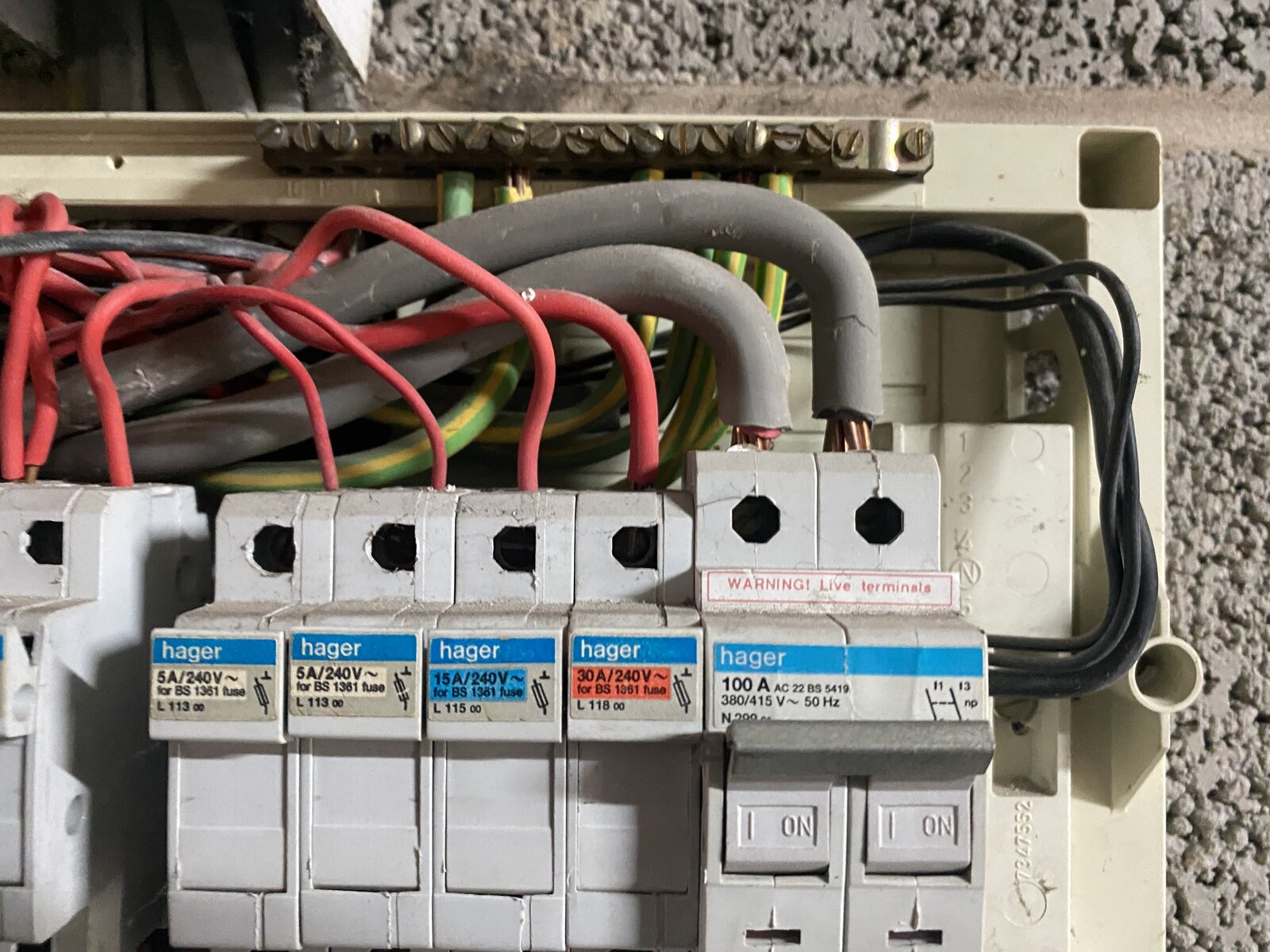

Replying to my own thread to prove I’ve got friends
Photo of fuseboard included
Immersion feed is number 2
Cheers
Lee

The circuit will require RCD protection, which can be achieved by changing the fuse to a RCBO.
You don't need any isolator installing to do that - the main switch in the consumer unit will isolate the fuses in it.
However that consumer unit is life expired and should be replaced anyway.
