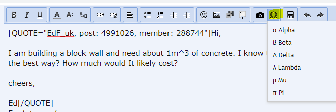

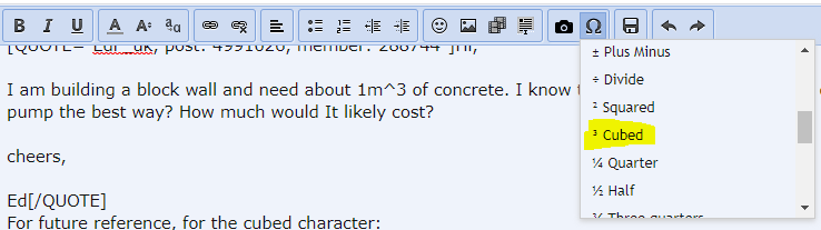

For future reference, for the cubed character:
and scroll down:
Thanks. I've been 1/2 wondering how people do that for ages!
