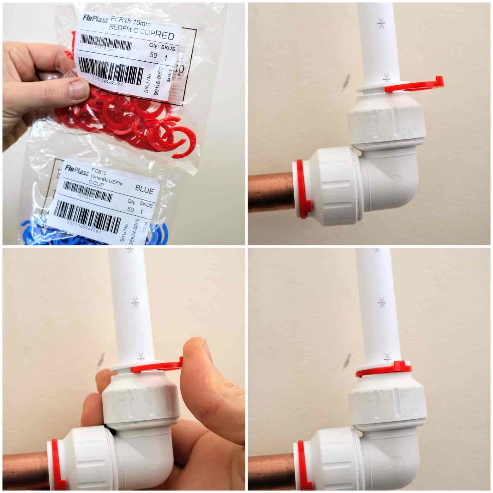

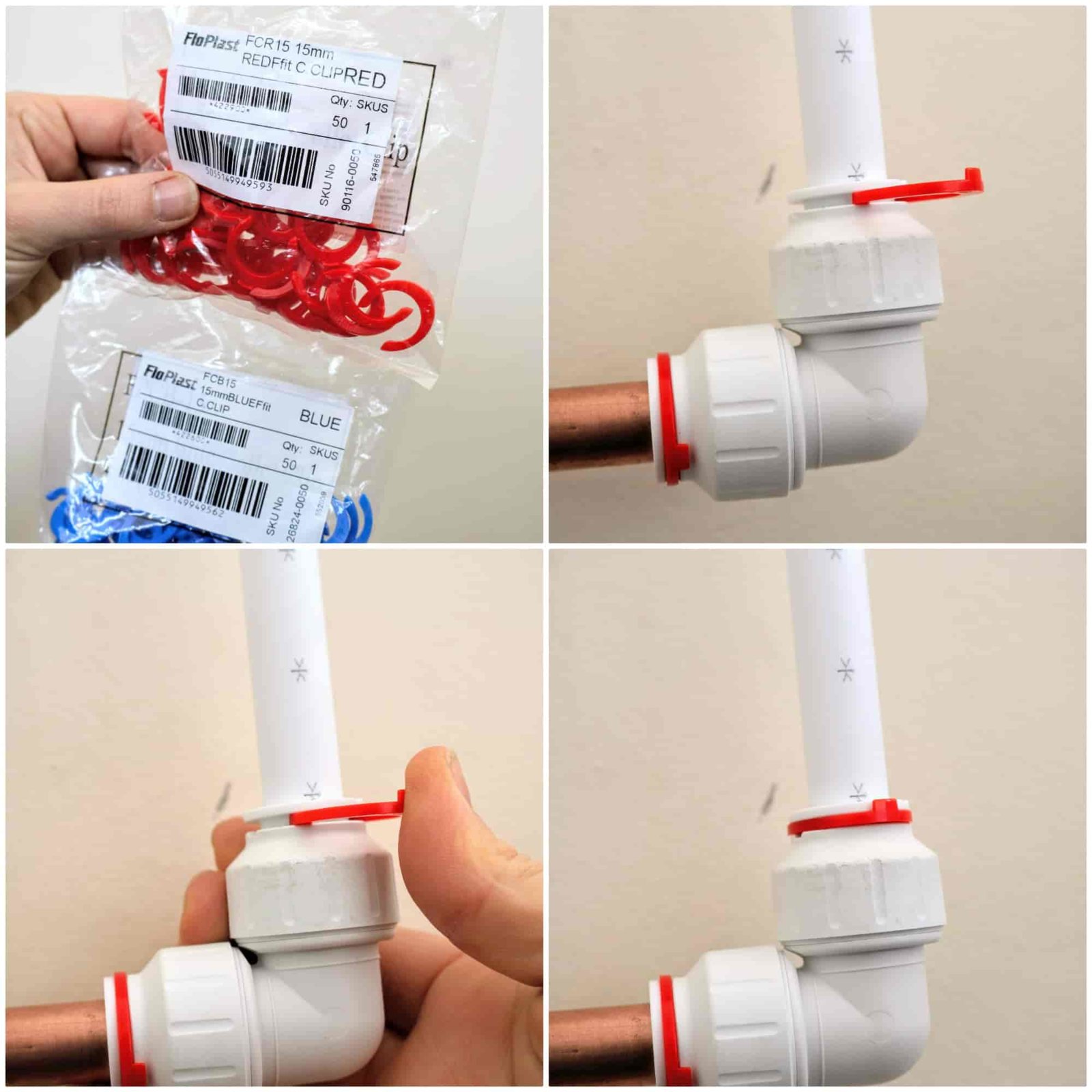

hi I bought a house with speedfit plumbing , mainly their pipe , few compression fittings used too.
Not sure how old it is
I noticed on all the fittings the threads we’re slightly loose.
They weren’t leaking, but are they just working loose from slight vibration of the water flow ?
And are they generally safe ?
Hi yes they're generally safe, is it the compression ones loose or speedfit?
If I have to use pushfit, I prefer the newer Speedfit for ease of installation and adjustment (without the need of a removal tool).
The compression factor also adds a layer of protection and enables removal of inserts from the fitting, for when they come off the pipe during modifications.
However, I have come across many that have not been tightened up by the original fitters (I've always believed this to be because the original JG speedfit just pushed on and those using them failed to adjust their install procedure for the newer "compression" versions!).
I've also seen the compression "nut", on a fitting, become loose/unwind when manipulating a length of pipe attached to it, scary if that fitting is in a space, hidden from sight!
I've always thought that they should redesign the compression nut so that it clicks and "locks" in position when tightened up properly - should be fairly simple to achieve this design-wise.
Locking "collets" are available but they're, yet another, fiddly component to have to procure, stock and carry with you!

Thanks, I’ll get some of those locking collets to be sure they are safe.
