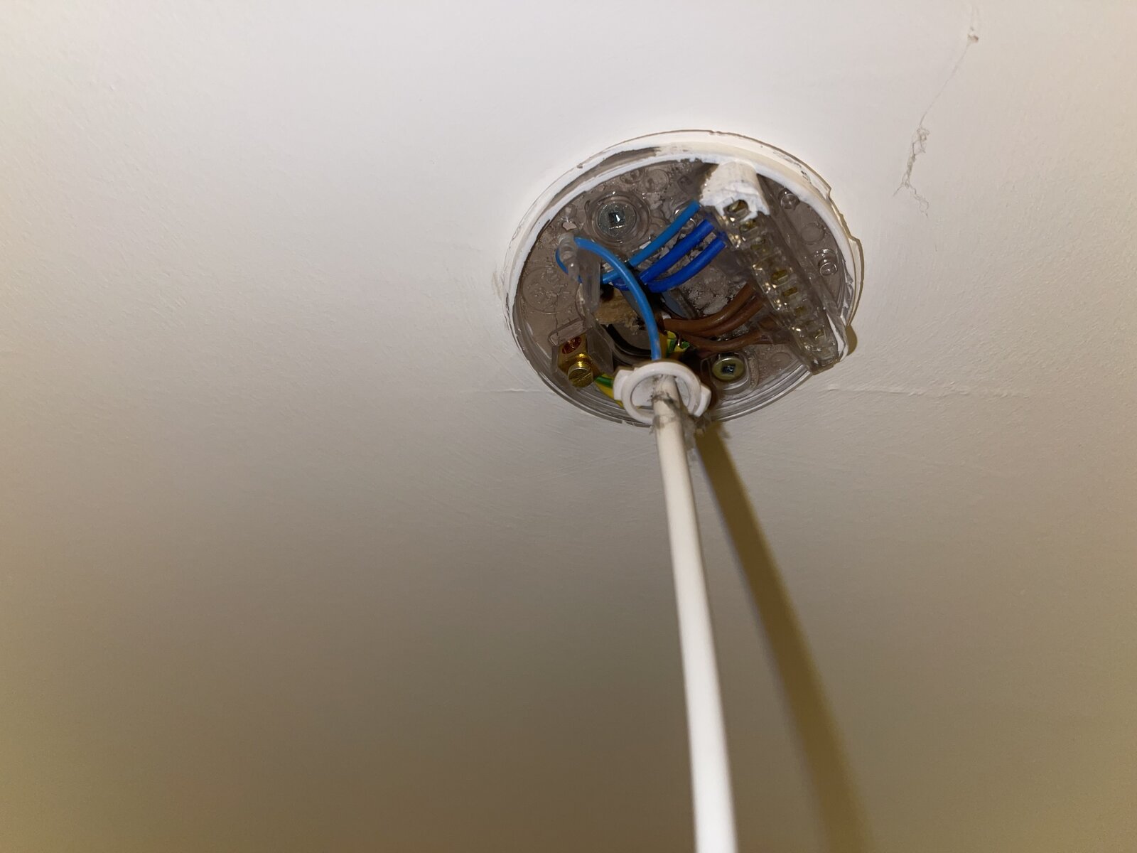

Hey guys,
As the title asks, is this a straight-forward install for a handyman or would I need an electrician? I am looking to replace the top fitting with the bottom one. I am just not familiar with the bottom one's wiring.
Thanks.

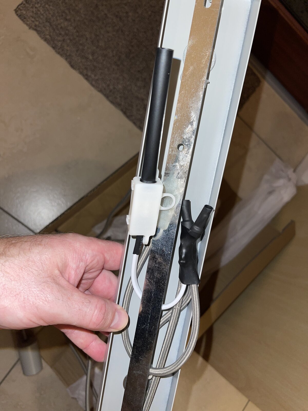

It SHOULD be relatively simple.
HOWEVER, the new fitting is so badly designed that to get the wires from the ceiling into that silly connector box - you or anyone would struggle to do it CORRECTLY AS INTENDED.
You did ask...!
You did ask...!

Sparkwright's answer is 100% correct, but could be a bit more informative....
The ridiculously small terminal block provided with the new light can only accommodate a single cable as opposed to the two you have in your loop-in ceiling rose. To fit the new light, you're going to have to find a way of replicating the ceiling rose connections elsewhere so that you can bring a single cable into the new light.
The new light looks a bit short on space, so my solution would be to use an ultra slim maintenance free junction box that you can push through the hole into the ceiling, leaving a short length of T&E to connect to your new light. A Quick Wire (tm) would be ideal here, because there's hardly anything more compact available.
My way is not the only way, but ultimately you are going to need a way of making more connections than you can possibly make in the tiny silly white box.
Edit to add: I can't see the ceiling rose connections all that clearly, but it looks like it might be a parallel connection to another light as opposed to the standard loop in arrangement? If that is the case, (and you'd need to be sure before you start) you'd need the Quick Wire Splitter as opposed to the Quick Wire switch and load box.

I quite agree it's not a perfect solution. There MAY even be enough space inside the OP's new fitting to accommodate a Quickwire there, I can't tell from the photo.
In a class 1 fitting I'd be happy to use terminal blocks or Wagos contained inside the fitting itself, but in this case that would compromise the double insulation.
You could, I suppose, do as the manufacturer has done and use insulated crimps with heat shrink as the secondary layer, but I'm not entirely comfortable recommending that as a DIY solution. I would prefer an off the shelf certified product.
I effing HATE those stupid enclosures with the rubbery tube. They're a complete pain unless you only have one cable.
People who design light fittings should be forced to put one up. Then and only then will they understand how ridiculous some of their designs really are in the real world.
