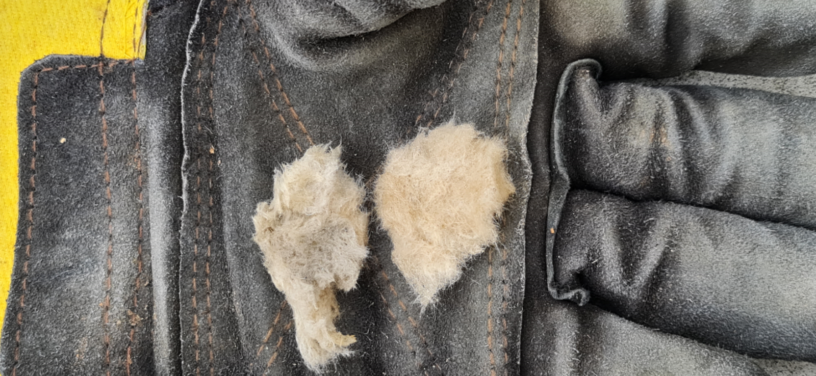

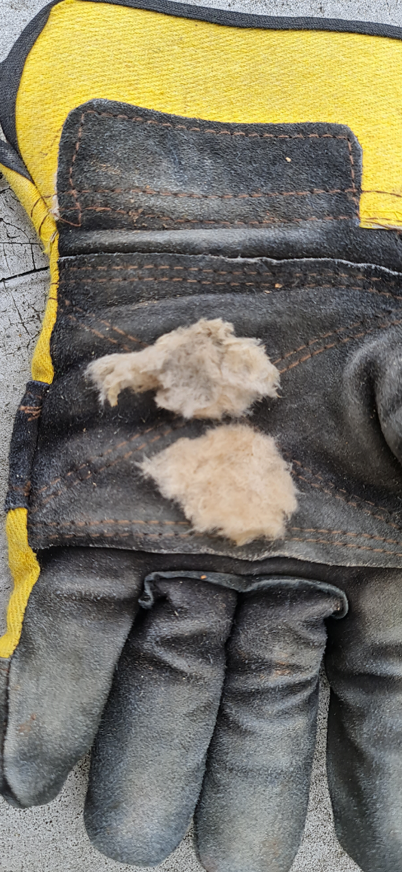

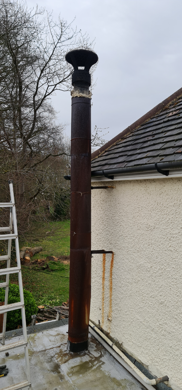

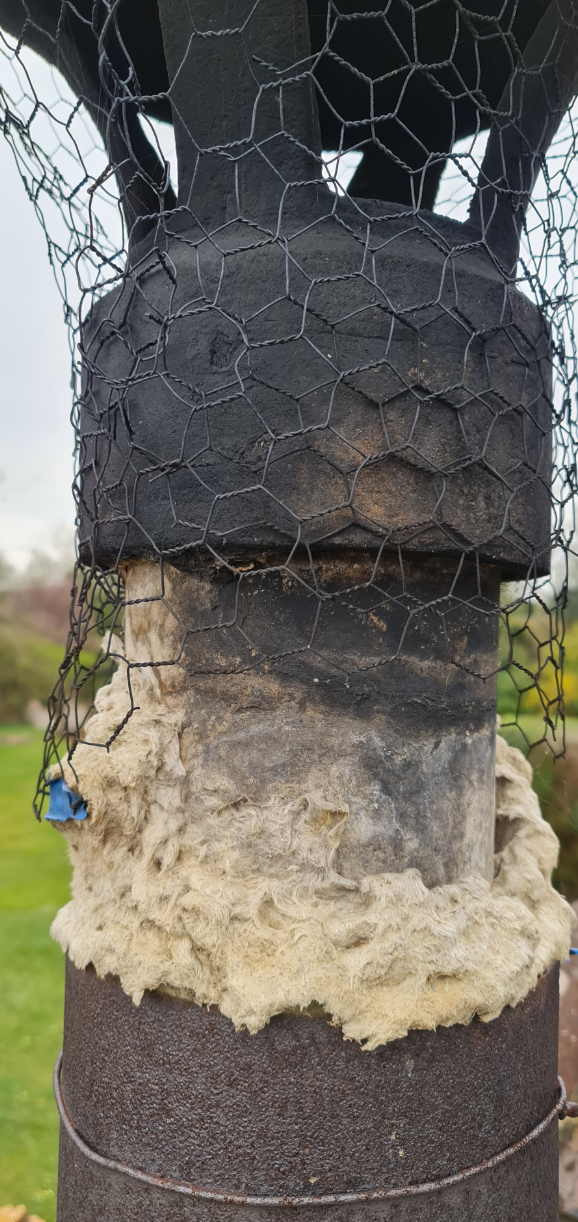

I'm intending to remove a chimney (installation date unknown). I know that the inner chinmney is asbestos cement tubes and that the outer shell of the chimney is a rusty steel. However,, the insullation between the two walls is not something that I feel able to identify. It looks like fibre glass-type insulation but I am concerned that it may be something much more toxic.
Any advice would be most welcome
Regards
Tet
I attach some pictures
If the inner flue is asbestos cement then there's every chance that the insulation is asbestos too and as it's fibre, it's the worst kind.
It's kinda shutting the door after the horse has bolted but do not touch or unsettle it without proper PPE.
It needs tested before anyone touches it again.
Update : I have had two quotes from local asbestos removal companies. One for 500 quid + VAT,, the other for 600 + VAT.
Both have said that the fibrous insulation is NOT asbestos.
I am now considering self-removal with extreme PPE - no decision made yet, though
Good stuff, take it they have tested it, I'd never take the chance to presume it isn't. Asbestos can be removed DIY if it meets certain criteria so suggest a check to see if the work falls under the notifiable non licensed category or not. As mentioned use the correct PPE, follow the correct procedure to remove (not so bad as you aren't inside), use the correct handling and bagging procedures and dispose of at a properly licensed site.
How do they know it is non -asbestos ? do you have the lab report, please dont mess around with this stuff, it is the worst thing you can do , I hate to say it but if you have a quote of £500 from a licenced company to remove it and dispose of it legally, then that is *******s, but it is only you and your families and your neighbours lives that you are messing with?

it could be amosite, no way of knowing without testing
you can get a kit -it costs about £25 -they send you a little bag which you collect a sample in and return it
