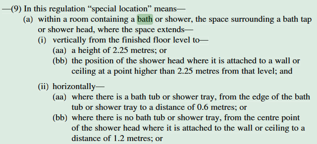

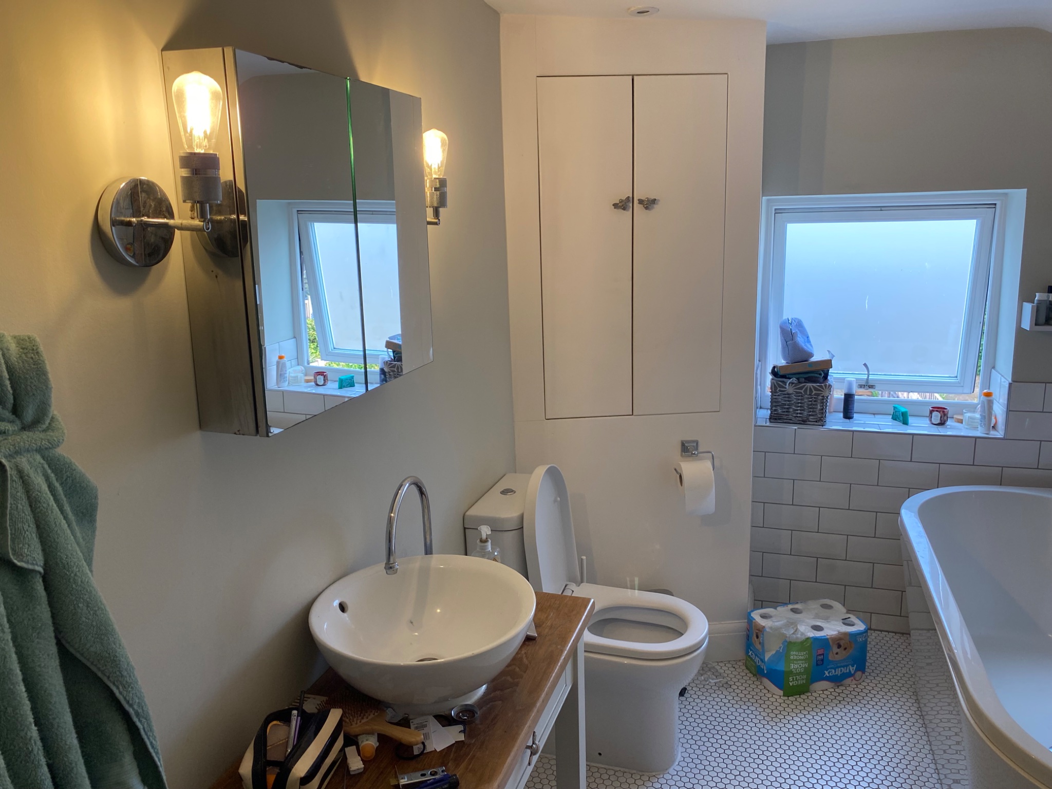

Hi,

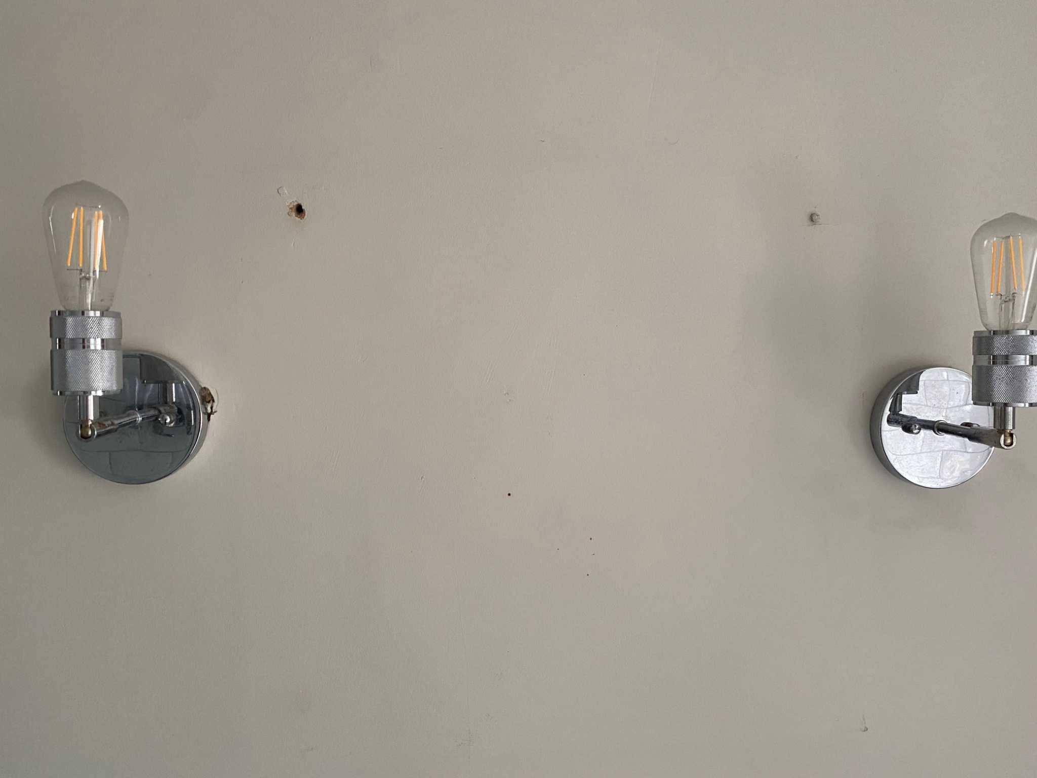

I’m looking to replace my bathroom cabinet between two lights with one of the ones that lights up via wired connection.
My understanding is that because it is more than 60cm from the shower or bath horiztonally this is not notifiable work. However, do controls apply to sinks?

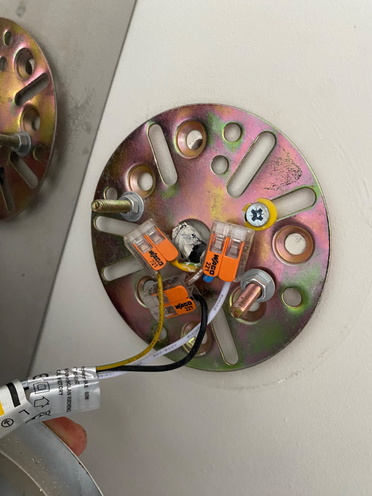

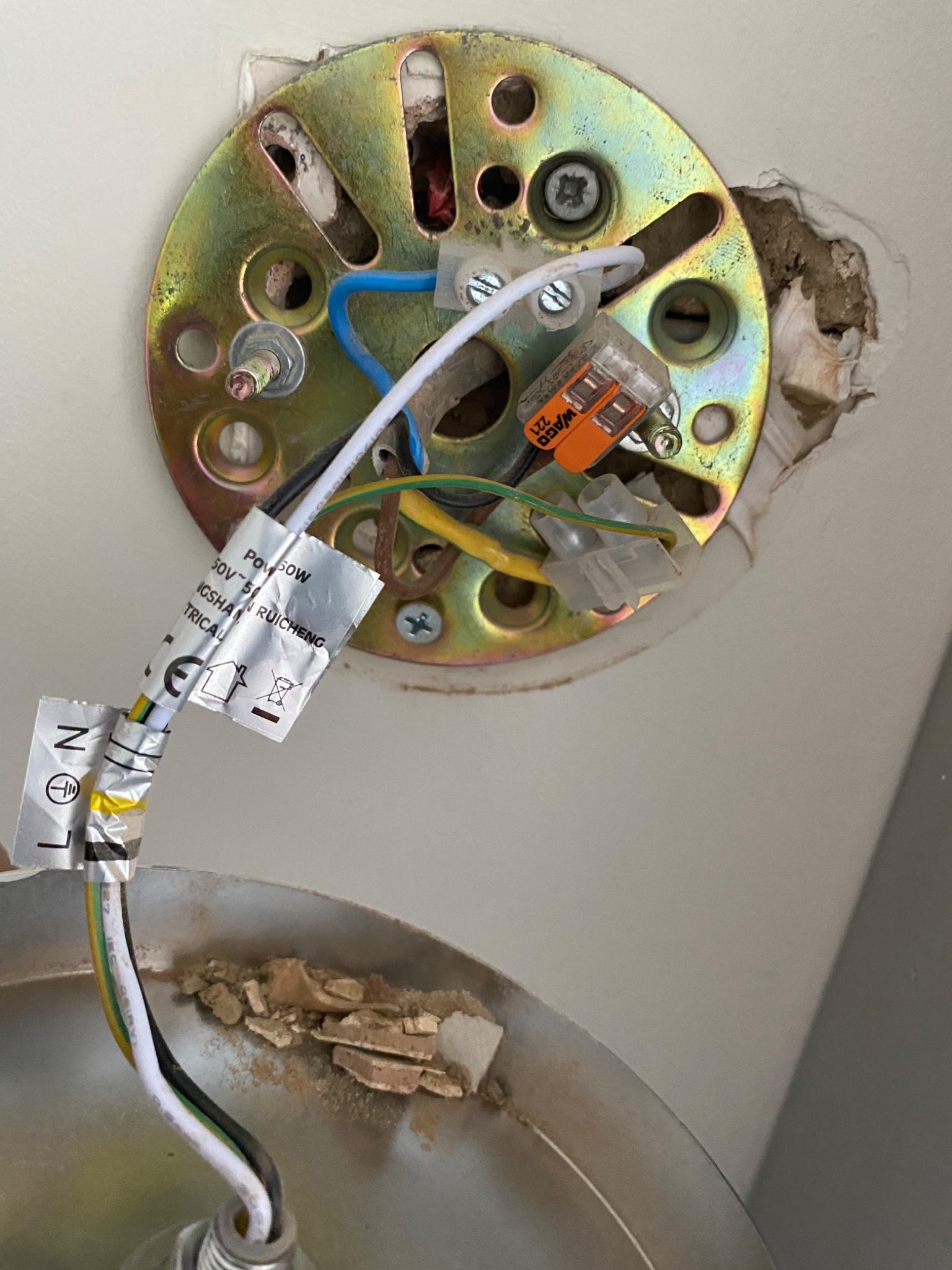

Also, the wall is brick. Without sounding stupid, I’ve not run a wire through brick before. Any good suggestions for how I can run a connection to the existing lights circuit, or will it be too difficult?
Thanks!
Correct.
No, and it's a basin anyway.
If you want to connect to one of the existing lights, a narrow slot will need to be cut into the plaster horizontally from one of the lights to behind the new cabinet.
Wide enough for the cable, and deep enough so that the cable will fit into it and filler/plaster can be added over it.
Circuit will need to have RCD protection.
