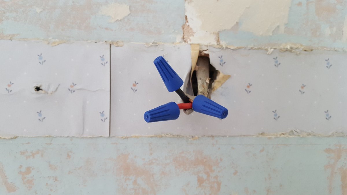

Just removed an old pull switch light and capped off the 3 wires. Will tape together with electrical tape. Is this ok? Thanks.

Not if the cable is still live.
If it is still live, you need to work out where it goes to, and disconnect it there.
Can you get access above?
If you can't do any of the above two things, maybe you could bash a hole in the ceiling (only if hollow though), locate the cable, and fit an enclosed 20amp junction box on the cable.
It is probably fed from a hidden junction box or ceiling rose somewhere, the safest way is to disconnect it there. There may be a screw down flap in the upstairs floorboards in the case of a ground floor light junction box, or simply mounted in the loft space on a first floor lighting circuit.

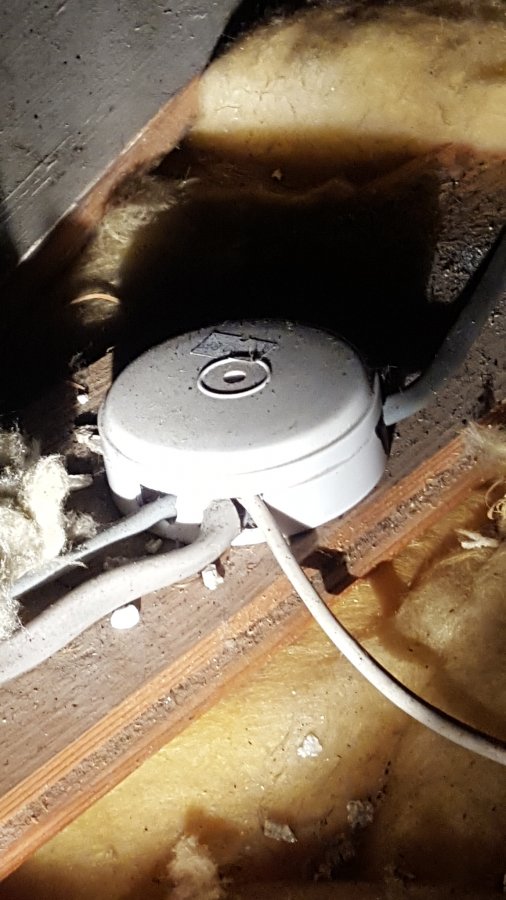

It goes into this
... it's the bigger middle cable.

Looks easy enough to disconnect it. If you don't, there's a risk that you or someone else might in the future put a nail or screw through that cable while hanging a picture or a cupboard. Remove the cable if you can, but you must at least disconnect it from that junction box.
The rule book says to be considered as safe zones there must be something to show where a cable is likely feeding so while there is a lamp, switch, socket or FCU at the end of the cable it is in a safe zone, as soon as the item it feeds is removed then it loses it's safe zone status so needs removing or making dead.
Also with a junction box as shown there is no cable retainer built into the box so all cables need cleats outside the box to retain them. Adding cables which are not fixed to the woodwork in some way is not permitted with that type of junction box.
Thanks for replies. Its all existing cabling from when i moved in. It was a 70s wall light which i am completely removing. I did buy a wall plate to put on top. So to remove the cable, does that box unscrew, remove cable and voila?
