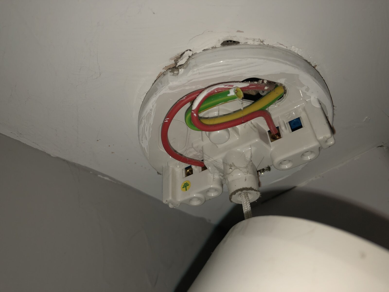

My pull down light switch cord thing in the bathroom stopped working so I unscrewed the top bit on the ceiling and got it working again.
However, on inspection, I notice the earth is not connected. Any idea why that may be?
And am I Ok to secure the earth into its correct place in the holder?
Thanks all.

It's not right, but it's ok.
If it doesn't reach the earth terminal, you could terminate it in a piece of small terminal block.
Thanks everyone. Glad to know it's alright.
When I get a chance I'l see if I can wire it back in.
