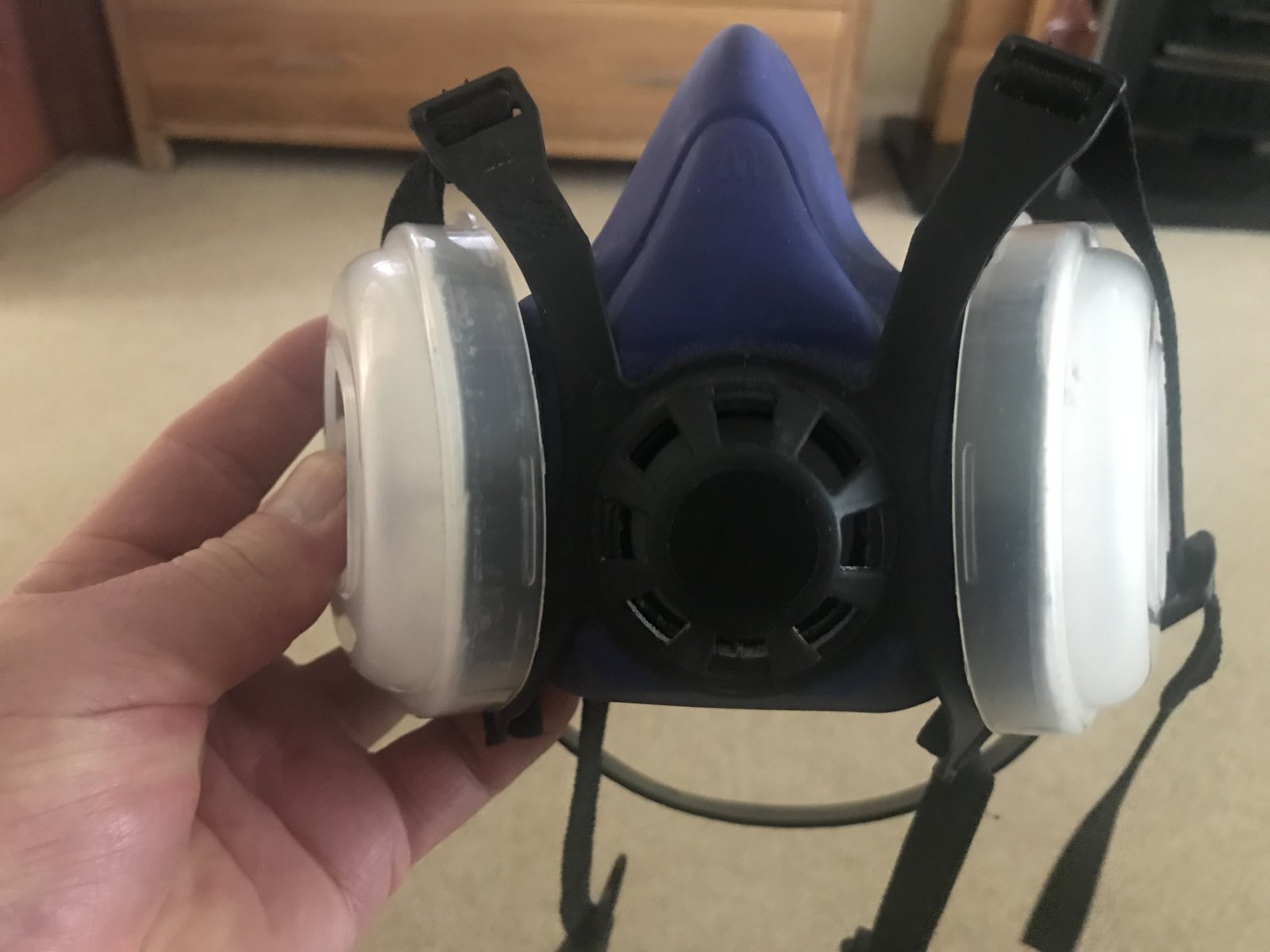

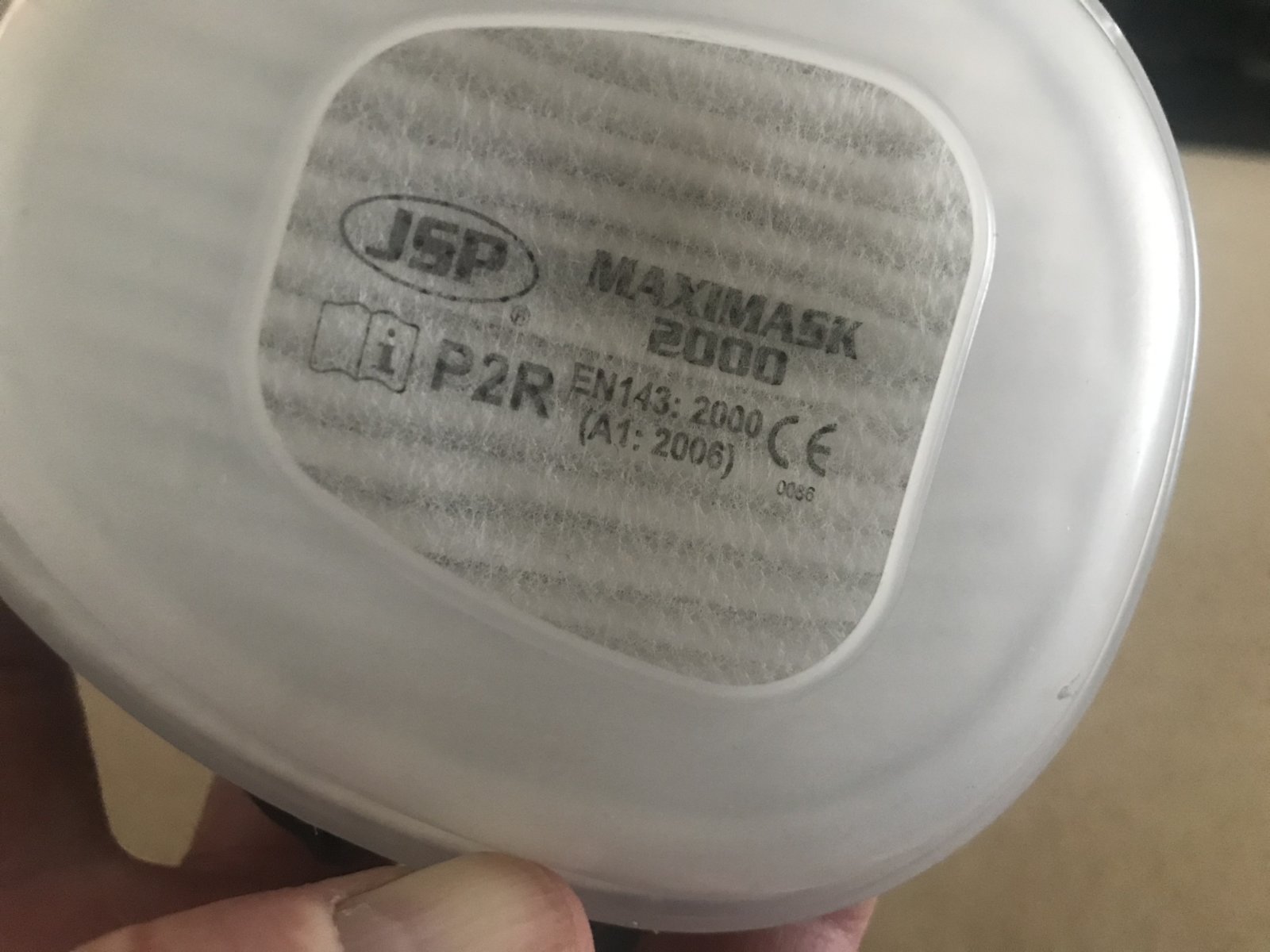

I brought this home from work - I think I used it once when I was putting insulation between my roof joists in my workshop prior to plaster boarding. I've tried looking up and I can’t find if 'P2R' is the same as 'FFP2'. I suppose it’s better than nothing but it is a lot easier to wear than other dust type masks as it has ventilation valves so the filter material doesn’t get wet with condensation from exhaled breath. If I put my hands over the side filters, it shuts off completely so it has a very good face seal. Any ideas whether it a good one?

This is a good read here i do believe P2R-FFP2 same a bit more info on the differences but yes P3R FFP3 is whats needed., i had it drilled into me to lockout the ventilators (press the cartridges in) and try to inhale to check you have an airtight seal on the mask or of course it renders it all useless.
http://phoenix-safety.co.uk/4 Respiratory_34-63pp.pdf
Anything that prevents you from coming into contact with exhaled spray has to be a good thing, and that mask looks better than most.

I have something very similar with P3, have not used them yet in the supermarket but may at some point. (still the risk of infection through eyes)
My question would be how to disinfect them between use. (I don't have any spare filters and they are not available)
The filters pop out so the rubbery mask itself would be easy to clean, but what would be the best thing to do with the paper filters? As I would only be going to the supermarket every days, would leaving the paper filters in the airing cupboard (very dry environment) be enough to kill any C19 virus on the filter?
