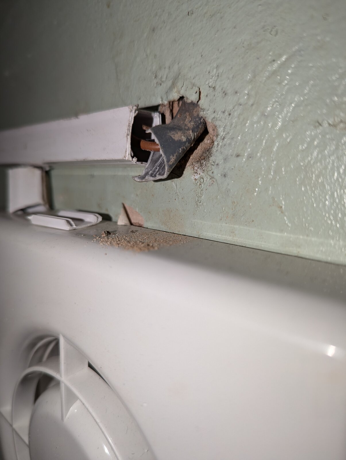

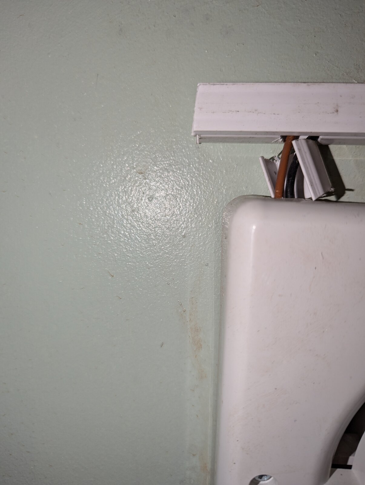

My mum had someone install an extractor fan as part of an ECO scheme
From a safety and legal perspective are there any things of concern from the attached photos, and if so can someone please explain why, as this will be used as part of an official complaint

I would just say that the whole cable including the grey sheath should go into the fan.

I bet there's even wires jointed in that trunking.

Can't quite tell from the pics but is that 3c&e to the fan with brown and black only used in the trunking or do all the cores go to the fan?
The ridges on the inside of the sheath look like it might be 3c&e but have the grey and earth been cut back?

I see a couple of things in that picture that violate BS7671.
1. The inner insulation of the cable cores is exposed, this would generally be considered a "C2" ("potential danger") on an EICR. It is acceptable to run "single insulated" cores in trunking but if you do then much greater care has to be taken in constructing the trunking system than if sheathed cables are used.
2. There doesn't appear to be an earth wire taken to the equipment, I think I can just about see a bare earth wire entering the trunking, but I don't see one in the section with a missing lid that runs down to the fan. For a class 2 appliance, this would generally only be considered an "observation" on an EICR.
Now BS7671 is not law, but it is the accepted standard for electrical work in the UK.
Also you don't normally see cables with just brown, black and earth. So that suggests there is a grey wire somewhere. Wires really should be terminated in a suitable enclosure not just cut short or burried in the wall.
